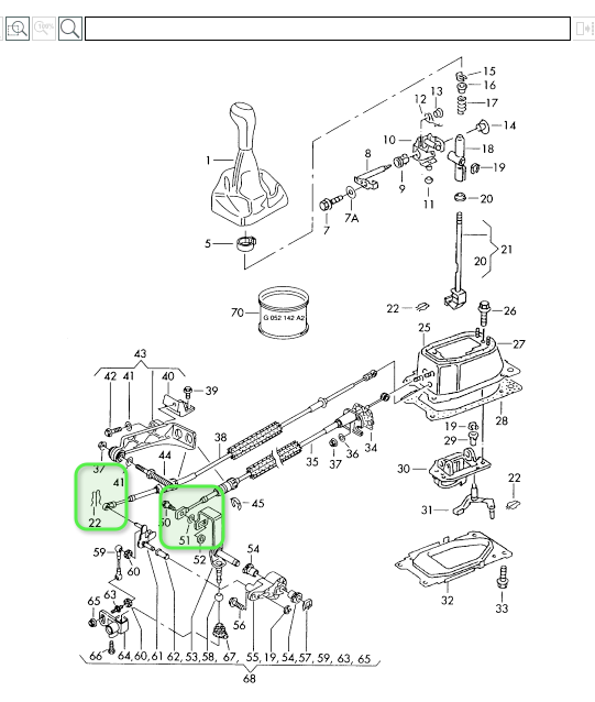

Heres a picture from the parts system. The ends highlighted in green wear down. The only answer is to replace the shift cables, though sometimes, you can stick a couple of cable ties on to take up the flex and stop them moving making it a more positive gear change

Understood, thank you. I'm no mechanic by any stretch of the imagination however I can follow that image and combined with the Haynes manual I can give it a go.

You don’t want to adjust the travel on the selector mechanism. That’s a quick way to throw it and lose your gears completely.
Give it a go with the cable ties, if that doesn’t work seek out a good independent mechanic
