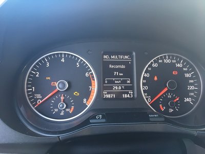

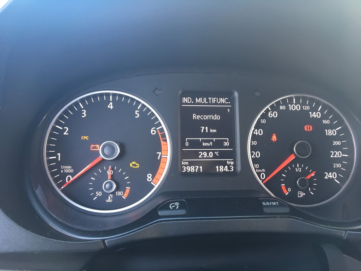

Please, show us some pictures of the dashboard, steering wheel, buttons, stalks, etc ... I would like to check something that is related to the BCM coding. When possible (there is no hurry). Thanks in advance.

Of course ciclo. When I reach home I'll post those pics. My car has a pretty nice interior.ciclo wrote:It's a somewhat higher level but your BCM Max is good.EdgardoRodriguez wrote: ↑Fri Mar 23, 2018 8:30 pm Do you have the same BCM module or a higher level one?

Tomorrow I promise a few more!ciclo wrote: ↑Fri Mar 23, 2018 9:54 pmIt's a somewhat higher level but your BCM Max is good.EdgardoRodriguez wrote: ↑Fri Mar 23, 2018 8:30 pm Do you have the same BCM module or a higher level one?

Re: ciclo's Polo. R-line 1.2 TSI 90hp 119gr.
ciclo wrote:Thanks for this information, everything is clear to me, it helps me to know the level of knowledge you have about the VCDS and other things. You need to learn many things that I'll explain to you, but I'll explain them to you in Spanish (by email) when you get the 10 messages in the forum, meanwhile we continue to know more about your nice Suricata ...
Now, I have 12 wiring installation processes open and I find it difficult to explain so many things in a short time to everyone.
Byte17 Bit0 enabled, activates the indirect TPMS in modules ESP9.0i front H03 0003 , yours is ESP9.0i front H03 0001.
F1DC948D212313C68F1B29698458C8400901
Try it. (with the right parts installed)
Forget the battery module if you don't have it installed in you Suran.
Menu options "comfort" and "luces y visib." Where enabled by me
