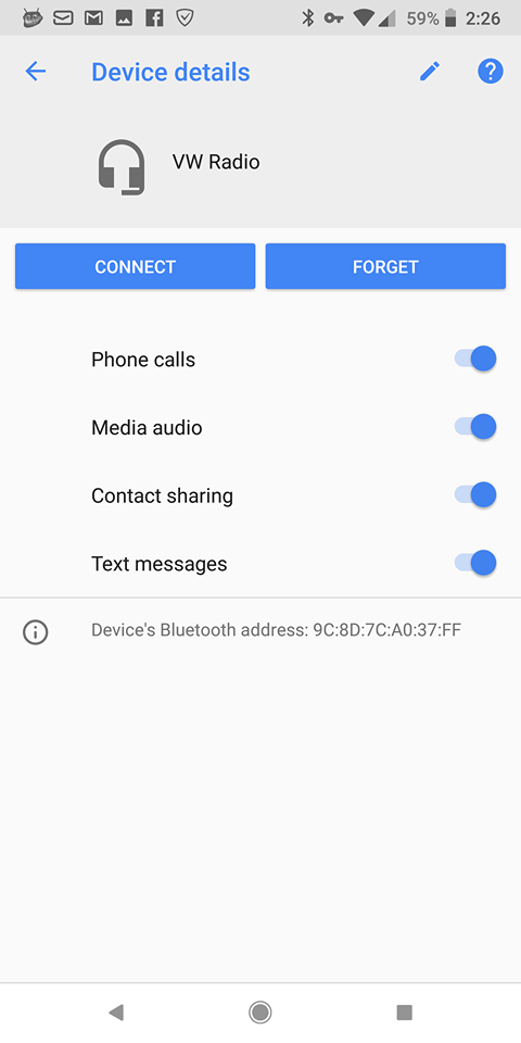

- gaza1994
- Posts: 150
- Joined: Thu Mar 16, 2017 1:39 pm
- Drives: Match 1.4 2012 (6r) (85ps)
- Location: Scottish Borders
Re: Bluetooth / Mobile phone query.
if you go into your phones bluetooth settings, are all the boxes ticked on here?
If thats the case and it doesnt work try the following:
* Tell the cars bluetooth to "forget" your phone
* Tell your phone to "forget" your car
Restart both
then try going through the setup process, see if that helps.
Restart both
Many thanks for your response Gaza 1994
My Samsung C3050 does not show a window as you have illustrated (I cannot find device details anywhere).
When I highlight the VW entry, and drop down the 'options' - the only near thing is the ability to 'connect'
I believe I can find (on the car) an entry to erase the phone entry, but despite a search I cannot find (on the Phone) the entry to forget the car.
I am tempted to go to square one and start all over again OR borrow an alternate phone and see if that overcomes the problem.
Thanks again for your time.
Keep the ideas coming chaps
