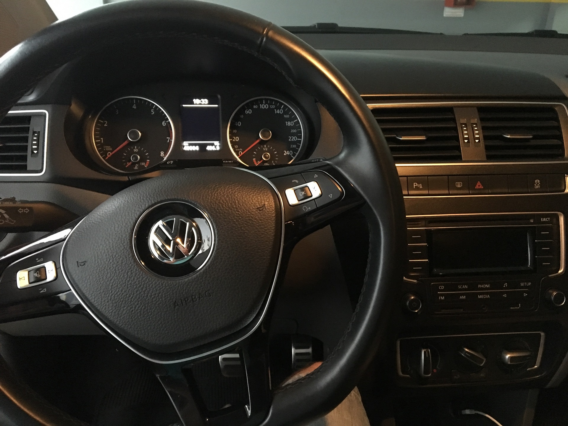

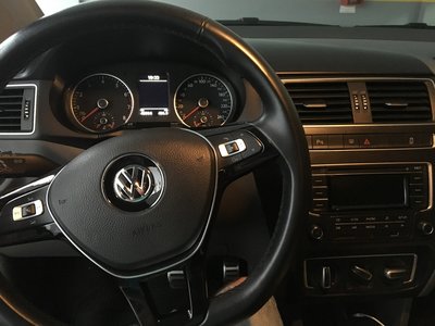

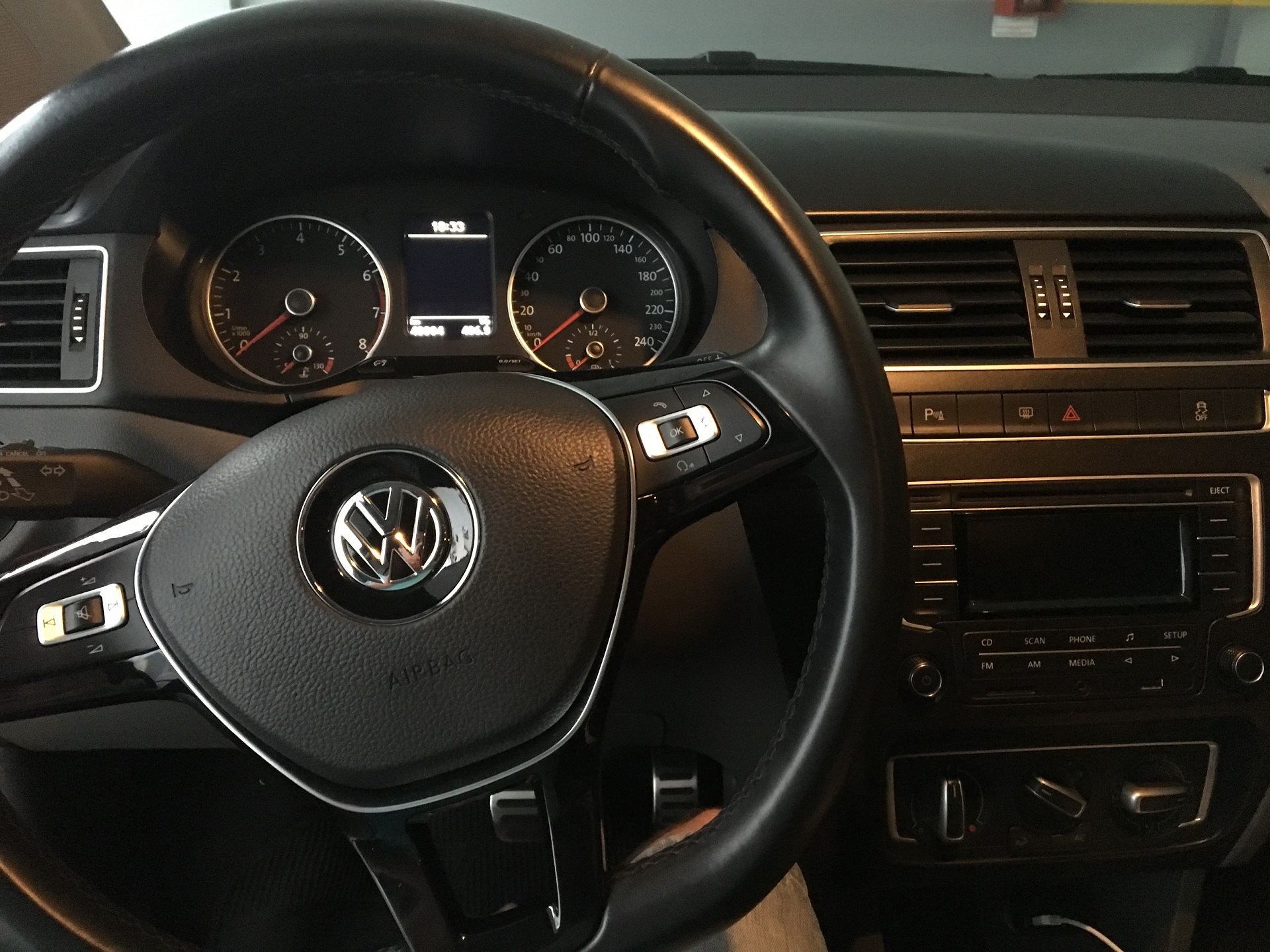

hey can you post an image of whole dash (with steering controls) when lights are turned on?

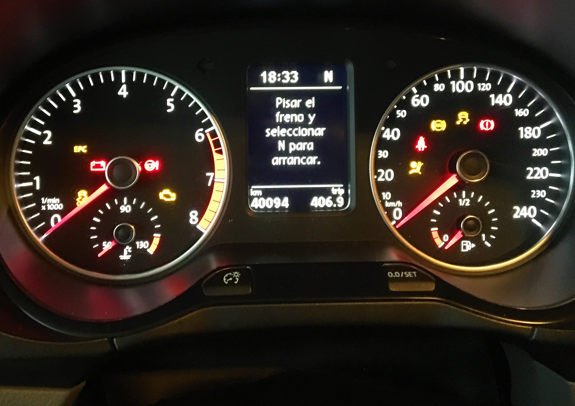

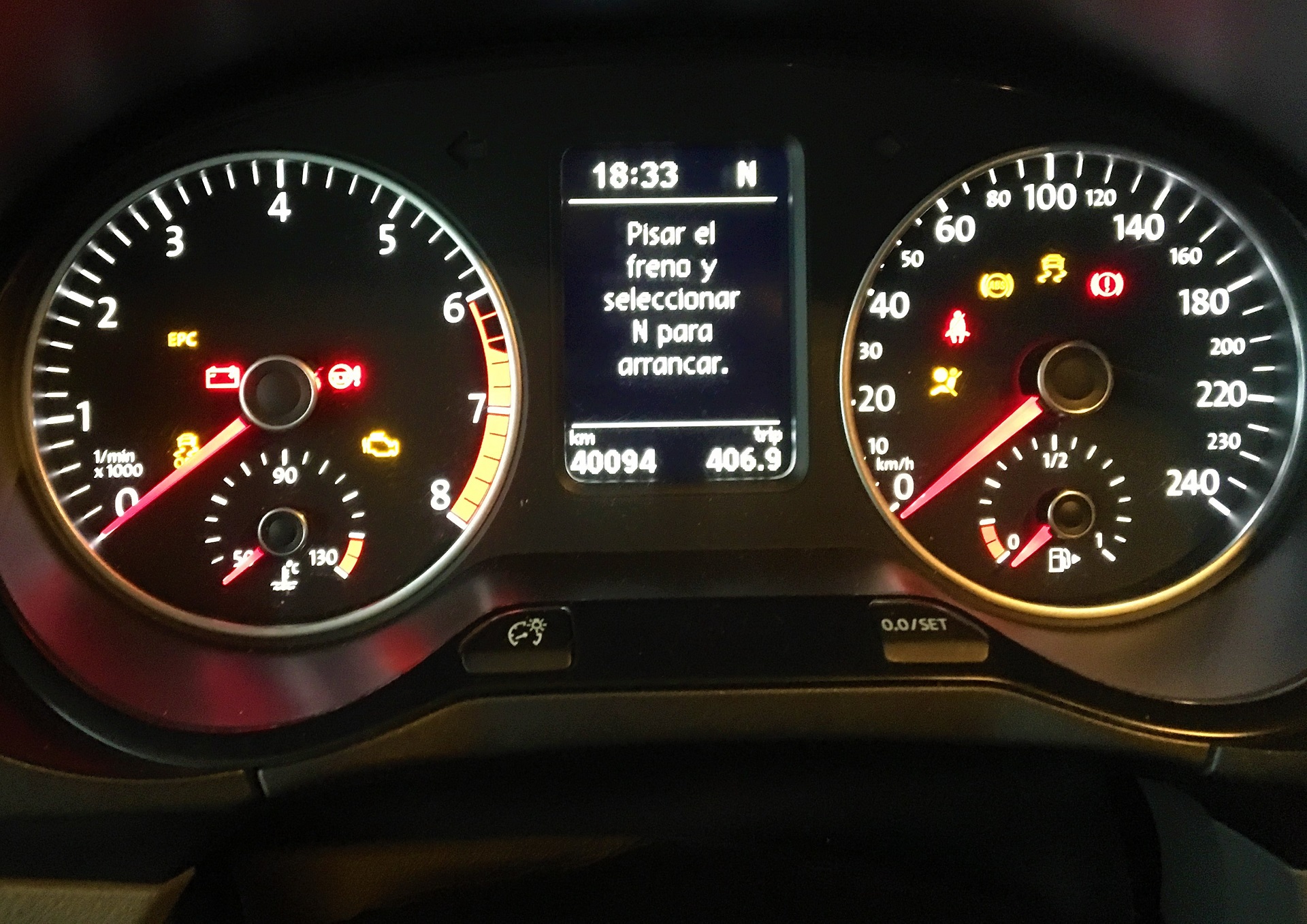

Done some ic EEPROM edits
Enabled so far:
Volume to be replenished
Staging
Real coolant temperature on gauge
Thanks to many info provided at Russian forums
Enviado desde mi iPhone utilizando Tapatalk

ag69 wrote:hey can you post an image of whole dash (with steering controls) when lights are turned on?
Sorry for the delay, here you are!!
