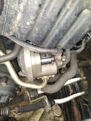

Ran the engine today 1.2 3 cylinder,and i have a sound which is like lots of small ball bearings,coming from the rrear of the cylinder head on the right side below the rocker cover as you look under the bonnet.You can only just hear it but quite loud when you take a closer look.It has a aprox 3" plastic cap with some pipes and is bolted to the head,a electric connector which is pointing to the winscreen.I have looked in the Haynes manual but could not see it illustrated.I have had the engine running on idle before but never have noticed this before.Thought it could be the fuel pump but not sure.Anybody know what this component is, the car runs fine and idles ok

I think i have found out what it could be the EGR valve or throttle body,but is it supose to rattle like lot of small ball bearings?

Please take a photo and post it up showing the part in question

That looks like the Throttle Body though it could be the EGR and no it should not rattle

Apparently that is the throttle housing and the EGR is on the right front of engine .I have booked it in for a Diagnastic (has not had a full blown diag for few years)to find out why it is running bit rough on idle ,took air cleaner off and it was clean (suprised) so have to see what comes up in the test.The egr in the front might need cleaning so will wait for the test results.

Hum, now that you have said "throttle body" I can see that it is exactly that, prior to that I was thinking "that is not the EGR valve" - but no more than that.
