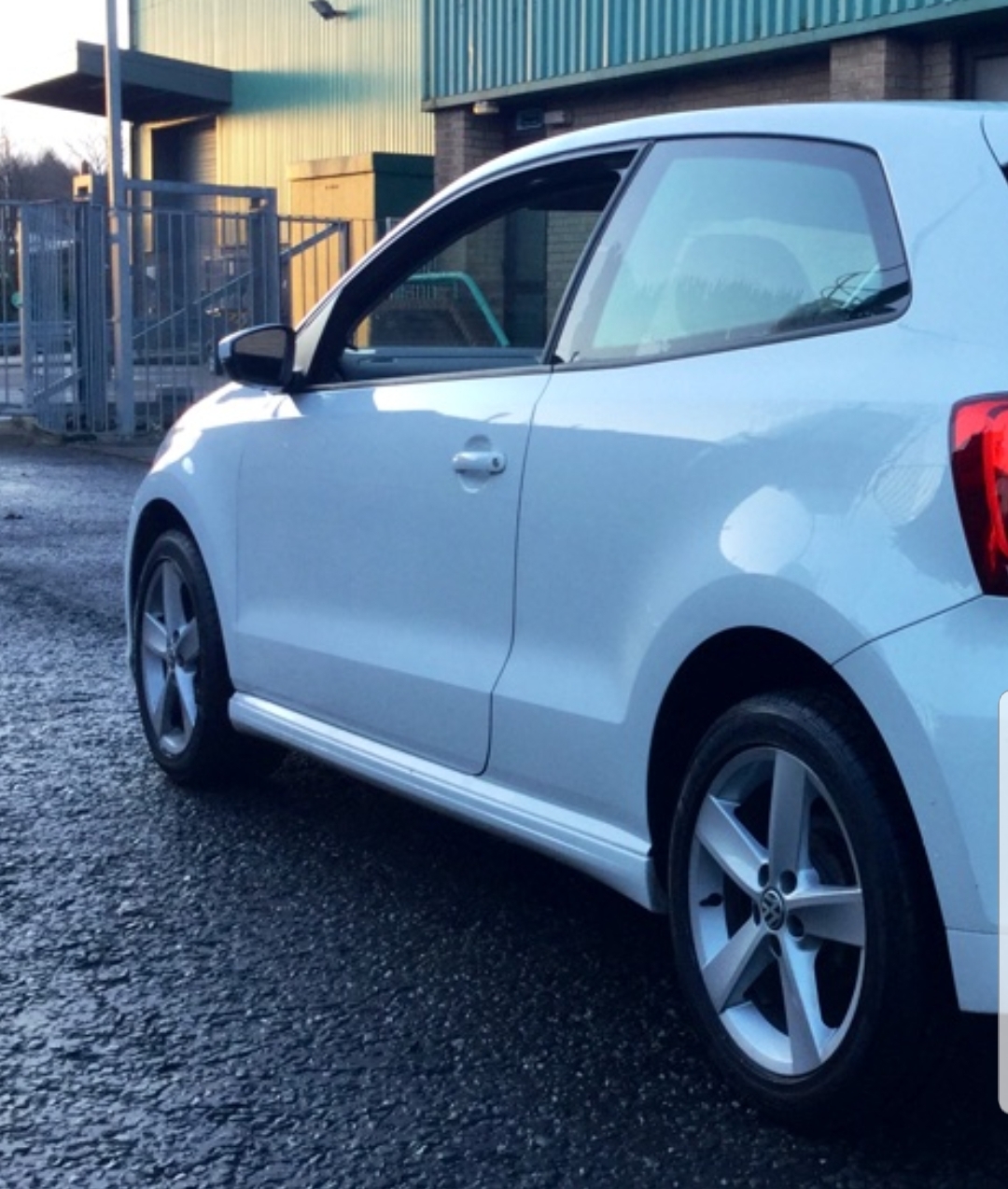

I have a 64 plate 2014 1.2 tsi sel 3 door, question is can I upgrade the factory fitted side skirts? I'm not wanting to lower them and have a unbalanced look with the front and rear just wondered if the r line ones for example will fit?
