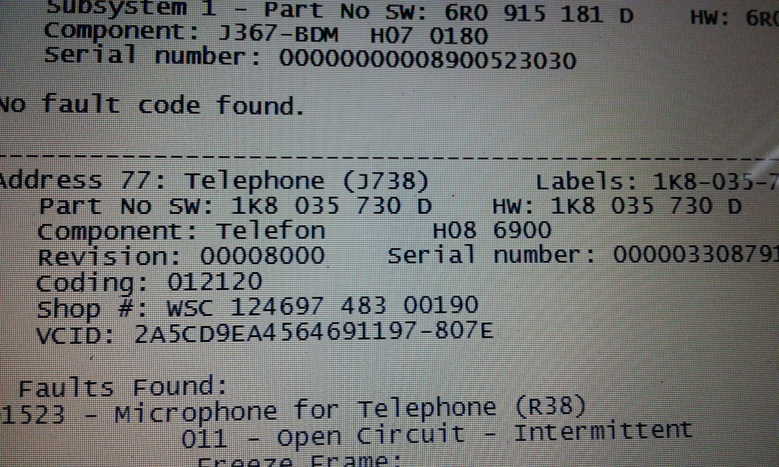

i have made it. but can not bring it to my other computer. are pix good to?

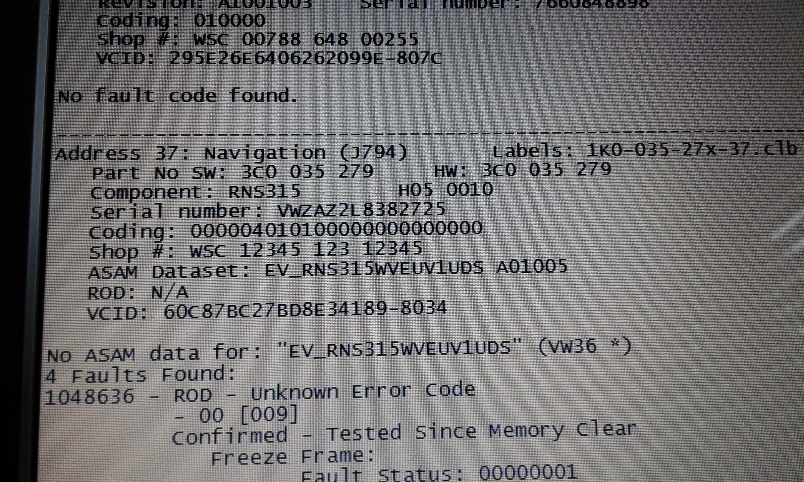

Address 37: Navigation (J794) Labels: 1K0-035-27x-37.clb
Part No SW: 3C0 035 279 HW: 3C0 035 279
Component: RNS315 H05 0010
Serial number: VWZAZ2L8382725
Coding: 000004010100000000000000
Shop #: WSC 12345 123 12345
ASAM Dataset: EV_NRS315VWEUV1UDS A01005
ROD: N/A
VCID: 60C87BC27BD8E34189-8034
No ASAM data for: "EV_NRS315VWEUV1UDS" (VW36 *)

Address 77: Telephone
Cannot be reached

@iichiel if i put 77 off. the fold is gone in my gateway. is this what you mean?
als ik m uitzet is mijn foutmelding weg! is dat wat je bedoelde?

I honestly don't know what's going on. You have some interesting errors in the RNS module, that are flagged as unknown.
Probably has something to do with your clone VCDS.
Summary: no clue... sorry mate.
I don't know what these mean, maybe they have something to do with your problem. Or something went wrong in hacking your cluster and converting a Fabia cluster to Polo FW.Address 37: Navigation (J794) Labels: 1K0-035-27x-37.clb

1048659 - ROD - Unknown Error Code
- 00 [009]
Fault Status: 00000001
Fault Priority: 6
Fault Frequency: 1
Reset counter: 136
Mileage: 147799 km
Date: 2018.06.19
Time: 19:26:54

thanks for your time. realy nice for looking for me.
so i must live with it. no other option.
thnx iichiel
thnx iichiel

What BT unit do you have?

Re: telphone menu polo 6r
Hello good evening. It's still not working. But i have a bluetooth module and cable now. But i installed it in my car but still not working. Can somebody give me the good code for installation .. the coding in the pix is my coding now. Thnx for looking and maybe helping
