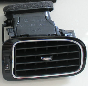

Has anyone got a boost guage if so what type id like one that is on the air vent like the mk7 golfs are the airvents for the golf tge same as the polo

Air vents are not the same for Golf and Polo (though the mk6 Golf have a similar design to the Polo 6R 6C).
There are not many model-specific options for the Polo. I have not seen any digital ones. You can however get holders for the driver's side air vent for a 52mm gauge for the Polo:
LHD: https://www.ebay.com/itm/VW-Polo-6R-52m ... SwPK1ZQuXe
RHD: https://www.ebay.com/itm/VW-Polo-6R-UK- ... Sw-ldZX9rR
I bought one of those holders for mine, together with a NewSouth Performance boost gauge. However pulling a boost line through the firewall on the 6R is a pain, at least on the LHD (unless you feel comfortable with drilling a new hole through the firewall). That's why I still haven't managed to install it.

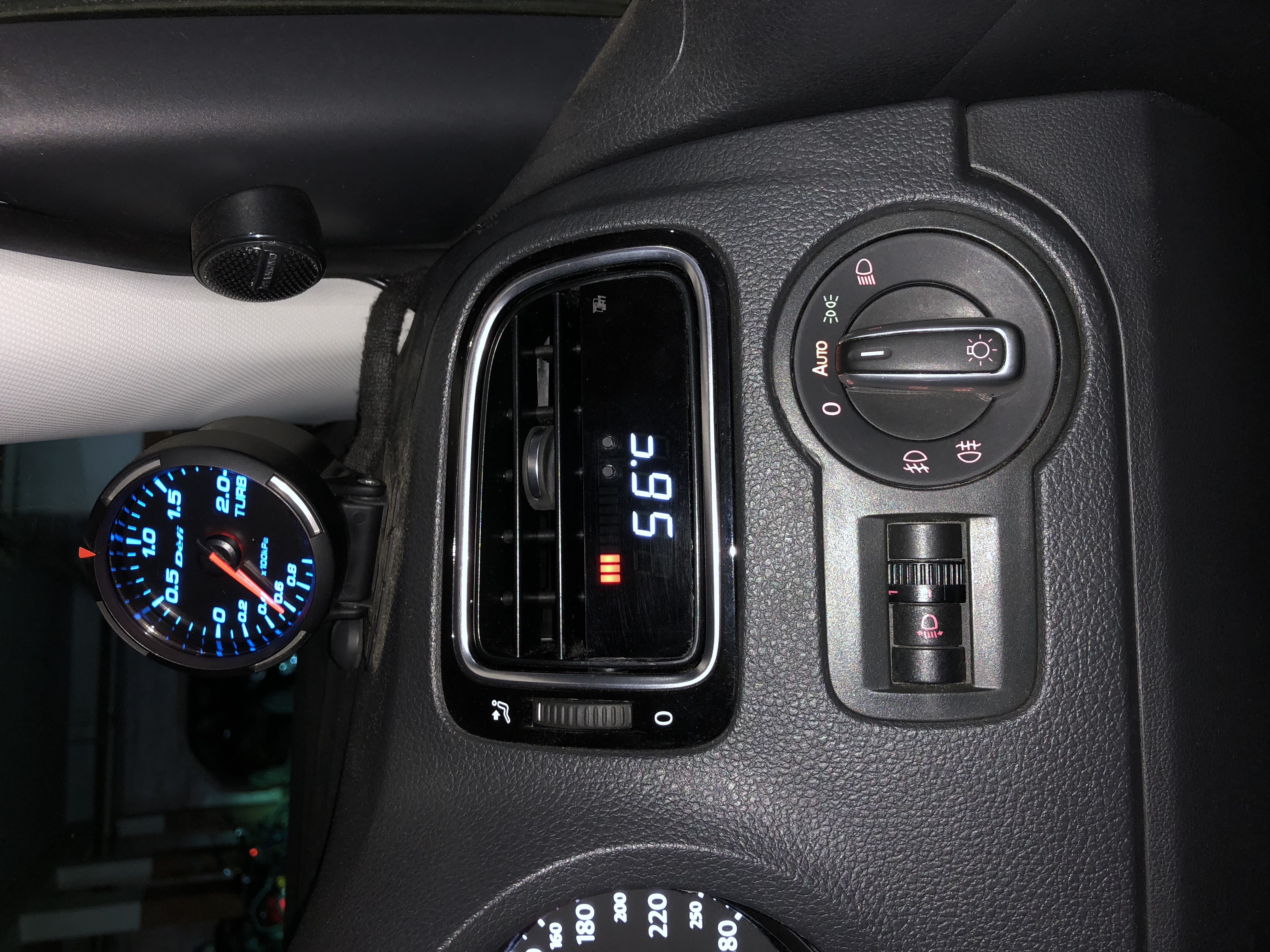

I've got both, a DEFI boost gauge and a P3 gauges vent gauge installed on my 1.2 TSI.
The DEFI has its own sensor that you install in the engine bay and use a boost tap to plumb it. If you have a Forge Motorsports BOV, you could just T off its hose.
The P3 vent gauge comes in 2 models, a boost gauge and an OBD must gauge. If you buy the boost gauge, you get a similar boost sensor that you plumb like the definition. If you go for the OBD multi gauge, you can use both a sensor or without it. The multi gauge shows you the boost that the ECU sees. It also is capable of Coolant Temp, Intake Air Temp, Exhaust Gas Temp, Throttle position, Vehicle Speed, RPM, Shift-light, Battery voltage, 0-60 timer and AFR.
Installing the vent gauge on the Polo is a complex task. The vents on our car is removable as a whole unit but the fins on the front can't be removed individually like the golf. SO,a bit of cutting, grinding using a dermal and you can install the MK6 gauge on the polo. Bear in mind that the display also has to be modifies a bit (cutting, trimming) since the MK6 vent is longer. But overall, totally worth it.
Attaching pic of my setup.
https://youtu.be/BN7equbVPGg
P.S. If you have a piggyback chip tuner, you can reference your actual boost using the separate boost sensor and see the boost that the ECU sees using the OBD.

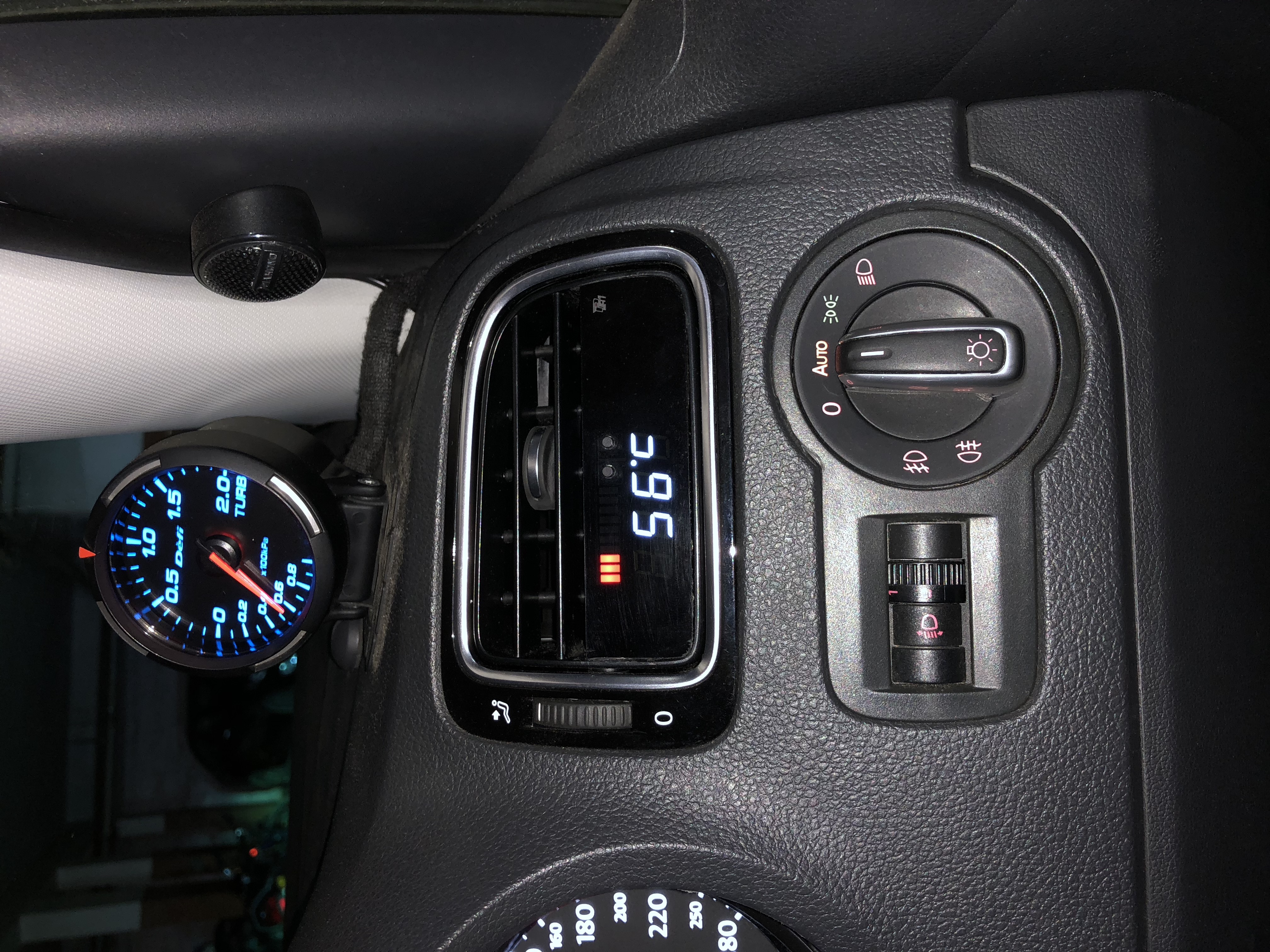

For reference, this is how my install looks (I finished it today):
In the engine bay I used a boost tap odered from http://www.all-stars-motorsport.com/. Using that one, I didn't have to modify any existing parts, just add the adapter between the intake manifold and the hose for the crankcase ventilation. If I want to restore it to factory, I don't even need tools.
