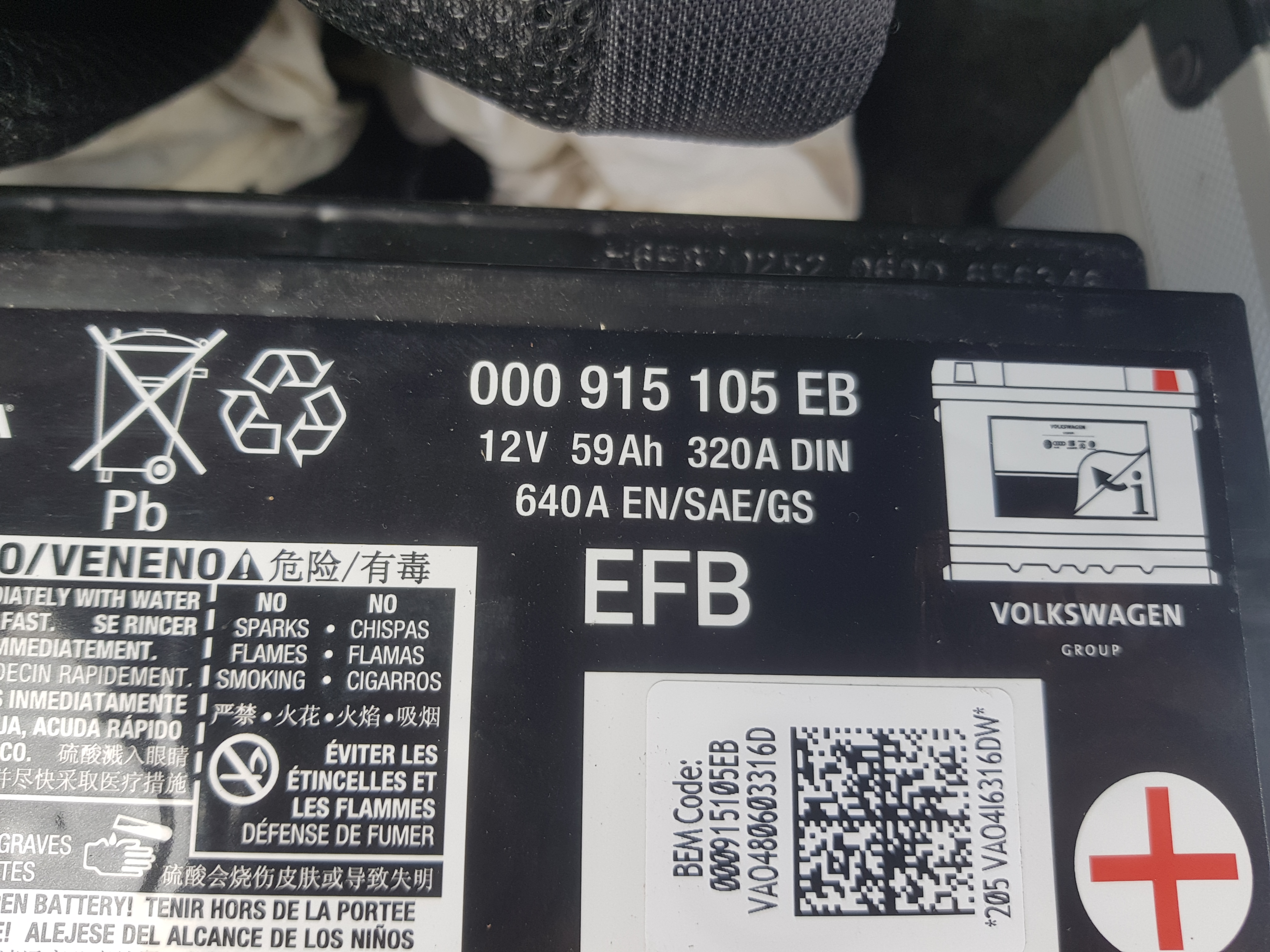

remember to tell your "61 battery monitor" module that you installed a new battery. I think it's somewhere in adaptation, you'll have to encode the new battery type (same as old) vendor, capacity and a few digits of the S/N.
a trick that a VW employee taught me, since you're probably changing to the same capacity and type, to simply change the last digit. i'm not sure what to think about it. it's clever, but could confuse later on.
Hey iichel, I just installed the new battery, but I can't find the Serial Number :/
VCDS tells me that it needs to be a 10 digit code...
Even when I look at an old vcds log to check on the old battery where the SN is, and I cannot find it haha
