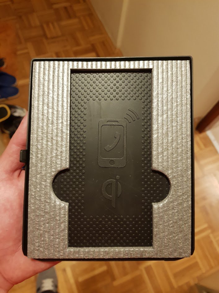

Who ever design the wireless charging pad for the AW1 sucks at his job. It's super flat and the rubber doesn't hold the phone in place. Since the phone needs to be centered on the pad, every time I go into the corner the phone would stop charging.
Maybe a bigger coil would resolve this issue but I'm not sure.
Simple solution to this was a bit of foam used for placing under laminated flooring. A scalpel and some patience.
Anyhoo, wanted to share :)
