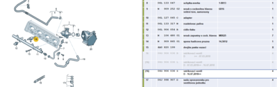

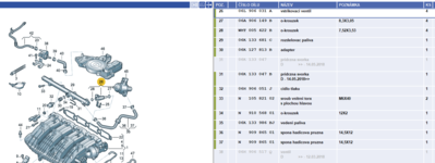

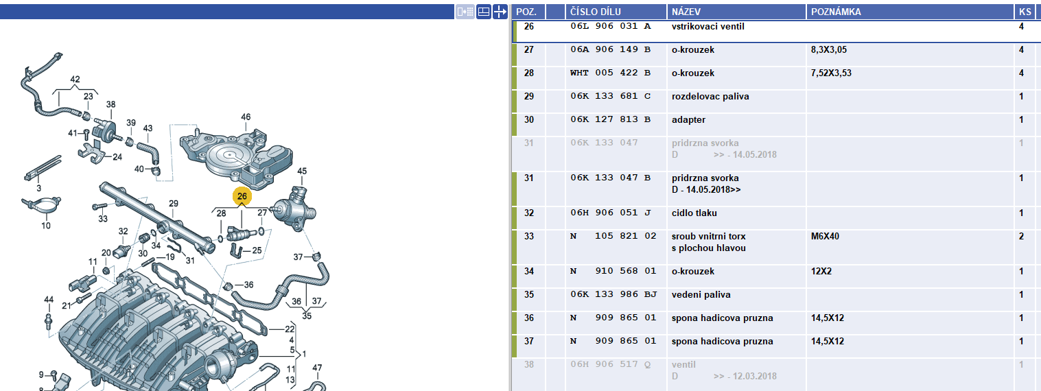

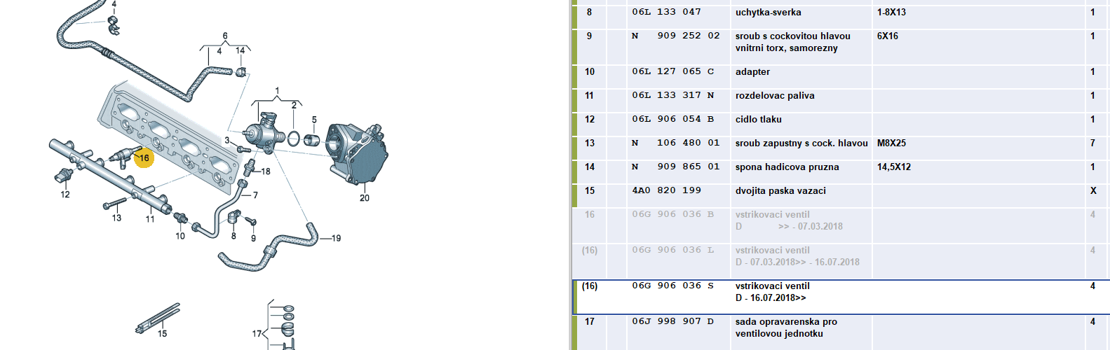

yep it is EA888 gen3 B - using diferent combustion cycle then gen 3. Also ETKA show using 2 diferent injectors (Part number: 06L906031A and 06G906036S).
Should be direct injector (nr. 16)
Should be port Injector (nr. 26)
