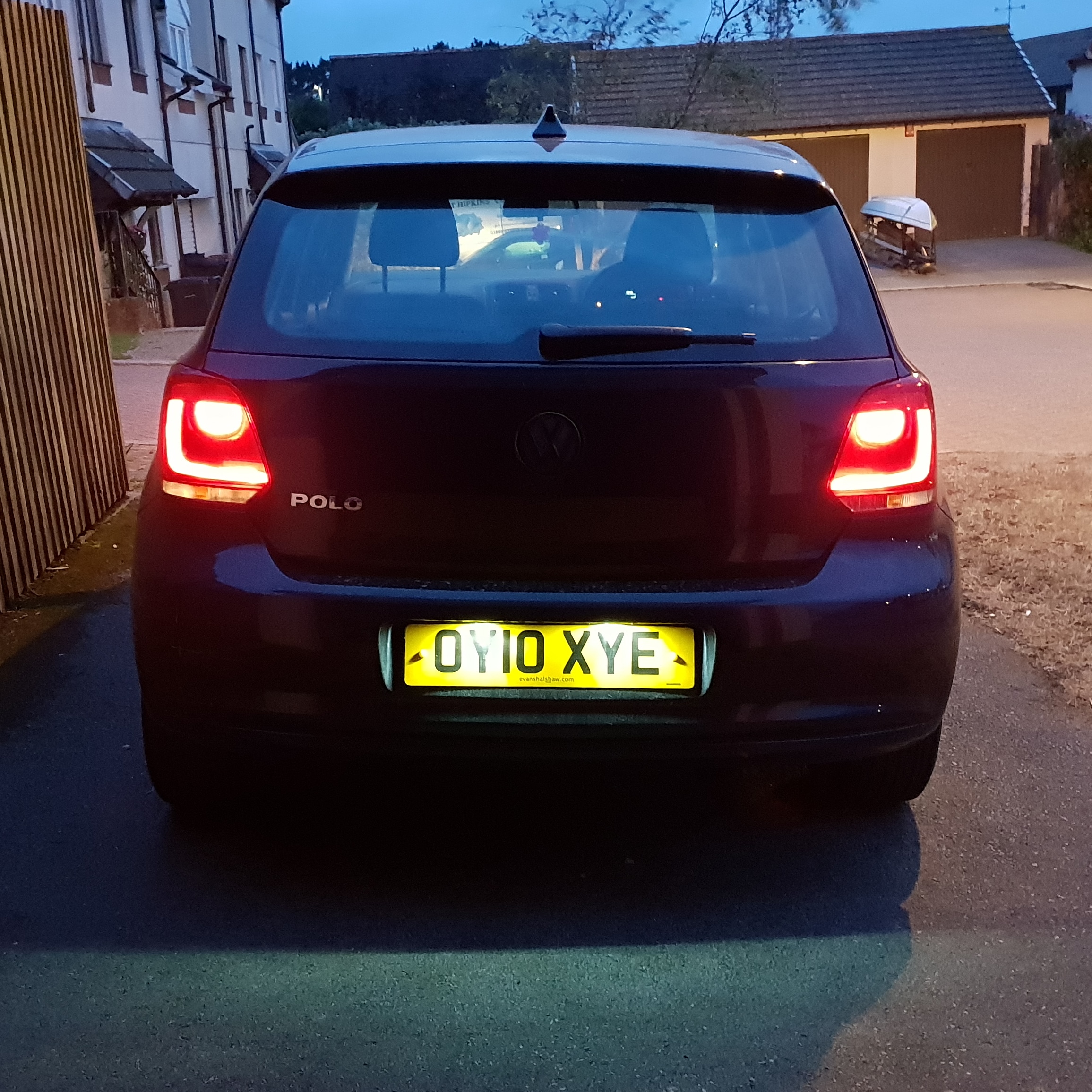

So has anyone done this? Is it just a straight swap? This is the rear of mine.
- Posts: 6693
Re: Polo 6r 2010 tail light to 6c tail lights
No, it's not a straight swap. Size-wise it will fit just fine. But you'll need a pair of adapters to make the connectors fit.

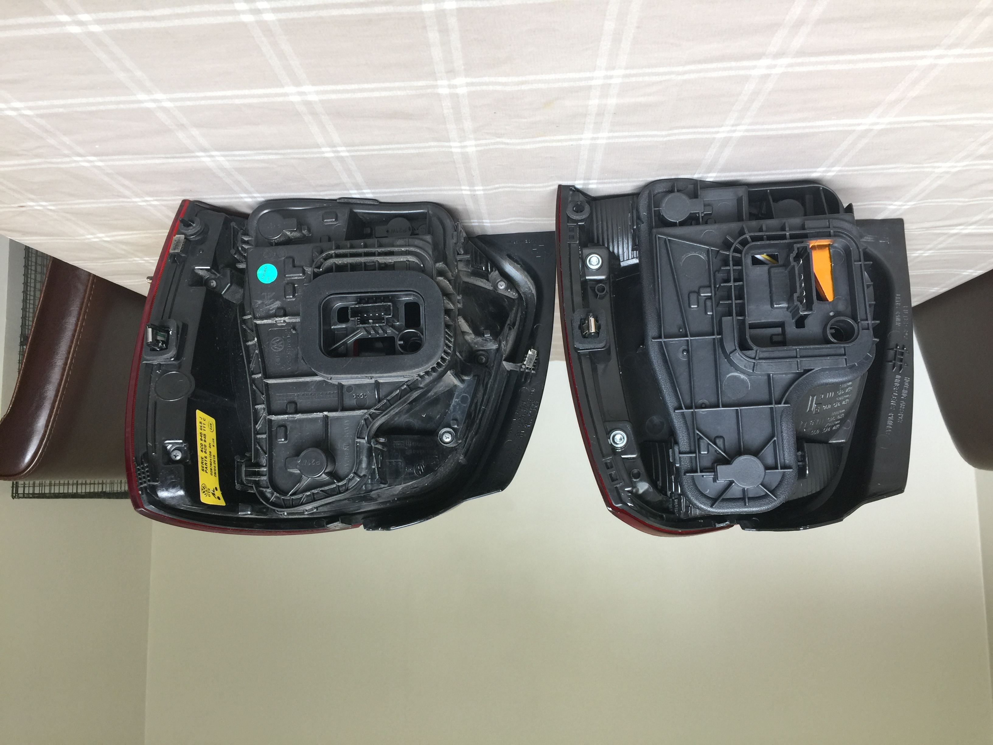

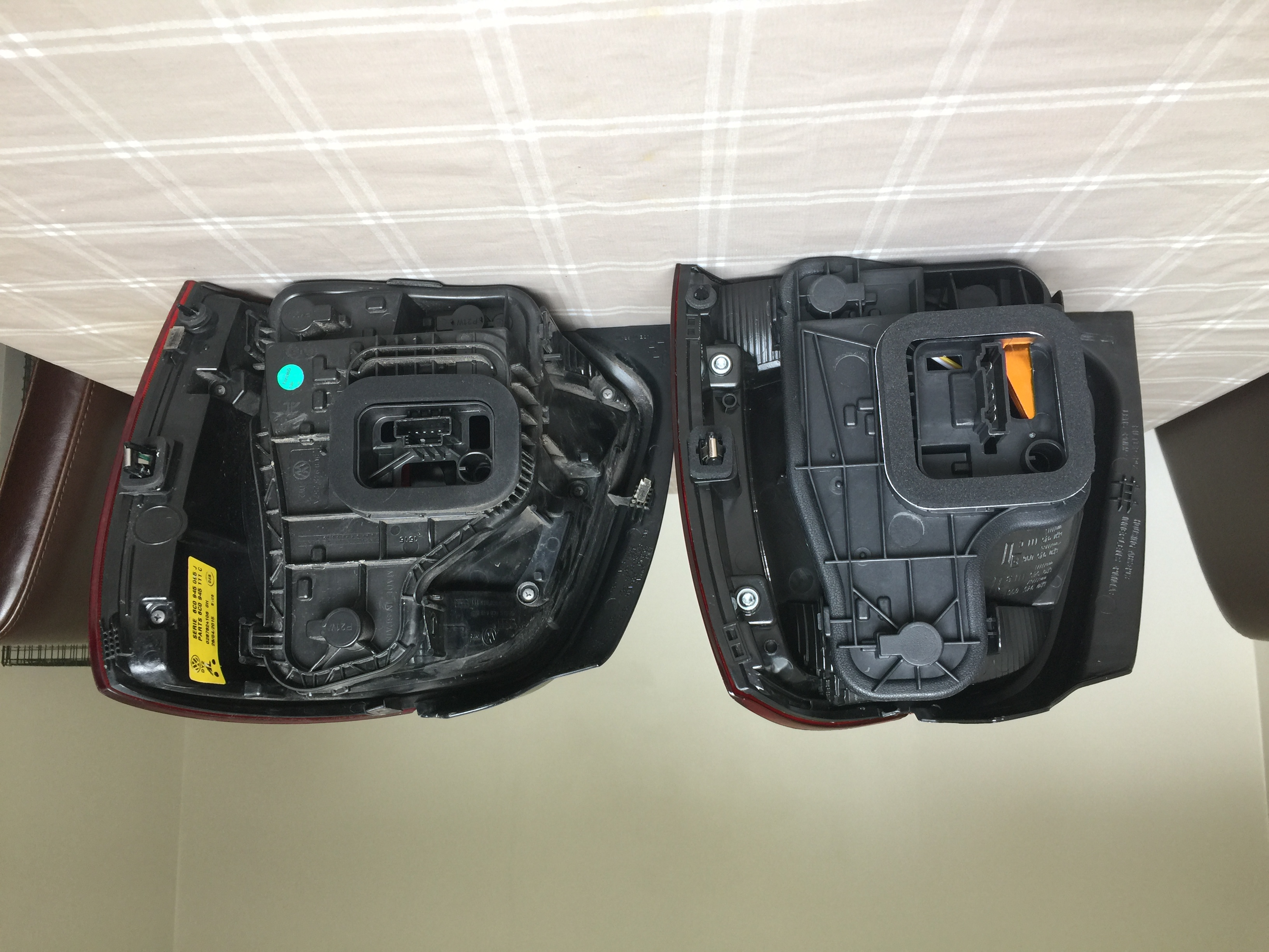

Sorry been confused by seller on eBay
Apparently the lights I have purchased are a 6r fitting and my car is a 6c
I have attached photos of the back of lights
My original is the one on the right
Thanks for your help
- Posts: 6693
I can make you a pair for about €45 including shipping
Car in the first post looks a 6R not a 6C.
If you want to fit 6C rear lights on a 6R you need this adaptor: 6R male rear light connector ---> 6C female light connector.
If you want to fit 6R rear lights on a 6C you need this adaptor: 6C male rear light connector ---> 6R female light connector.
