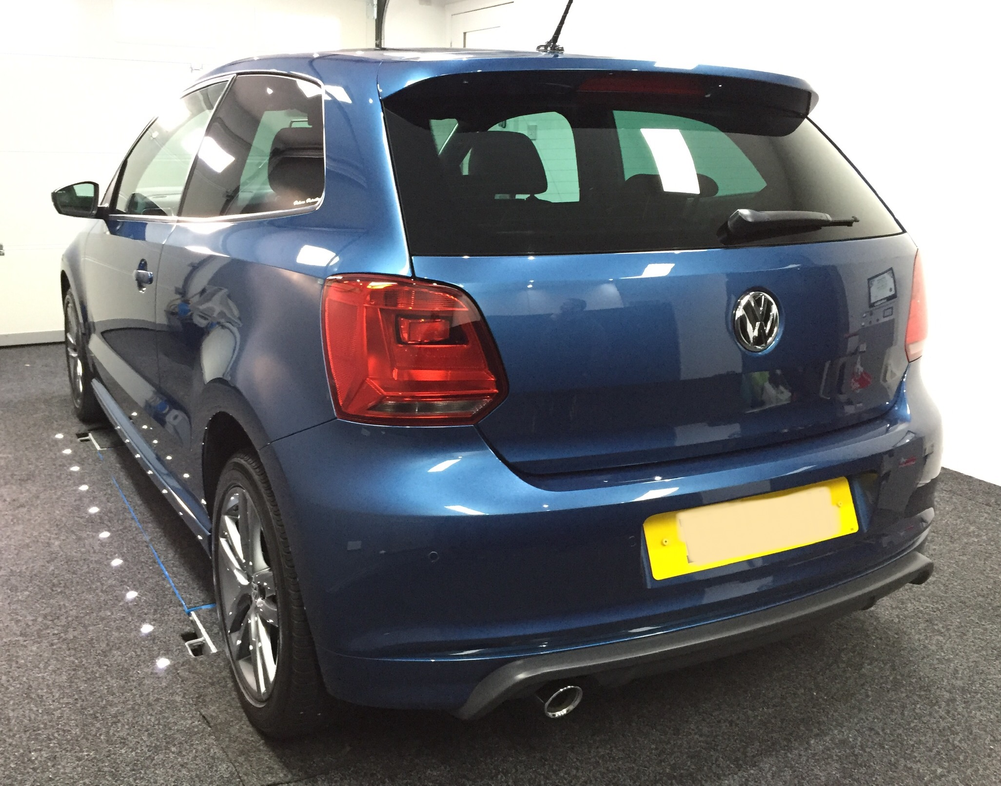

Had mine machine polished at Deluxe Detailing (to remove swirls and marring) and then coated with IGL Quartz (ceramic) which adds a hard protective layer to the paintwork and provides amazing shine. Better than when new. Water beads off and dirt is easy to remove. Good for at least 2 years protection before a top up is required. Not cheap, but dramatically reduces risk of adding swirls to the paintwork during washing and drying.
When washing I use a PH neutral shampoo (Krystal Kleen Choccy Wash) and use a soft wool cleaning pad. I usually wash once a week and, when I do dry, I use a large microfibre cloth.
My rinse water is fed via a DI pressure vessel which removes nearly all particulates/salts from the water such that there's no real need to dry the car (no water marks left on the paint surface when the water dries)
Angelwax H2Go on the glass to repel water (once every 3 months).
IGL Dash is great for covering marks on interior plastics without adding excessive shine

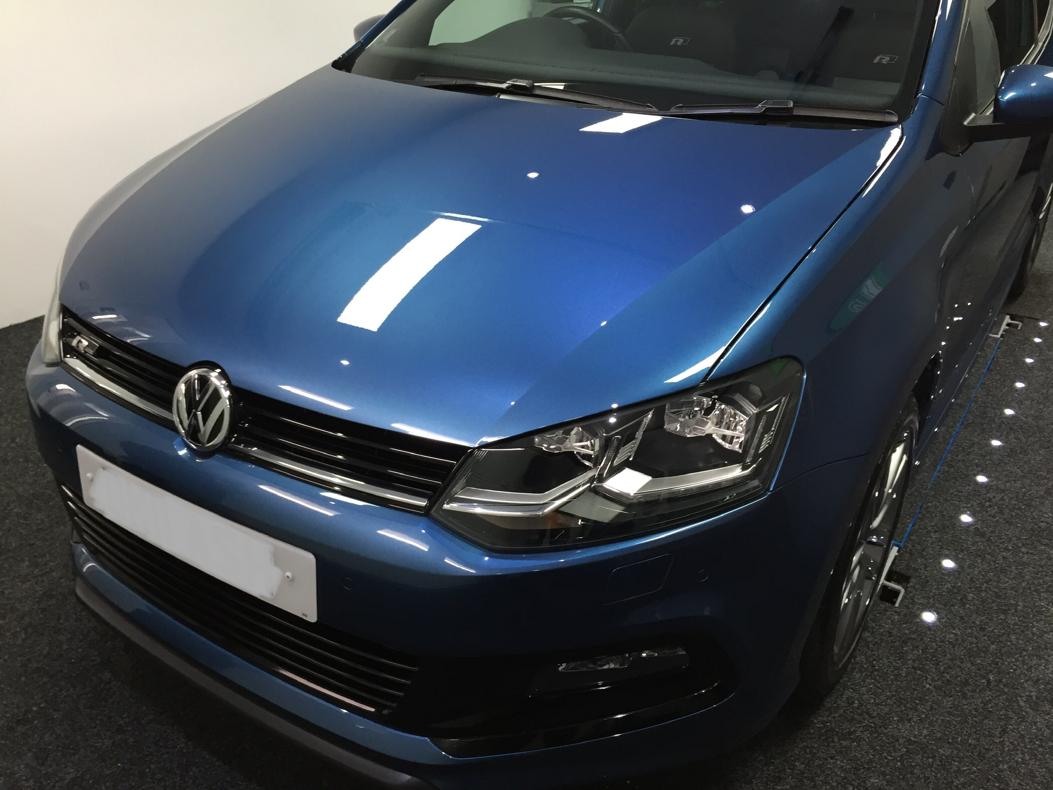

I machine polish my car usually every 12-18 months and it’s currently ‘wearing’ a couple of coats of Fusso Coat Dark 12 Months Wax. It’s actually a sealant rather than a wax, and is highly hydrophobic - very impressive water beading and water just rolls off the paintwork. Realistically I’ve found it offers a good six months protection, but type of shampoo used will be a factor in durability of a sealant or wax (I use a ph neutral shampoo that doesn’t strip sealants or waxes off the paintwork).
For a good value wax with good durability, I really like Collinite 845 Insulator Wax. I believe it’s effectively the liquid version of Collinite’s 476s paste wax. Collinite 845 is very easy to apply and buff off, and I’ve managed to get 6 months protection before needing to top it up.
It’s important to decontaminate the paintwork (iron fallout remover, tar remover and if necessary, claying) before applying a sealant or wax to maximise the bonding properties of the product to the car’s paintwork. Apply the sealant or wax with a sponge applicator pad, and buff off with soft microfibre cloths.

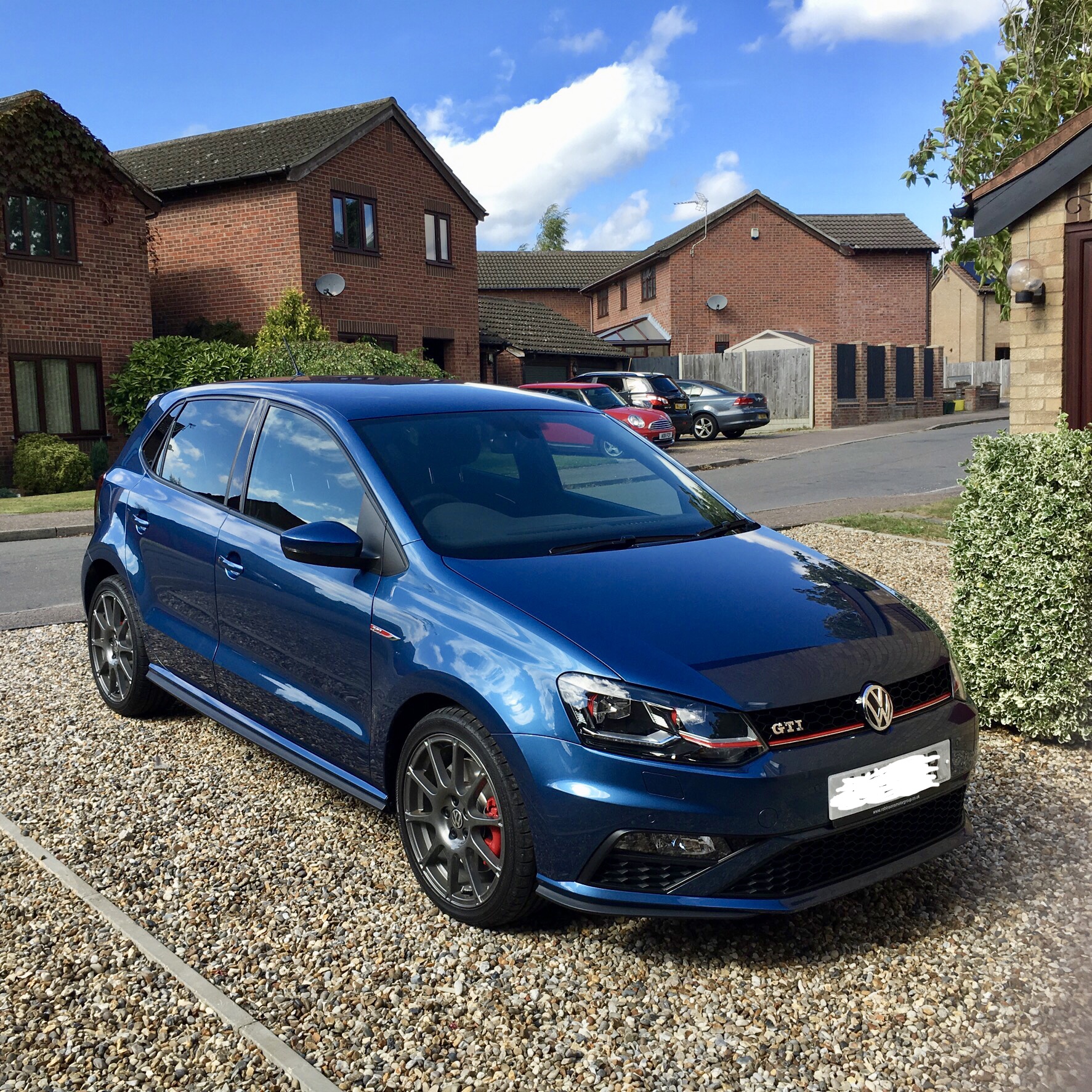

This is mine just after I’ve machine polished it and applied two coats of Fusso;
