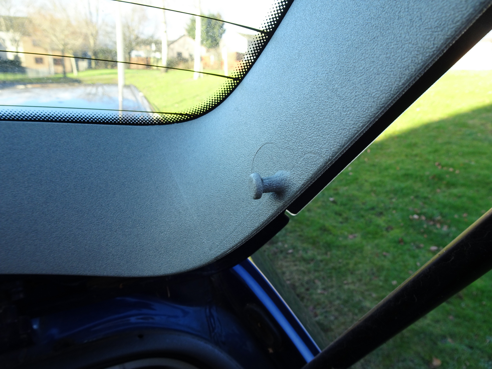

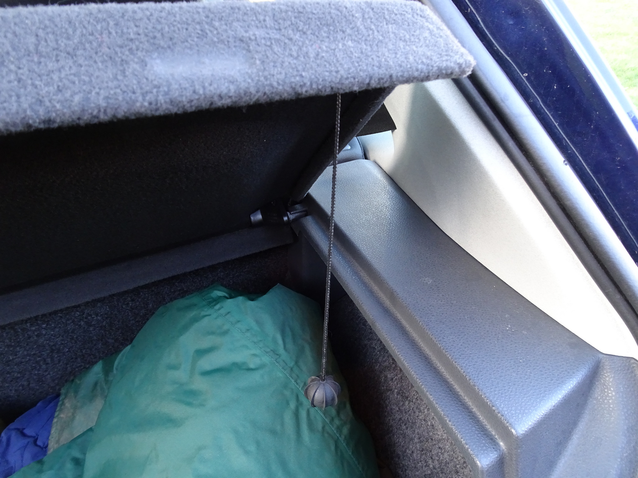

Should be similar - ish to ours (2002).
As Rum/Cpt Redex posted - if ours broke I would do a fix in situ along the lines of using a screw or dowel.

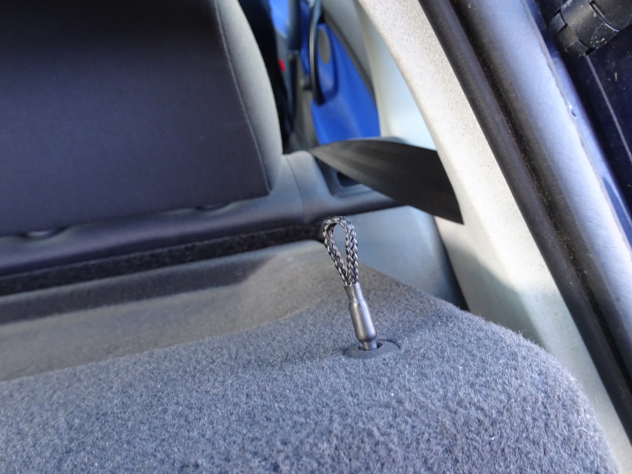

Detail of the cord/loop

Ah a picture shows it all, and corrects my idea that they were black pegs, not so just part of the rear trim panel!
The 6C Polo has no trim in that area so uses snapped in black pegs, maybe buying a couple of them and cutting the broken ends down flush, then drilling down and glueing and screwing them would be an option if you can’t find any suitable material to repair them.
Edit:- I have just checked up on the part number for these individual snap in pegs for a 2015 6C Polo and they are 1M6 867 574 A
you could order a couple in from a VW dealer’s parts department, then cut the stubs left on your trim and drill and fit them, just another option that is all.

To be fair - they might vary a little between models,but should be easy enough to 'bodge' with a screw etc - as long as the trim panel is not too badly damaged around the clips/pegs.
