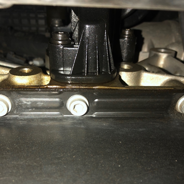

Hello,

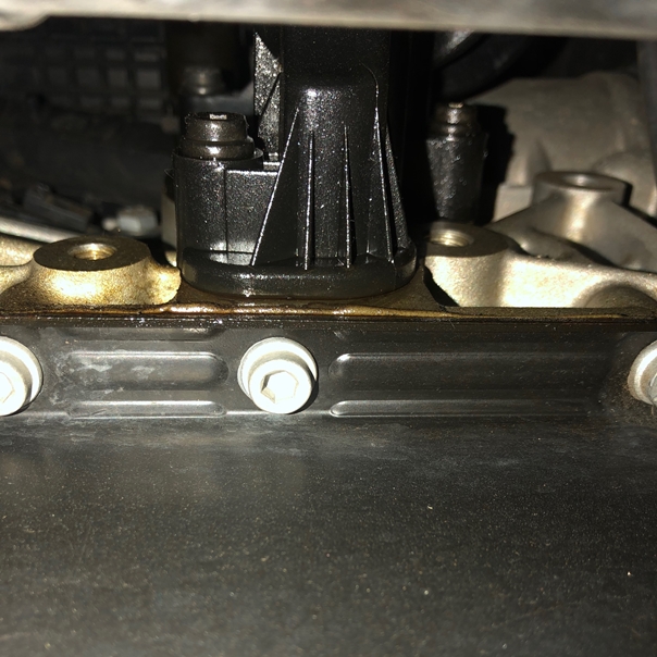

I recently found a small amount of oil on the ground so I went under the car and did a visual inspection. It looks like the leak is coming from the oil separator (036 103 464 AH) which is just above the oil sump.
oil separator
oil separator
How does this thing break? Do I get a new one or just replace the o-rings?
Posts: 6090
Re: Oil Leaks from Oil Separator
I think that certain cars Polo/Ibiza/Fabia had that problem due to incorrect material used in the manufacture of the O-ring seals, there are 2 seals which you can buy separately a small one and a large one, I don't know which one causes this problem. My daughter's late 2009 6J Ibiza 1.4 16V 86PS has a leak like that - I only discovered that by finding the rear lower area of the inlet manifold wetted with oil, I wiped it clean a couple of years ago and ordered in new seals as I had read that that was normally the problem, but I've not fitted them yet!
One other problem could be that the PCV valve or pipework is blocked with a build up of "lumpy" oil - and that is the weakest area so the excess pressure is forcing oil out of one of these O-ring seals.
Edit:- I had to replace the oil separator on my wife's old 2002 9N Polo 1.4 16V 75PS - but it was not leaking at all, just using/burning too much oil as the oil separator vortex had stopped being efficient at stripping the oil out of the air being dragged out of the crank case. As that car was a lot older, its O-ring seals did not have this problem that later ones seems to, maybe just a production batch issue or a change of supplier of these O-ring seals.

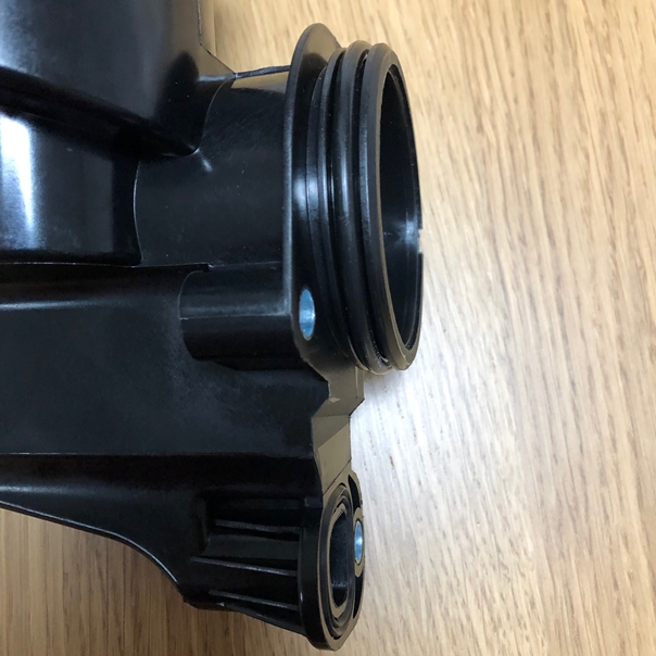

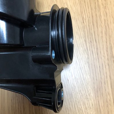

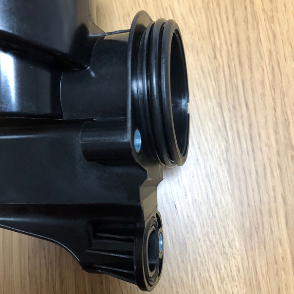

Thank you for sharing your experience with these oil separators. Yes, there are 2 O-rings as illustrated in the image below.
Oil Separator
Oil Separator
The rear lower O-ring seems to be the return to the crankcase since it is closer to the oil sump. If you did not replace the oil separator O-rings on your daughter's 2009 Ibiza, did the oil leak come back? How did you resolve that issue?

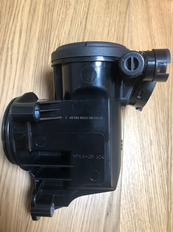

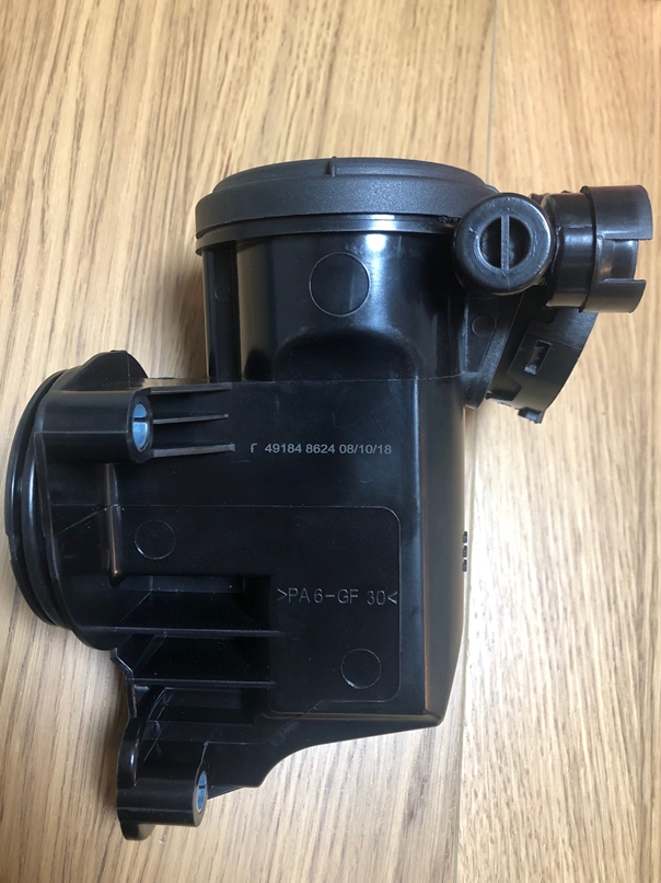

Got a Febi oil separator from Ebay. Not familiar with good aftermarket brands but Febi seems to be a good one.
Febi Oil Separator 49184
Any tips on how to make a successful installation?
It has three 5mm hex bolts that needs to be torqued to 10Nm, an electrical connector and hose that goes to the intake. The drive shaft is in the way. Can this be installed without removing the drive shaft? Is there anything that I need to remove to properly install this? Thanks.
Posts: 6090
Sorry for missing your previous posting.
Anyway, Febi seems to be an acceptable brand for parts, so you have found that the electrical connector is only for a heater - which is used to prevent freezing I think.
That is almost a nuisance as I had considered that there was a flap motor in there to control/limit/stop the flow of air passing through this separator - so there must be a small valve elsewhere that limits the flow of air during high vacuum conditions - I never ever got round to breaking the old one open to see exactly what was in side it.
Anyway, as I suggested in a previous posting, now that you have found that the drive shaft is in the way, you will need to do this job in the same way as I did it, ie from above and working from touch - it did not take me much time, you have in your favour that this separator can be pushed into the large hole on the side of the engine and will stay in roughly the correct position before you manage to fit the 3 screws/bolts in, as well as the seals, I seem to remember, will stay in place on the separator - at least the large seal will not be a problem.
The biggest problem is getting your body at the correct height and then lie flat, I think on the top of the car front and engine - and reach down to unbolt the screws one at a time and place them in a safe place.
Edit:- I did remove the air cleaner on my wife's 2002 Polo as it had a large engine cover/air cleaner, my daughter has a 2009 Ibiza with that engine with the smaller air cleaner, problem the same with your car, maybe think about removing that if it improves access for you to reach down to the oil separator.

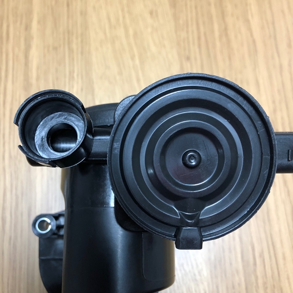

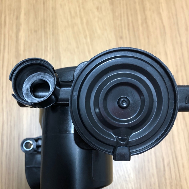

Thank you for responding. Good to hear that Febi is an acceptable brand. The flow of air to the intake seems to be controlled by the diaphragm that looks like a hockey puck but I am not sure how this opens and closes. If you look at the picture below the hose to the intake goes to round hole on the left. By the way, do you remember how the hose is connected? Do you twist it or just push and pull.
You are correct that the oil separator can be pushed into the large hole in the crankcase and it will stay in place. There is plastic that protrude out and goes inside the crankcase.

Sorry but I don't remember exactly how I removed that pipe, the cut out at the side must be there for some reason though - I did not buy any new seals etc for that pipe, it was just removed, oil separator replaced, and that pipe refitted.
The part that looks like a hockey puck, I did remove that cover after I had replaced this assembly on my wife's 2002 Polo 9N 1.4 16V back in 2010 or so, but I did not think that I had found out why it could be removed - ie what you could do while that assembly was fitted to the car to sort out anything. You are probably correct in that the diaphragm and spring(I think) inside that area will be the Crankcase Regulating Valve - or serve the same function as one - I had not thought about that initially.

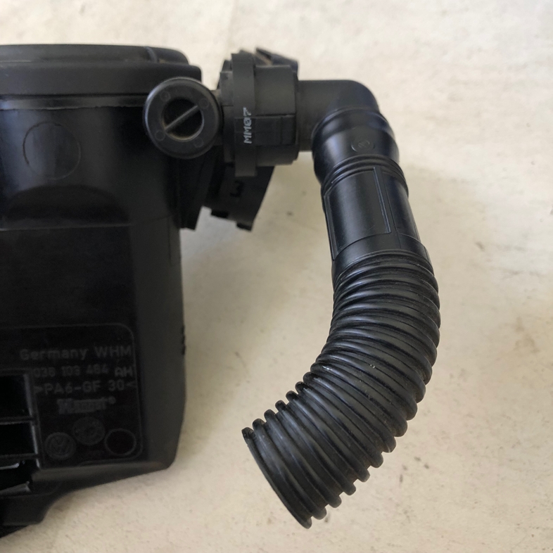

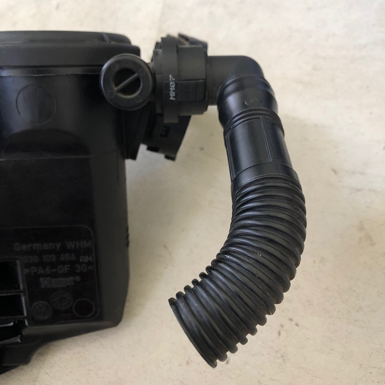

I removed the oil separator and in the process, made a big mistake by accidentally breaking the plastic hose! I was trying to figure out how to remove the hose so twisted it and it broke. I need to get a new one. It's a pain to connect the other end as it goes under the intake manifold which may have to be removed first.
Does this mean I can't drive the car until I have replaced this hose? Is it ok to drive the car with the new oil separator but release the air in the atmosphere. Is that clean air because oil has been separated and ready to be fed back to the intake?
Broken hose
Broken hose
Posts: 6090
Bother Bother Bother!!!
Seeing that picture still does not bring back any memories of how I removed that pipe - but it should show you how to remove it, so why not remove it, fit it to your car and use a short length of plastic or copper or steel or aluminium alloy pipe to hold the 2 parts of the pipe together until you can buy a new pipe.
One thing, I replaced the brake servo pipe in my wife's old Polo, and removing that pipe was quite difficult because of the way VW designed the clamp at the inlet manifold end - but, VW had changed the design for replacement pipes so that they could be easily fitted by a garage, the original design was probably only to speed up assembly in the engine manufacturing plants, so don't worry if removing that pipe looks like being difficult, I think that I used 2 screwdrivers as levers to ease the brake servo pipe back off the shrouded spigot it was pressed onto on the inlet manifold - if any of that makes sense.

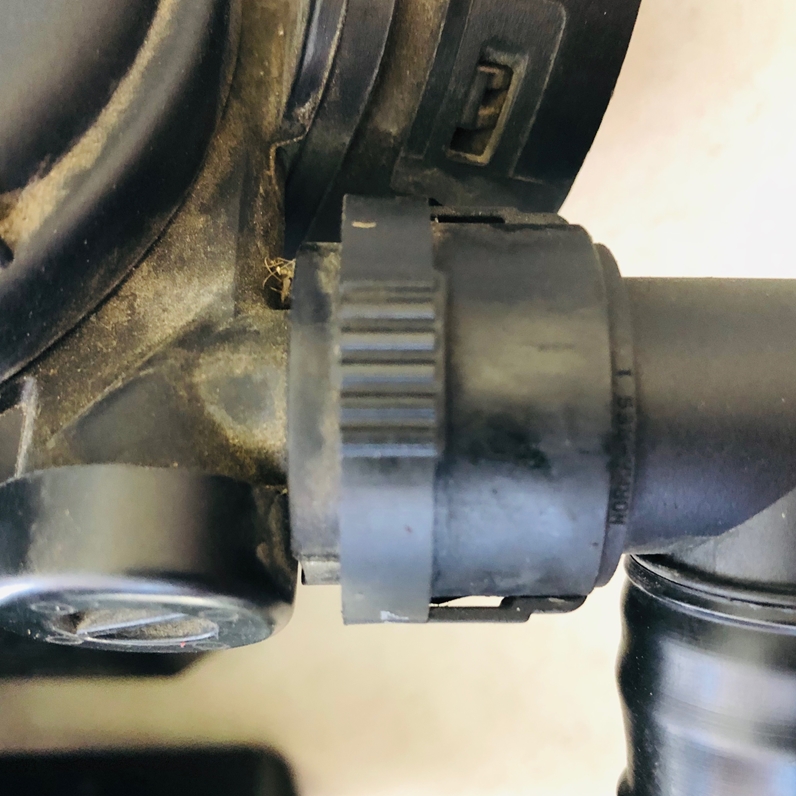

The pipe is just a squeeze together on the fitting on the end, much like opening a bottle of bleach then it just pops off

Post by Lester »
Hi RUM4MO,

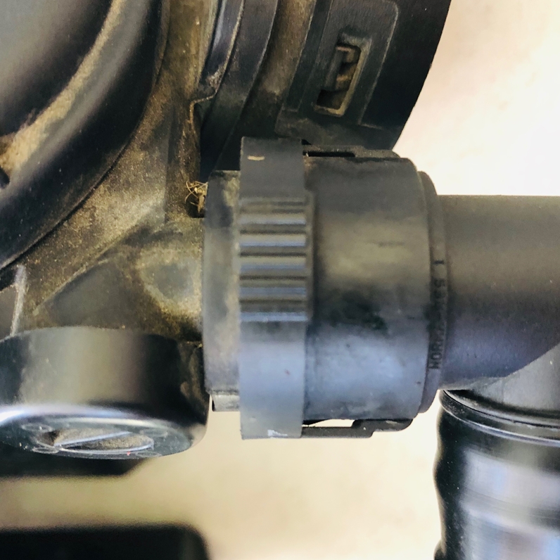

Yes, I always have trouble when working on the car and I've thought about ditching it many times. :( Below is the picture of the vent hose lock. Alex is right. You release it by squeezing hard both sides then pulling it out. I had difficulty removing it even when I have the oil separator in may hands (after removing) so it was kind of impossible to remove it from under the car where you have limited access/force. The vent hose only looks flexible but it isn't. It would break if you try to bend it.
Vent hose lock
Vent hose lock
I don't think I will buy a replacement vent hose (036 103 493 EC) because removing the other end, the one attached to a preheater before going to the intake is impossible to remove. Looks like the intake manifold has to be removed first. I have taped it for now and will later find a hose clamp to hold the hose together. Thank you for your recommendation. I started the car with the new oil separator and no engine light appeared on the dash so maybe it's ok. Will wait a couple of weeks to see if the leak is gone.
