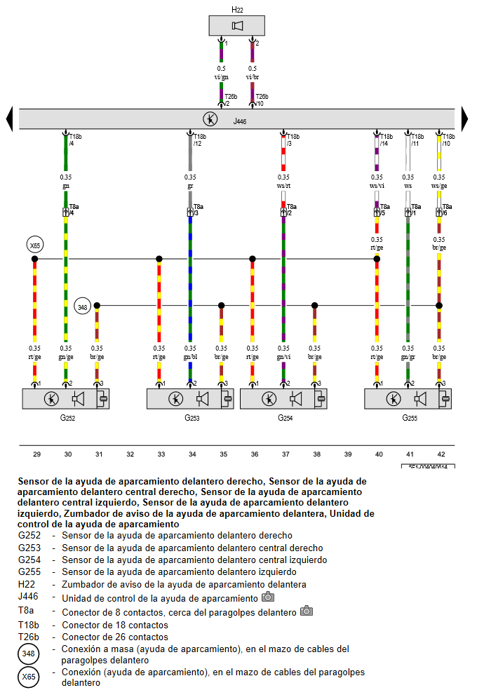

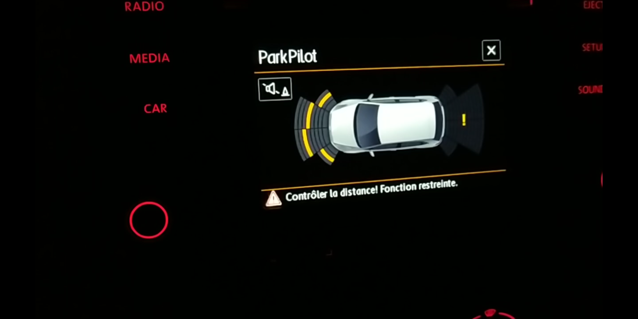

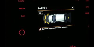

Hi everybody;

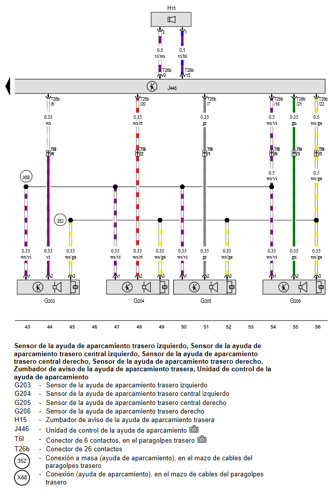

I installed OPS 8K Park pilot on my Polo 6c (2015); I followed the next diagram:
and theses:

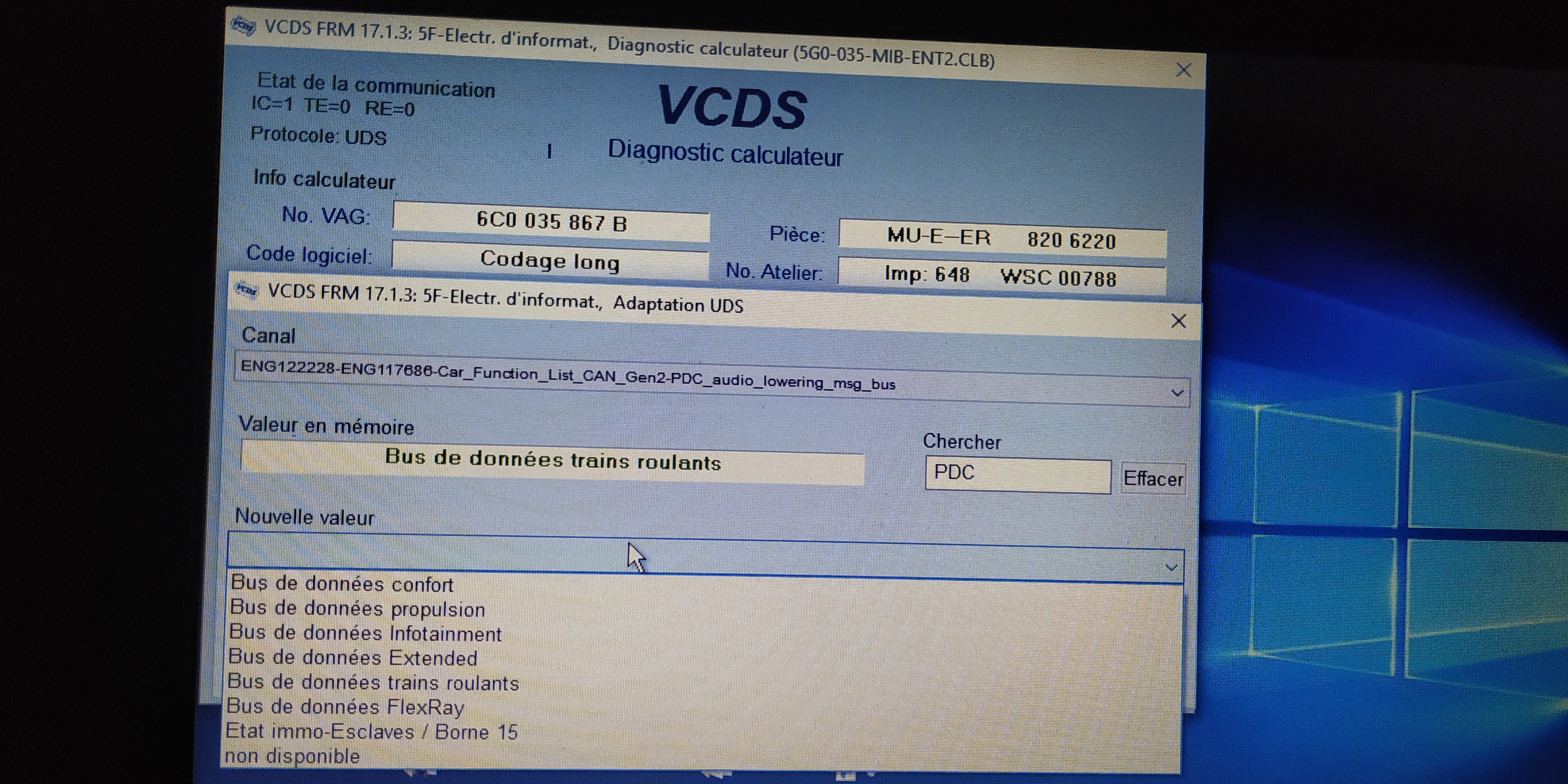

Coding with VCDS:
- I registered the module in the installation list of Can Gateway module [19 CAN Gateway].
- I coded the module [10-Assistance stationnt] (code delivered by the seller on AliExpress).
- turning the next [5F infotainment] configuration to "Active" :
ENG122227-ENG117496-Car_Function_Adaptations_Gen2-menu_display_pdc,activée
ENG122227-ENG117498-Car_Function_Adaptations_Gen2-menu_display_pdc_over_threshold_high,activée
ENG122228-ENG117685-Car_Function_List_CAN_Gen2-PDC_audio_lowering,Disponible
ENG122228-ENG117686-Car_Function_List_CAN_Gen2-PDC_audio_lowering_msg_bus,Bus de données trains roulant
ENG122229-ENG117710-Car_Function_List_BAP_Gen2-parking_assist_0x0A,activée
ENG122229-ENG117711-Car_Function_List_BAP_Gen2-parking_assist_0x0A_msg_bus,Etat immo-Esclaves / Borne 15

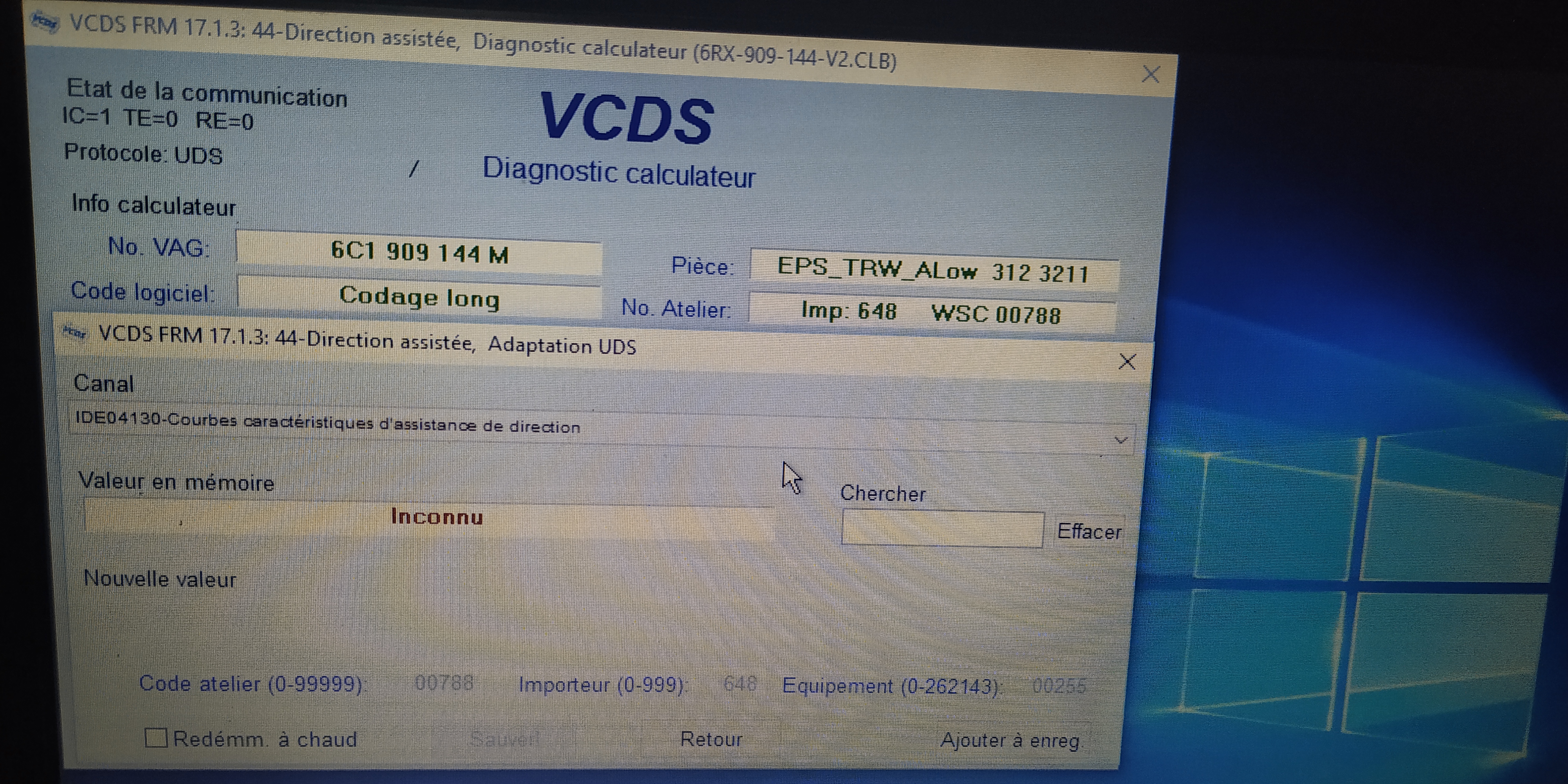

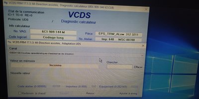

But modules: [17-Instruments] and [44-Direction assistée] NOT TOUCHED; and before installation there was not any error!

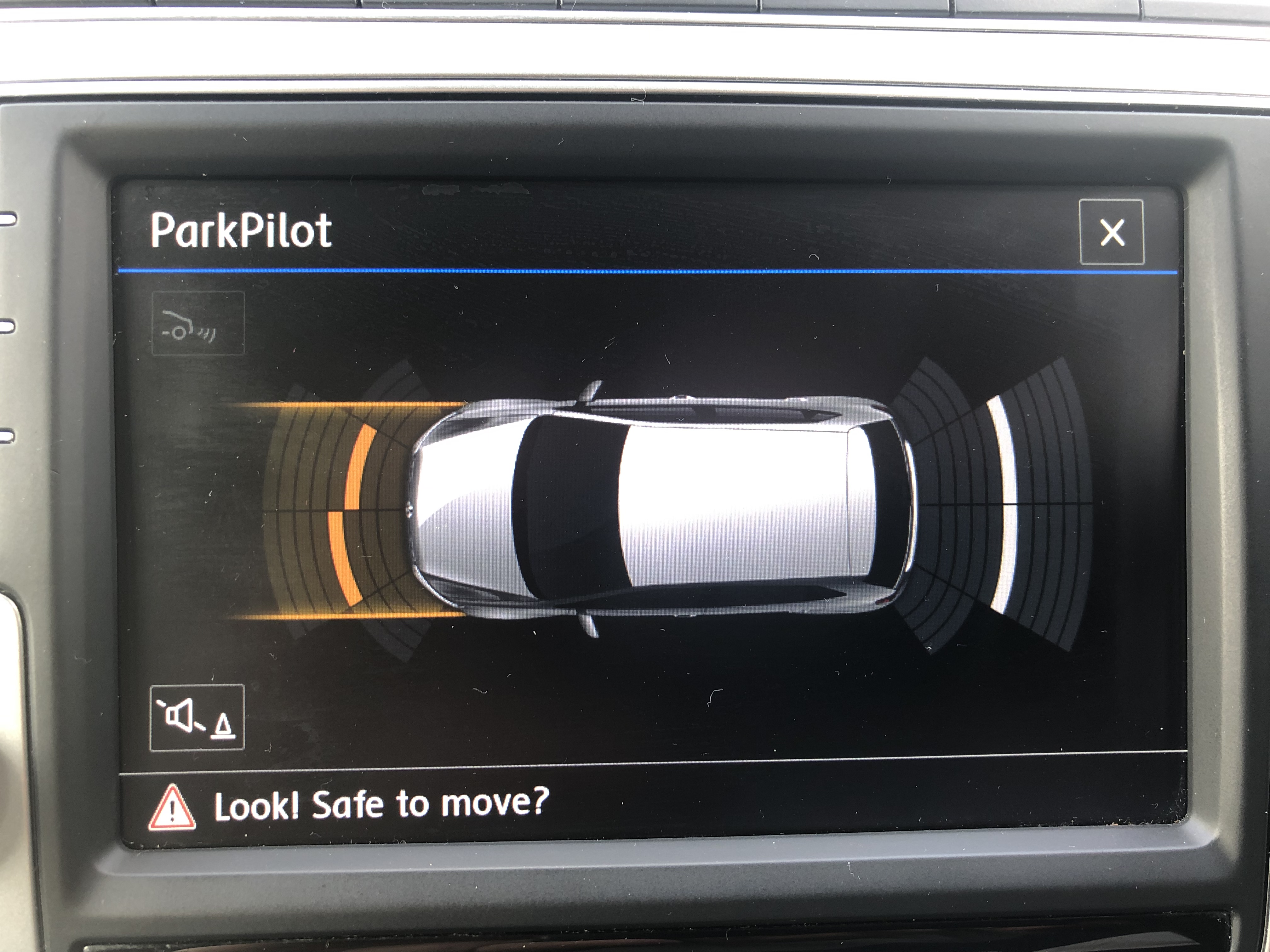

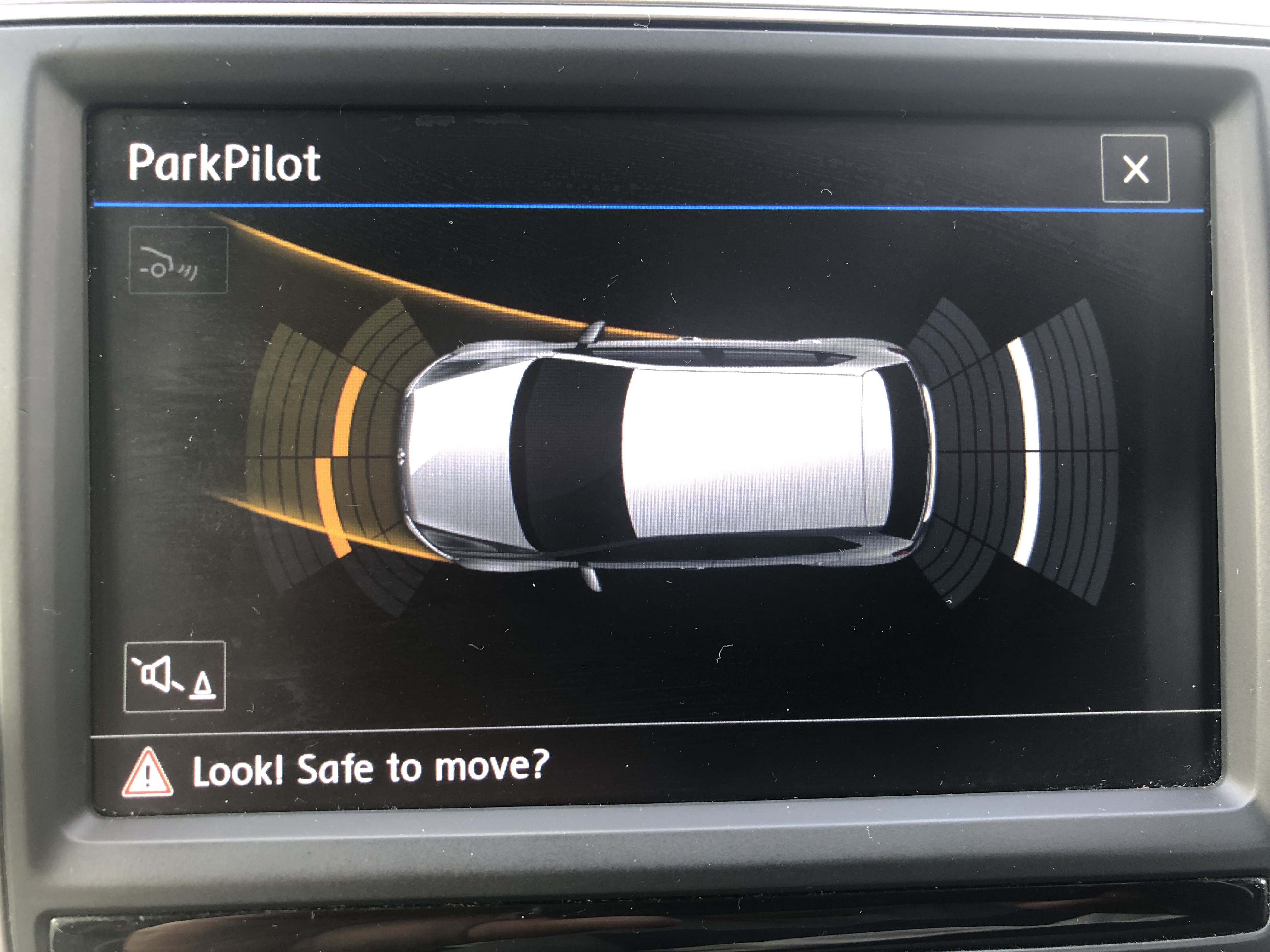

and finally; only front sensors work; there is a problem in rear sensors :cry: but I can't locate it.
aslo; after installation by full scan; there were several fault codes; in modules: [10-Assistance stationnt] and [17-Instruments] and [44-Direction assistée].
Can you discuss with me the possible diagnoses please?

NB: rear buzzer wiring is corect (following diagram). I tried to replace it with front buzzer; but the same problem!! :(
Posts: 6093
Re: Retrofit park pilote 8K OPS for polo 6C 2015 [help]
Well both codes claim to be due to "incorrect coding U101400 [009] - " - so, did you alter this car's controllers code to include this OPS retro fit?
Edit:- as the OPS for front and rear are showing in the display, something must have been done I'd think, but was it recoded correctly?

About coding with VCDS; I've done it as follows:
- I registered the module in the installation list of the Gateway module [19 CAN Gateway].
- configuration of [5F infotainment] module to "Active" :
Liste des fonctions du véhicule BAP-parking_assist_0x0A
Menu Véhicule operation-menu_display_pdc
Menu véhicule Operation-menu_display_pdc_over_threshold_high
But modules: [17-Instruments] and [44-Direction assistée] NOT TOUCHED.

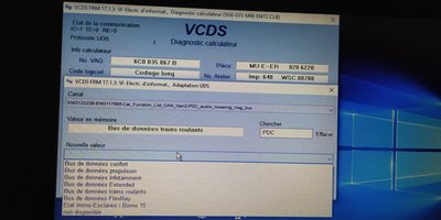

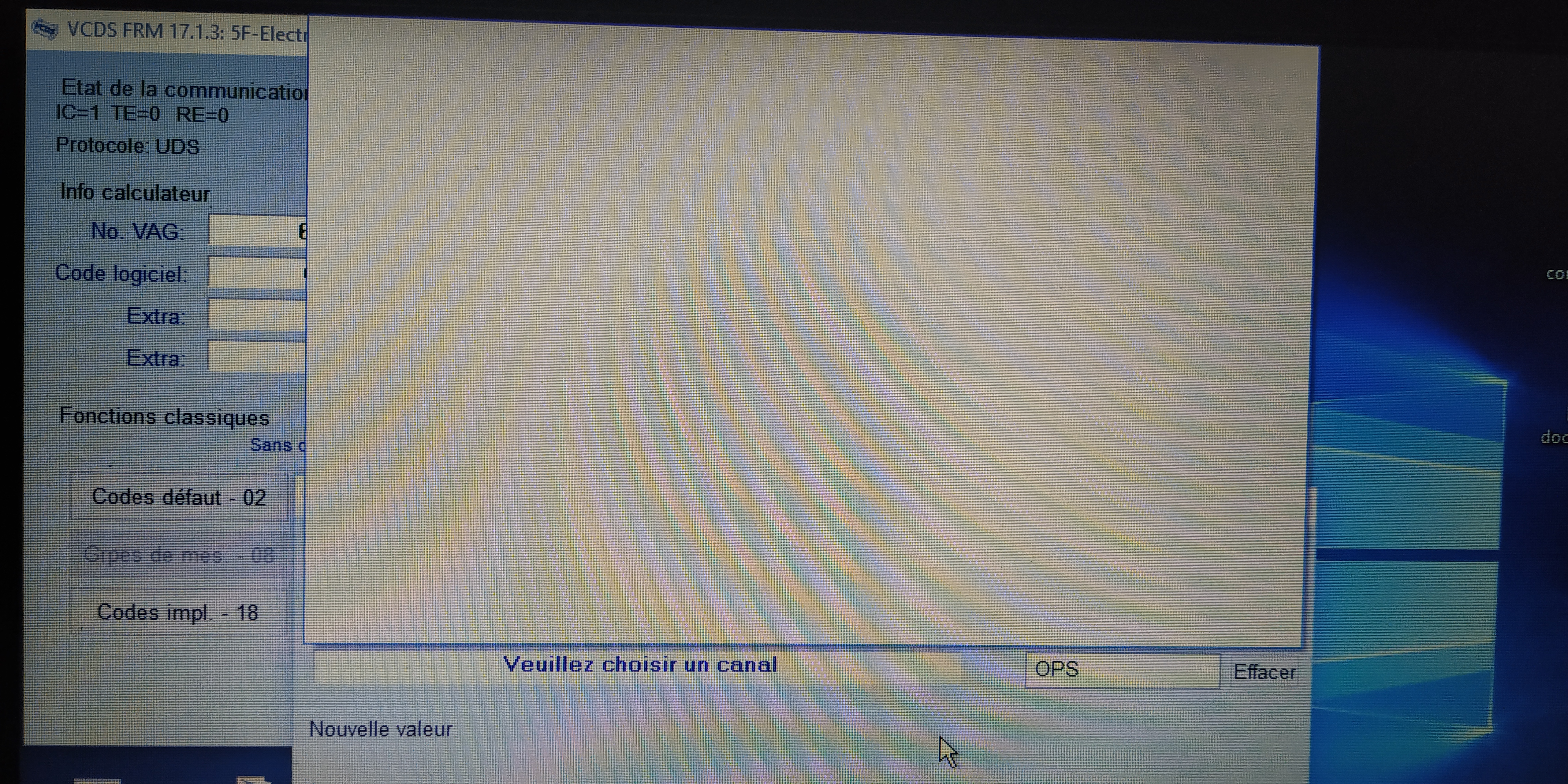

I have 8K OPS on my Polo 6c.
These are Settings in 5F Infotainment:
Adaptations:
In Car-Function_Adaptations_Gen2 i have:
menu_display_pdc: activated
menu_display_pdc_clamp_15_off: Not activated
menu_display_pdc_over_threshold_high: activated
menu_display_pdc_standstill: Not activated
menu_display_pdc_after_disclaimer: Not activated
In Car_Function_List_BAP_Gen2:
Parking_assist_0x0A is activated
Parking_assist_0x0A_msg_bus is Terminal 15
In Car_Function_List_CAN_Gen2:
PDC_audio_lowering: available
PDC_audio_lowering_msg_bus: Suspension data bus
In Vehicle_configuration:
OPS_display_in_dash_board_display_unit: Off
Pilot_Parking: Not activated
In 19 Gateway:
Adaptations:
Installation list, specified installations:
Parking Assistance: coded
In 09 Central Electric:
Long Code: Byte 15 bit 6 enabled (Parking Aid Deactivation Button Installed)

I see a couple of things that seem different from mine:
1: PDC_audio_lowering_msg_bus: Bus de données trains roulant
mine is Suspension data bus.
2: the long coding in 09 unit byte 15
Yours is 00 while mine is C8
Bit 3 is start/stop deactivation button
Bit 6 enabled (Parking Aid Deactivation Button Installed)
Bit 7 is Horn signal via Lin
So you would need to enable bit 6. So byte 15 becomes 40
I have rearview camera installed so my coding in the parking assistant unit is different on byte 02 mine is 15 yours is 10

I checked what you mentioned massimo23, and I found this:
1- I didn't found this adaptations in [5F] unit: (In Vehicle_configuration)
Pilot_Parking: Not activated.
2- PDC_audio_lowering_msg_bus, I didn't found suspension data bus, but I found this: (wish one should I choose?) "french language"
3- long coding in [09] unit byte 15: I changed it to 40.
4- long coding in control unit parking assist [76] in ODIS, or [10] in VCDS:
AliExpress seller gave me the codage "0431151001", once I put it, I could not change it to "0031151001". I tried that several times but it was rejected!
I hope we are on the good way, thank you very much massimo23 for your assistance..

ok so looking at your menu in French the option Bus de données trains roulant is same as Suspension data bus.
Also have you tried entering the security code for the parking unit 10 and then try the coding?
the access code should be 71679.
Also clear all your errors and see if anything changes :)

2- How about (Vehicle_configuration) adaptations in [5F] unit:
Its not found in my adaptations, can it be due to a lack of long coding in [5F] unit?

Hi massimo23:
about my coding/adaptions for steering assistance:
- long coding is: 0007
- adapataion "Characteristic curve of steering assistance: Driving profile selection button" is unknown (photo)
and the rest of adaptions is:
SW:6C1-909-144-M HW:6C1-909-144-D --- Direction assistée
Pièce:EPS_TRW_ALow 312 3211, Codage:0007
EV_SteerAssisUDSTRW,011021,EV_SteerAssisUDSTRW_011.rod
Mardi,26,Mars,2019,12:52:32:50725
Version VCDS: FRM 17.1.3 Version données: 20170223 DS267.4
VCID: 326A95C765E944D12F-8066
IDE00820-Activation/désactivation tous les mess. de développement,pas actif(ve)
IDE03724-Conduite en ligne droite,activé
IDE03734-Puissance d'assistance,100%
IDE04555-activer l'assistance de direction moteur arrêté,pas actif(ve)
IDE05162-Fin de course logicielle,activé
IDE06419-Commutation profil de conduite,progressivement: commandé par le temps
IDE07540-Téléchargement sans Restbus,pas actif(ve)
MAS02080-Protocole de calibrage XCP,pas actif(ve)

I tried to change [10] park assist unit coding to: 0011151001 (byte 01/ bit of Vehicle path display: with vehicle path display is disabled)
at this time; codage is accepted then I deleted all error codes; but I was surprised by the inactivation of all the park assist system (even front sensors are absent) and no thing happen by triggering the reverse; and switch button is not functional. I do not really know what to do??!

Try this coding 0411051001 .. the coding for this unit is slightly different than the oem version in the polos at least the byte 00.
