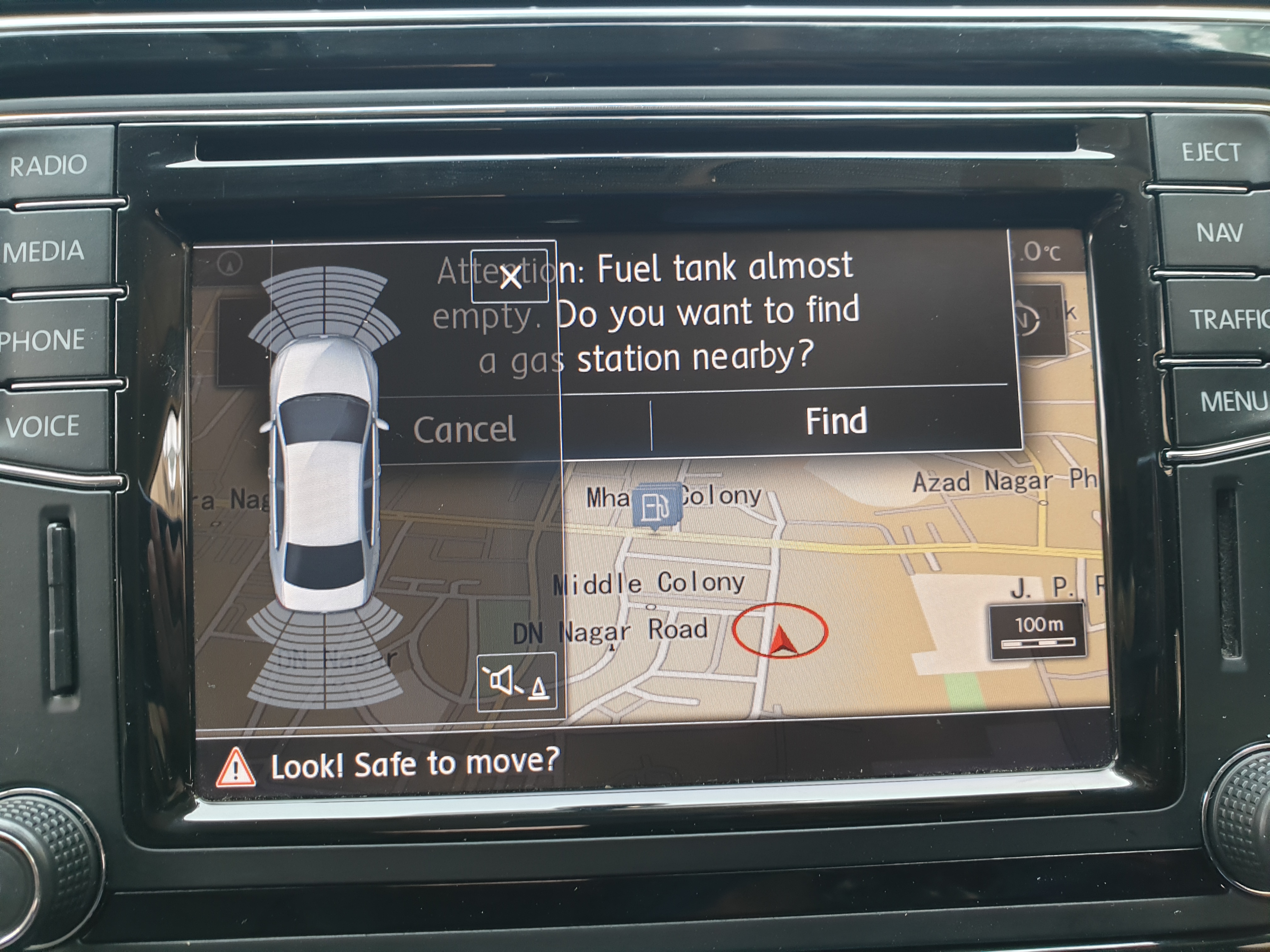

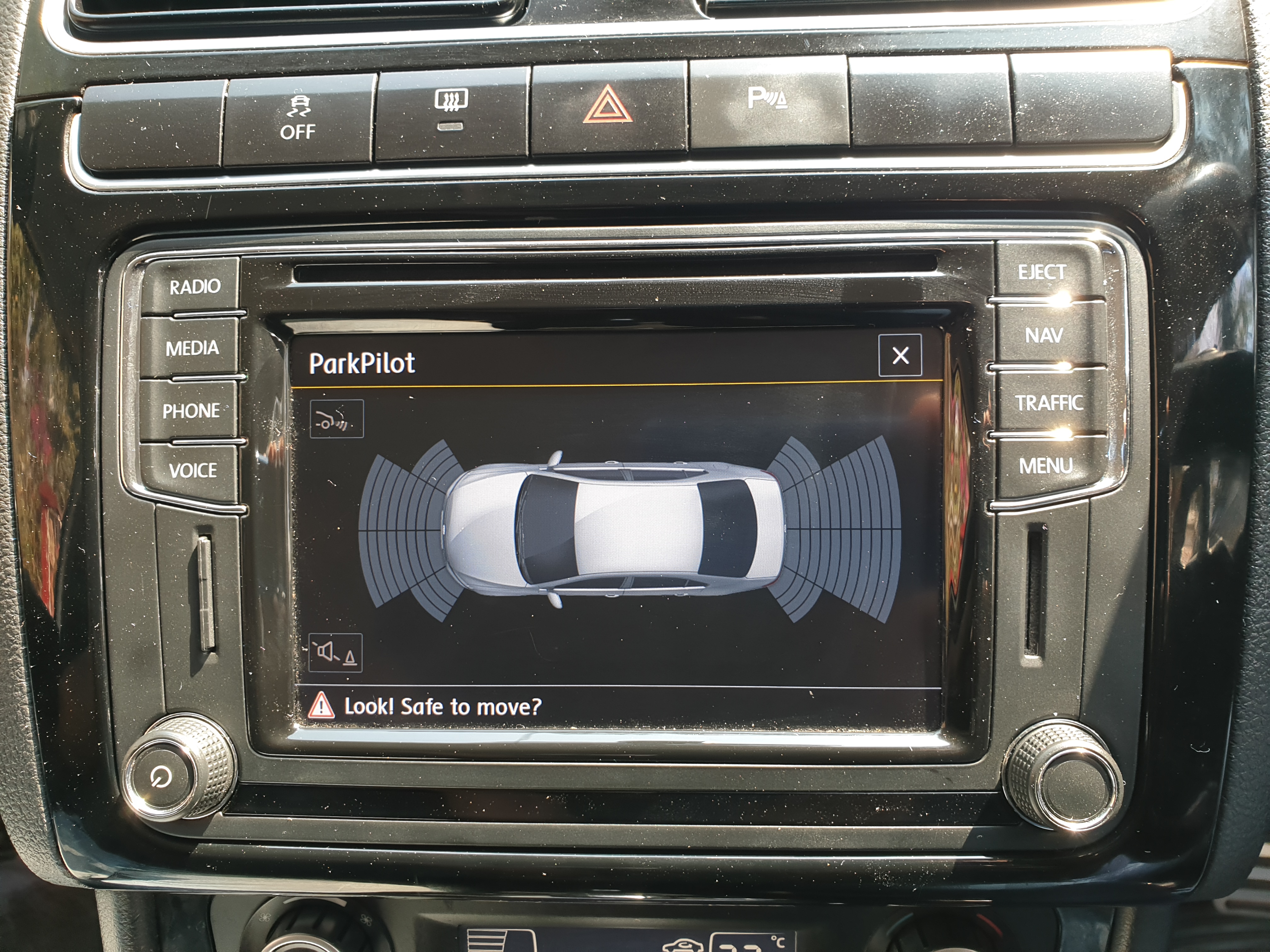

As Ciclo rightly said polo 6R cannot support 12K PLA 2.0. The module requires separate CAN. You can maximum install the eight sensor configuration. Some pictures attached
