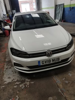

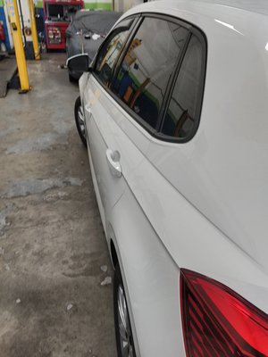

Today I gave my car a valet. Inside and out as well as underneath. Photos show results after a wash and wax, came up super shiny and swirl free. (wheels weren't done at time of photo)
