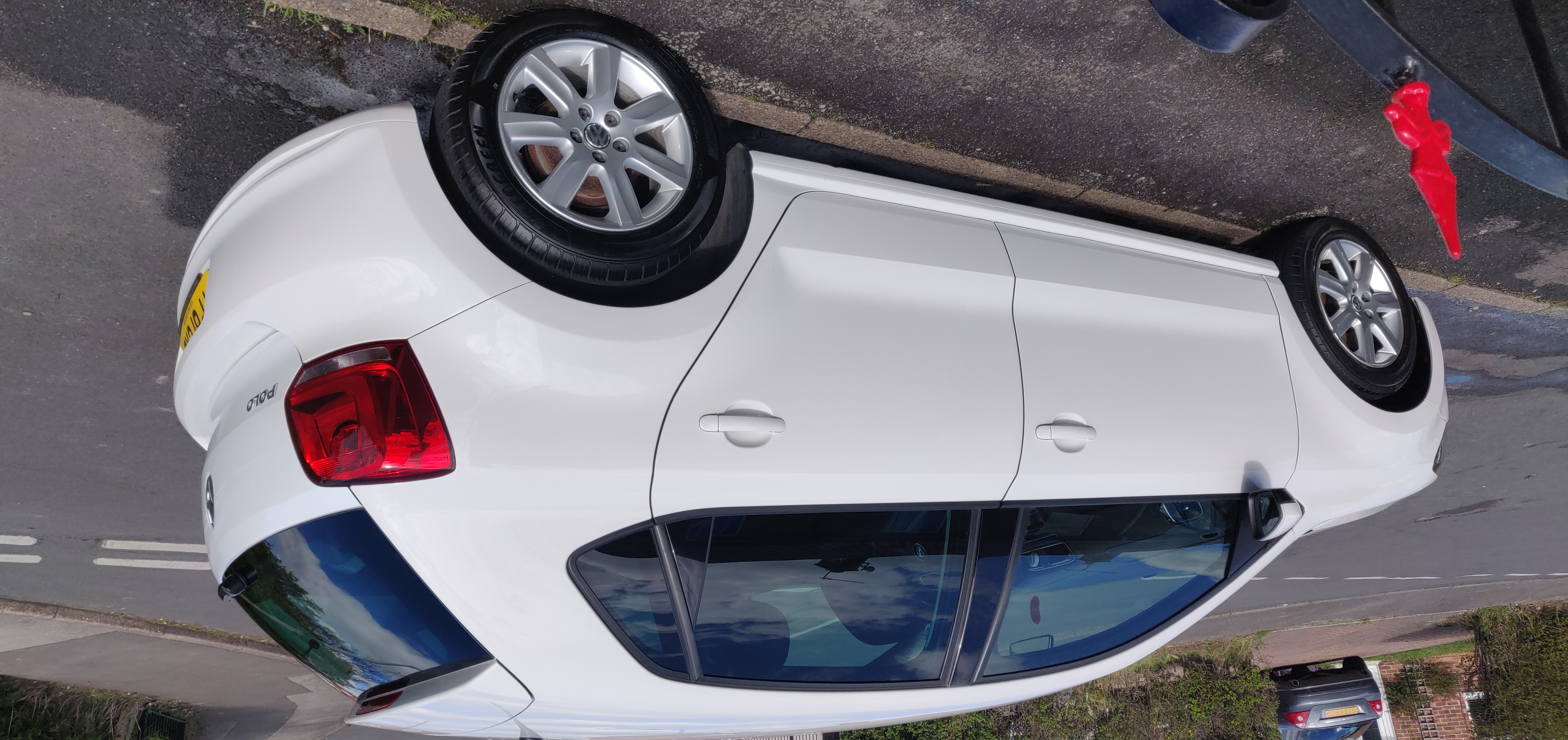

I'll now be sarcastic and suggest that you are located in Oz - joke!

Yeh, the reason is that the sump's become the cylinder-head, and the cyinder-head's become the sump. Heh, heh, heh!
