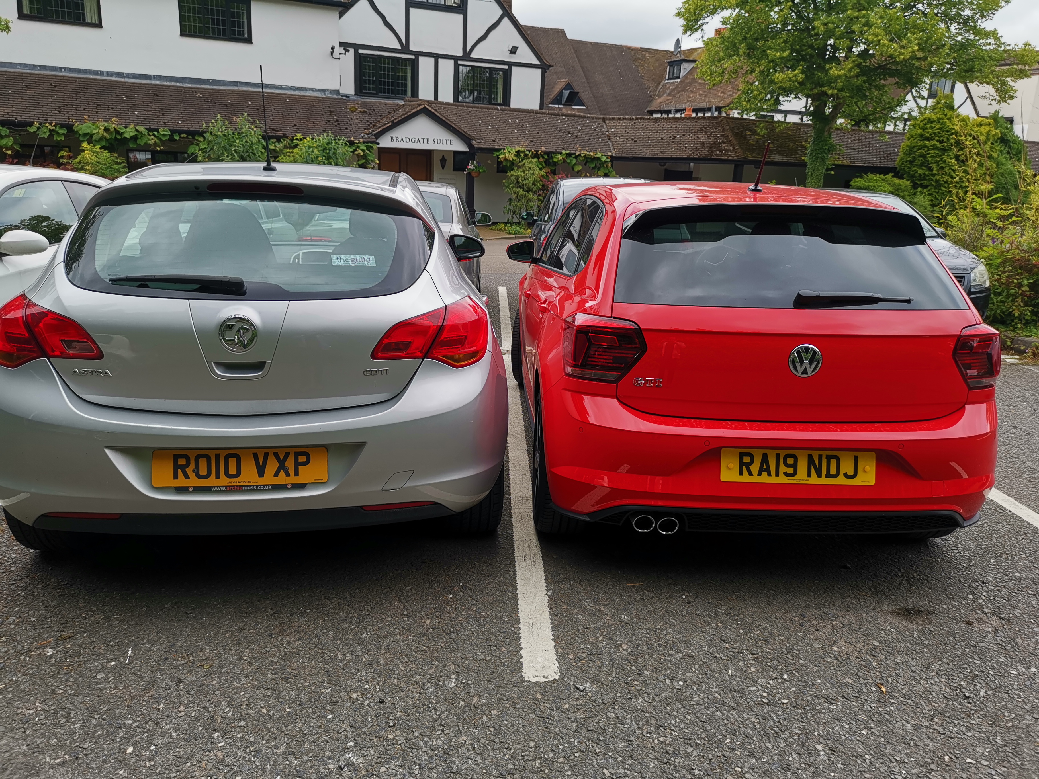

Went out to go to work this morning and someone had parked freakishly close to my car.
I mean really freakily close.
They have to have exited via the passenger side.
Wow, was there actually any need for them to do that, I hate it when that happens. I take pictures of my cars every time I leave it in a car park now, whether someone is there next to me when I park or not, maybe I'm a bit paranoid!!
Posts: 3838
MilgeS wrote: Mon Jun 17, 2019 7:09 pm Wow, was there actually any need for them to do that, I hate it when that happens. I take pictures of my cars every time I leave it in a car park now, whether someone is there next to me when I park or not, maybe I'm a bit paranoid!!
Don’t get me started on public car parks and other driver’s parking skills and (lack of) consideration for others! 😖. Over the years, cars have grown in size but unfortunately, parking spaces don’t seem to have got any bigger, and the standard of some driver’s parking leaves a lot to be desired. Creates the ideal conditions for scratches and door dings, and I’m speaking from experience, and I dare say others on the forum have also suffered a similar fate from the lack of consideration by others.
If I were to give the Astra driver the benefit of the doubt, perhaps when they arrived to park, the space they parked in may have been the last available space. If the car to their left was parked very tight to the R/H side of the space they were in, then the Astra driver may have had no option but to also park very tight to the R/H side of their space, and then exit their car via the passenger door.
On the face of it though, it does look like inconsiderate parking by the Astra driver.

The car parking spaces here are vast in number.
The 2 spaces to the right of me are empty.
I spotted her returning to her car sometime after I had got back from work.
She was in a uniform so I know she works here.
I was going to go down and present the picture to her and ask why she felt so inclined to park so badly. I resisted the urge.
It is obvious that she wanted a space as close to the entrance as she could find.
