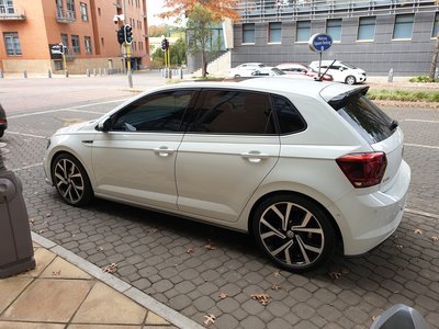

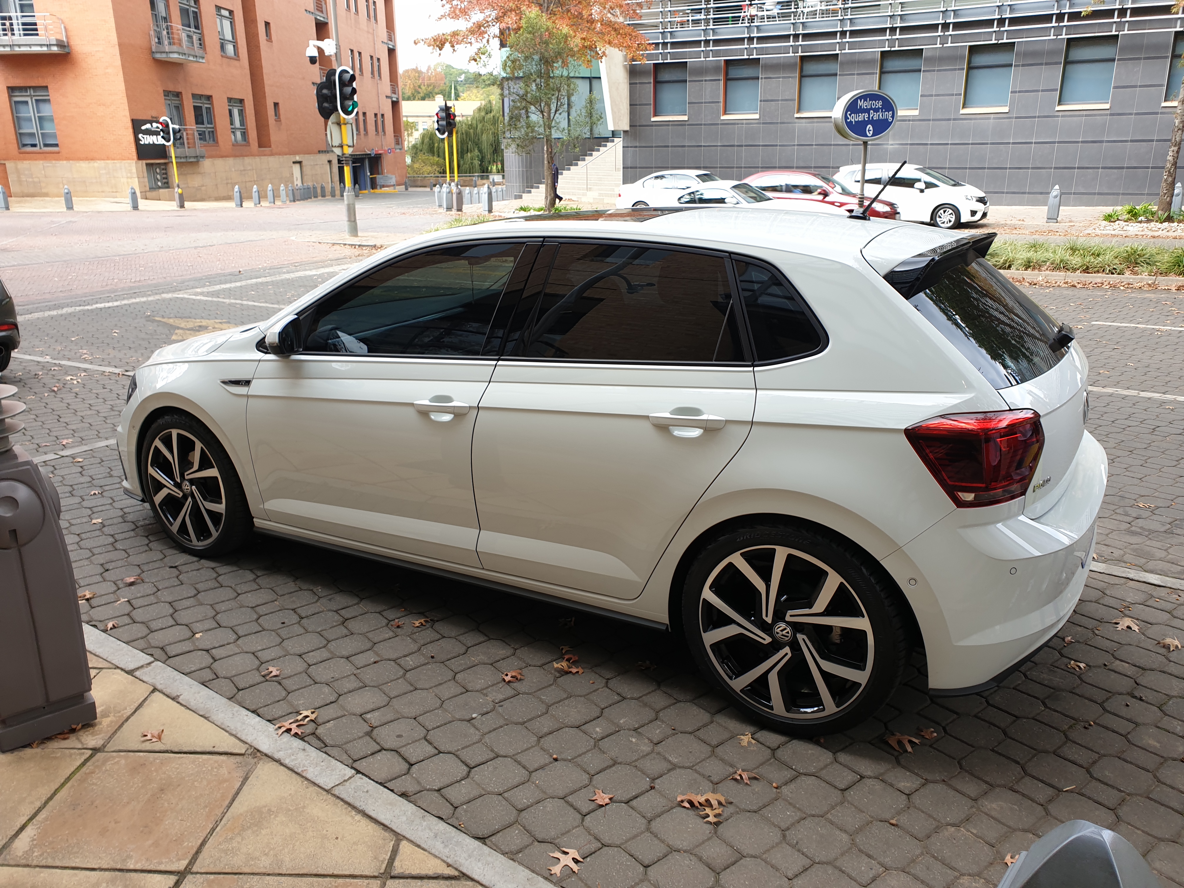

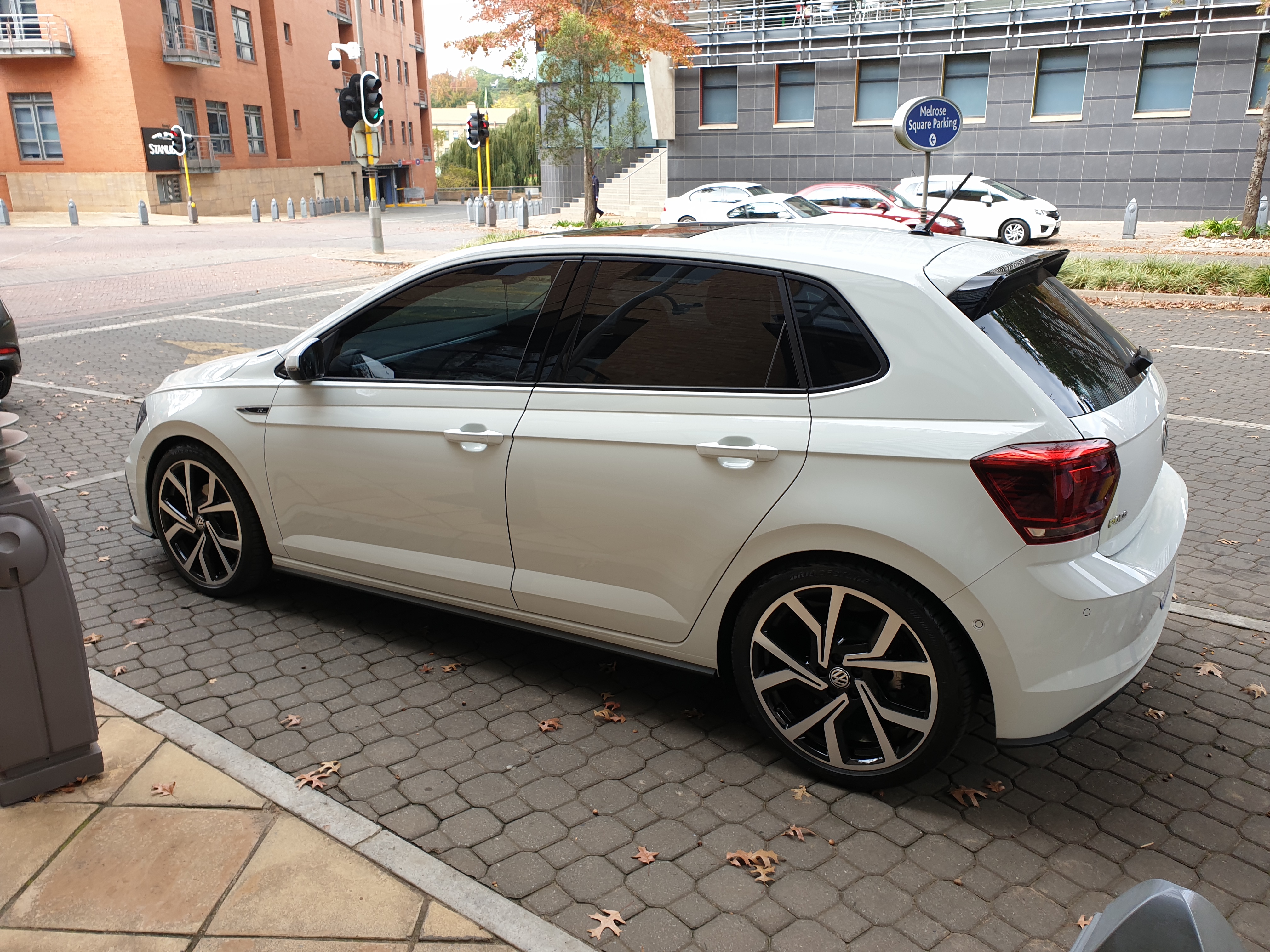

Re: Brescia alloys
Hi.
Yes it is quite easy.
I fitted my 18" Brescias from my Polo GTi onto my R-LIne with 12mm spacers at the front 15mm at the rear.
My vehicle is also lowered, no problems with rubbing on the fenders.
I'll post some pics later.

Re: Brescia alloys
Looks tremendous
