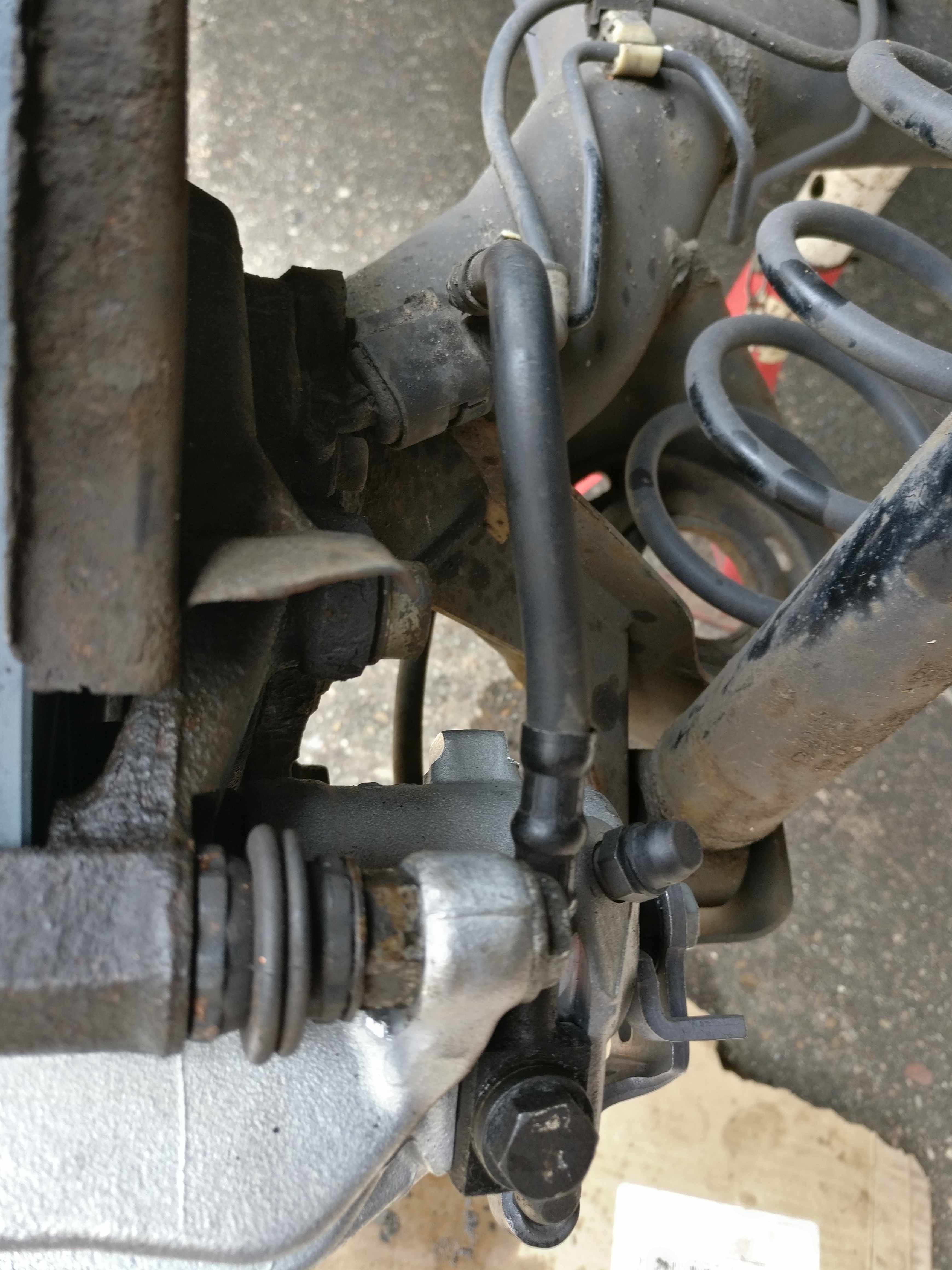

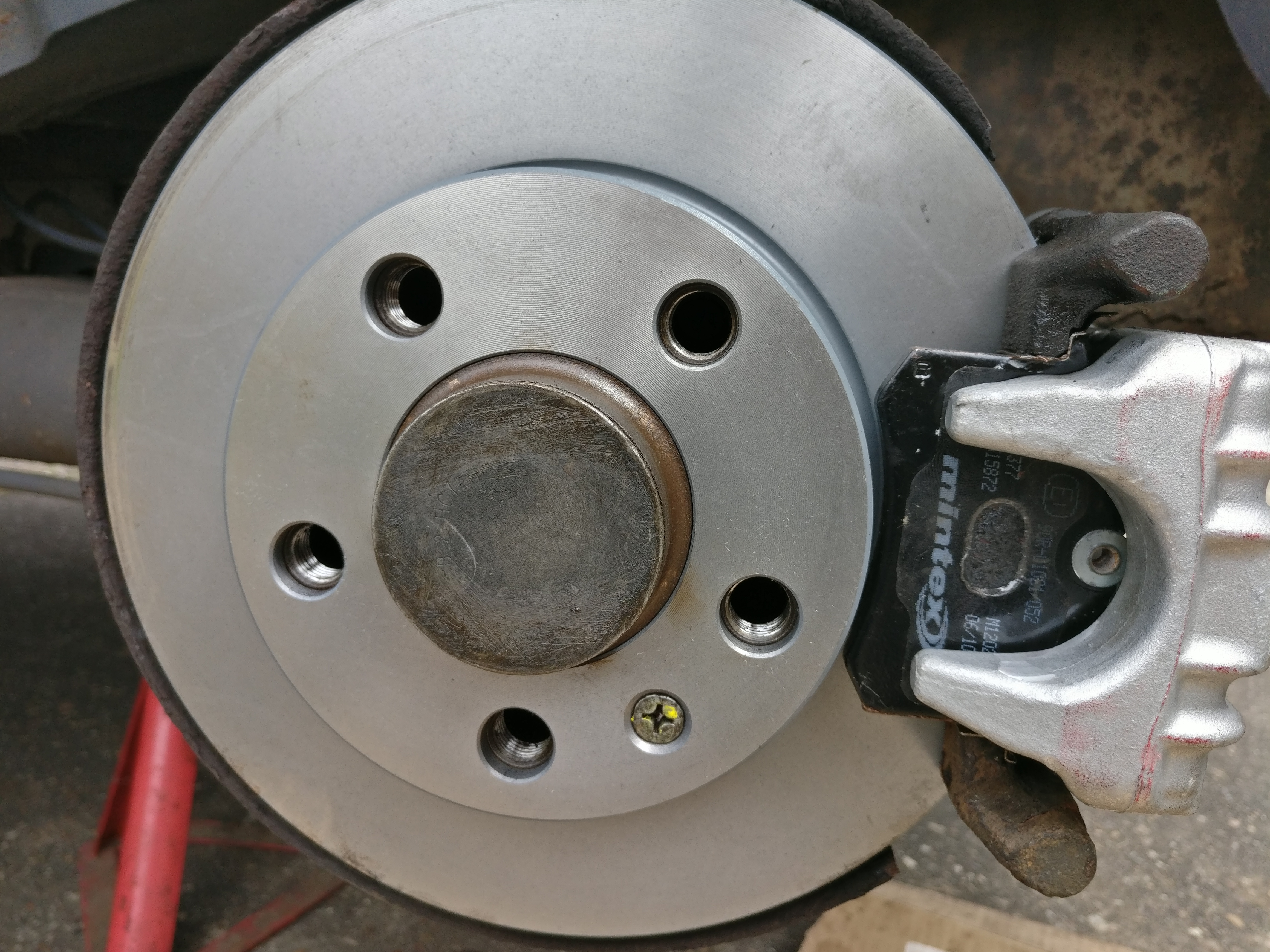

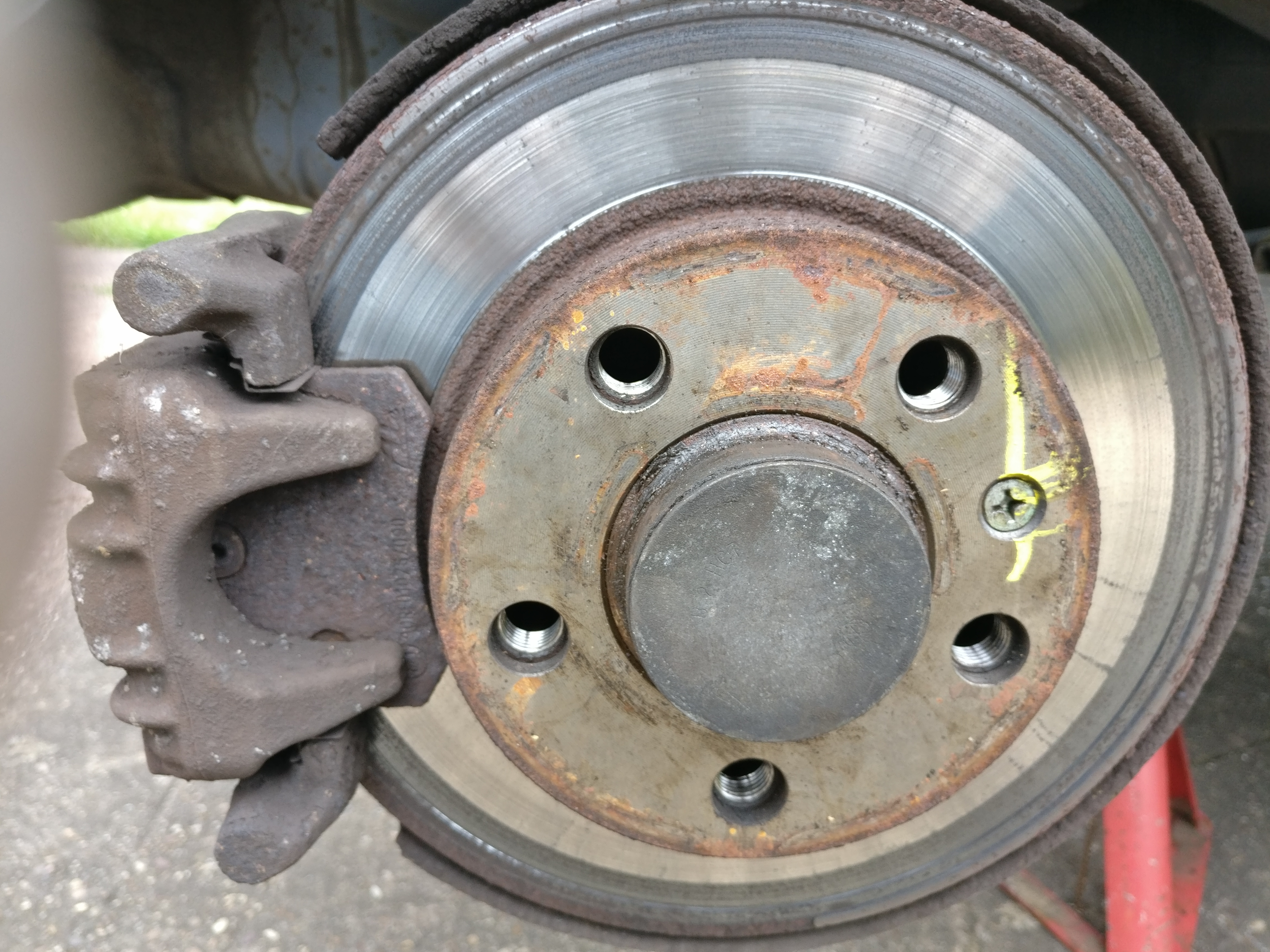

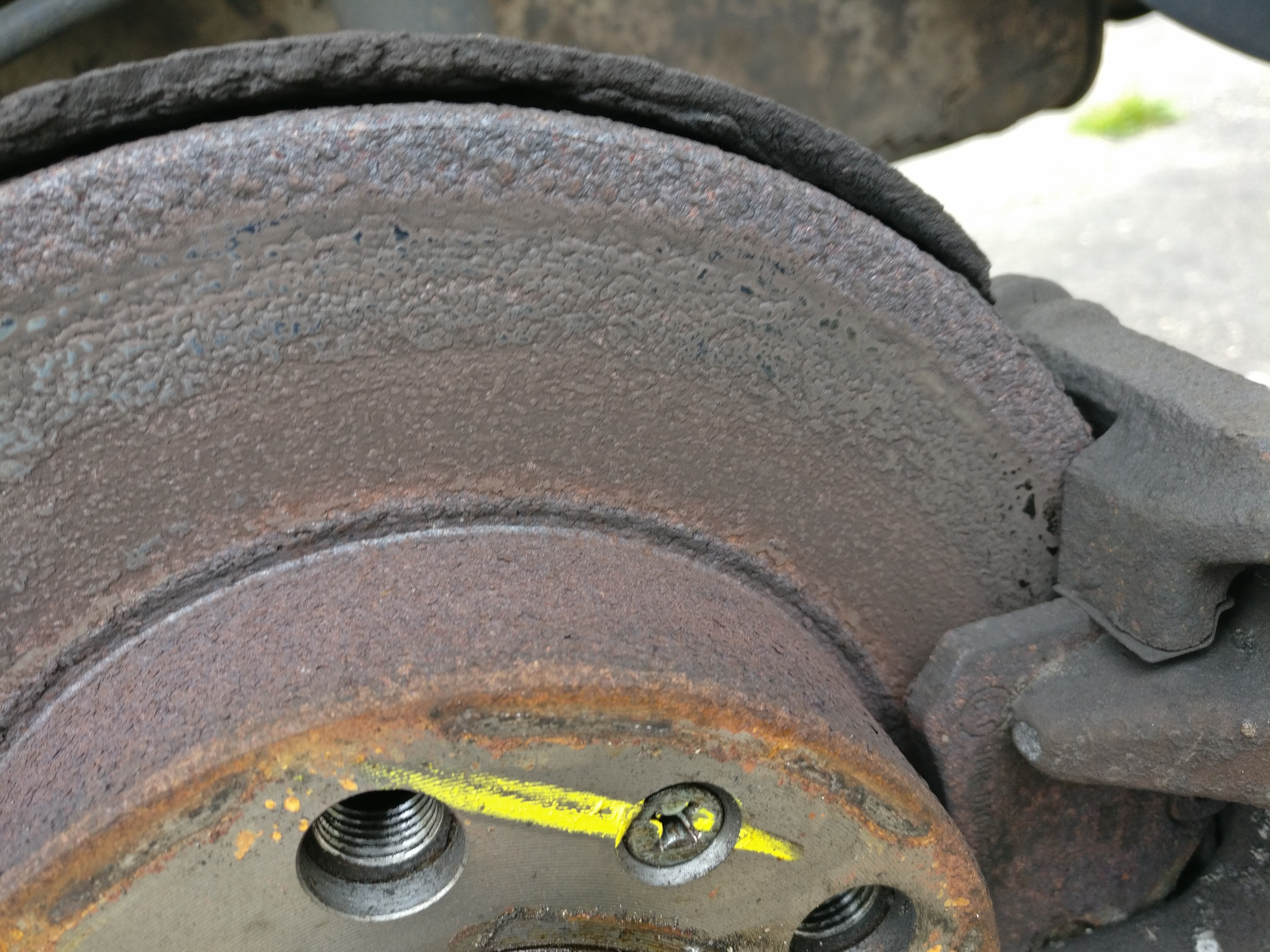

Just replaced the rear discs, pads, and calipers on my 2002 9n due to an MOT coming up next month. I'd planned to replace discs and pads for a long time but on the previous attempt could not rewind the piston, hence new calipers. Let's just say the old discs looked like they had been sitting in a farmer's field.

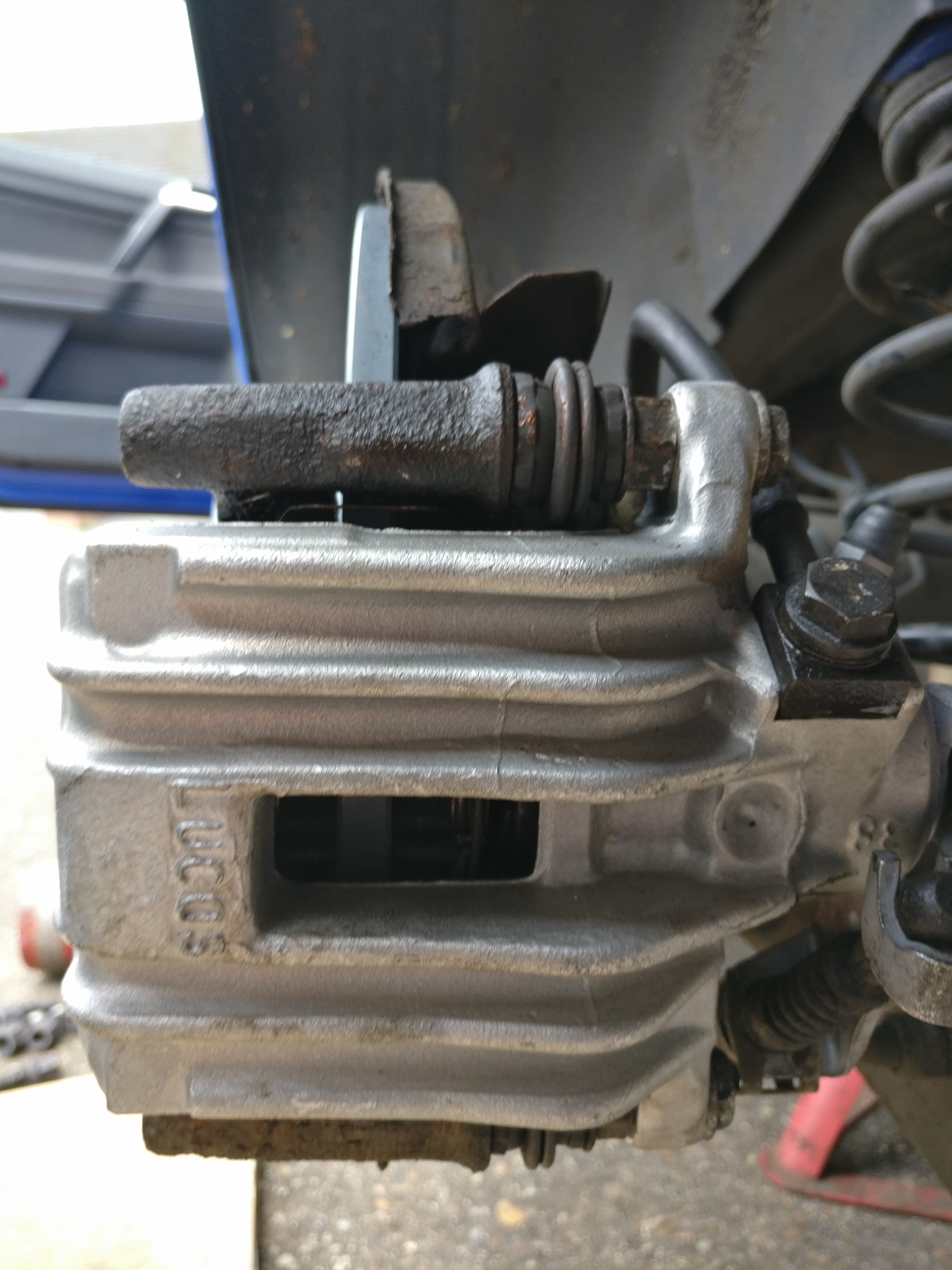

Used Febi discs, Mintex pads (no wear indicator), and TRW/Lucas calipers. One of the caliper sliding pins had seized up so had a delay to proceedings. Got it on the bench with some penetrating oil and manipulated it until loose. The pin was corroded. It looks like whoever did the job previously did not correctly refit the rubber boot, enabling moisture penetration. Other than that it was a straightforward job. Also flushed through some new VW spec brake fluid as I was not sure how long the old stuff had been in there.

I have never had trouble with these guide pins, I have never ever done anything other than checking that these slider/guide bolts do slide, it might help to grease them with silicon grease as that stuff does not annoy the rubber gaitors - that is what I do with the front guide bolt at every brake service.

The slide pin problem was on one side only. I'm pretty sure it was due to the boot fitting.

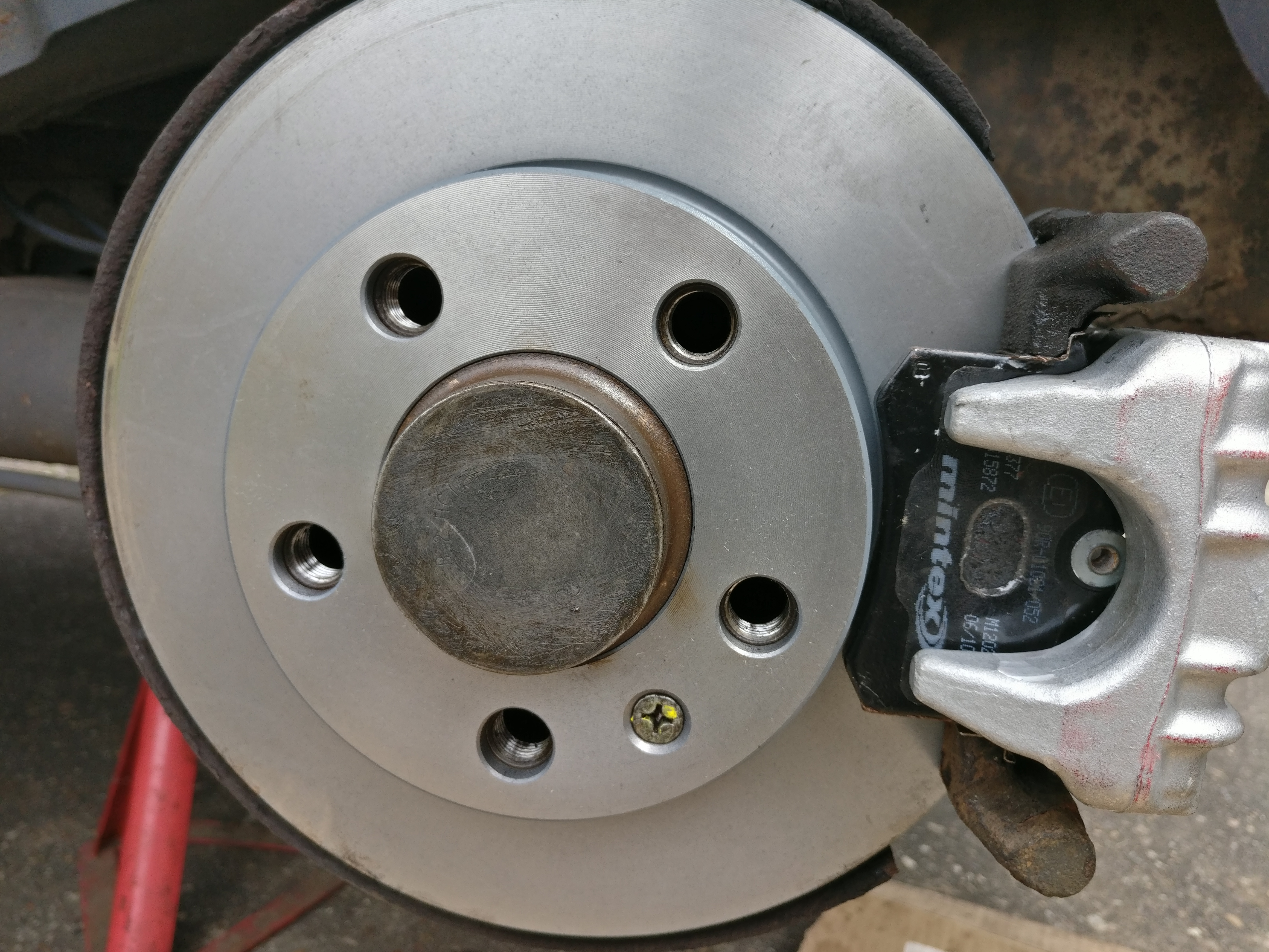

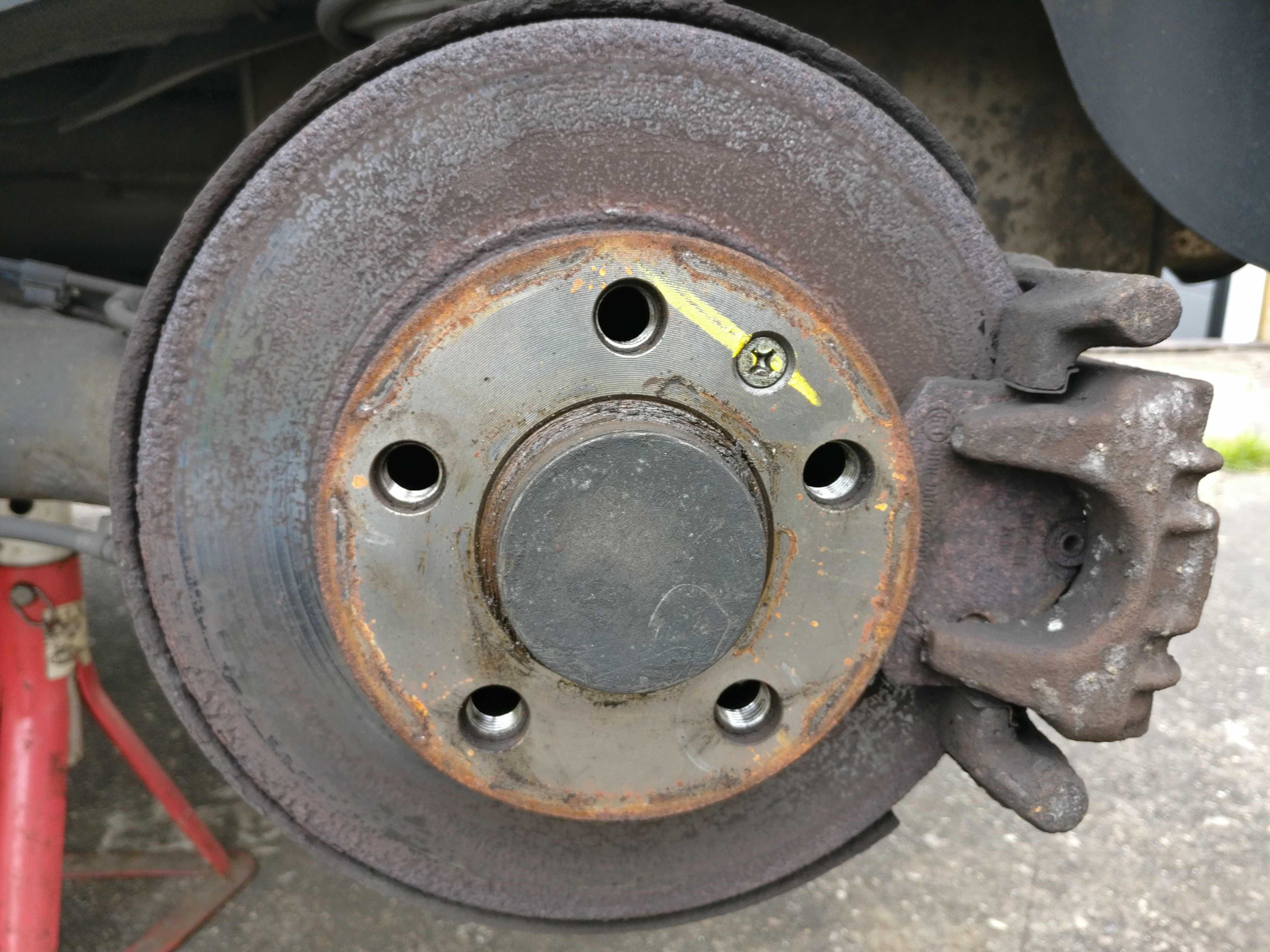

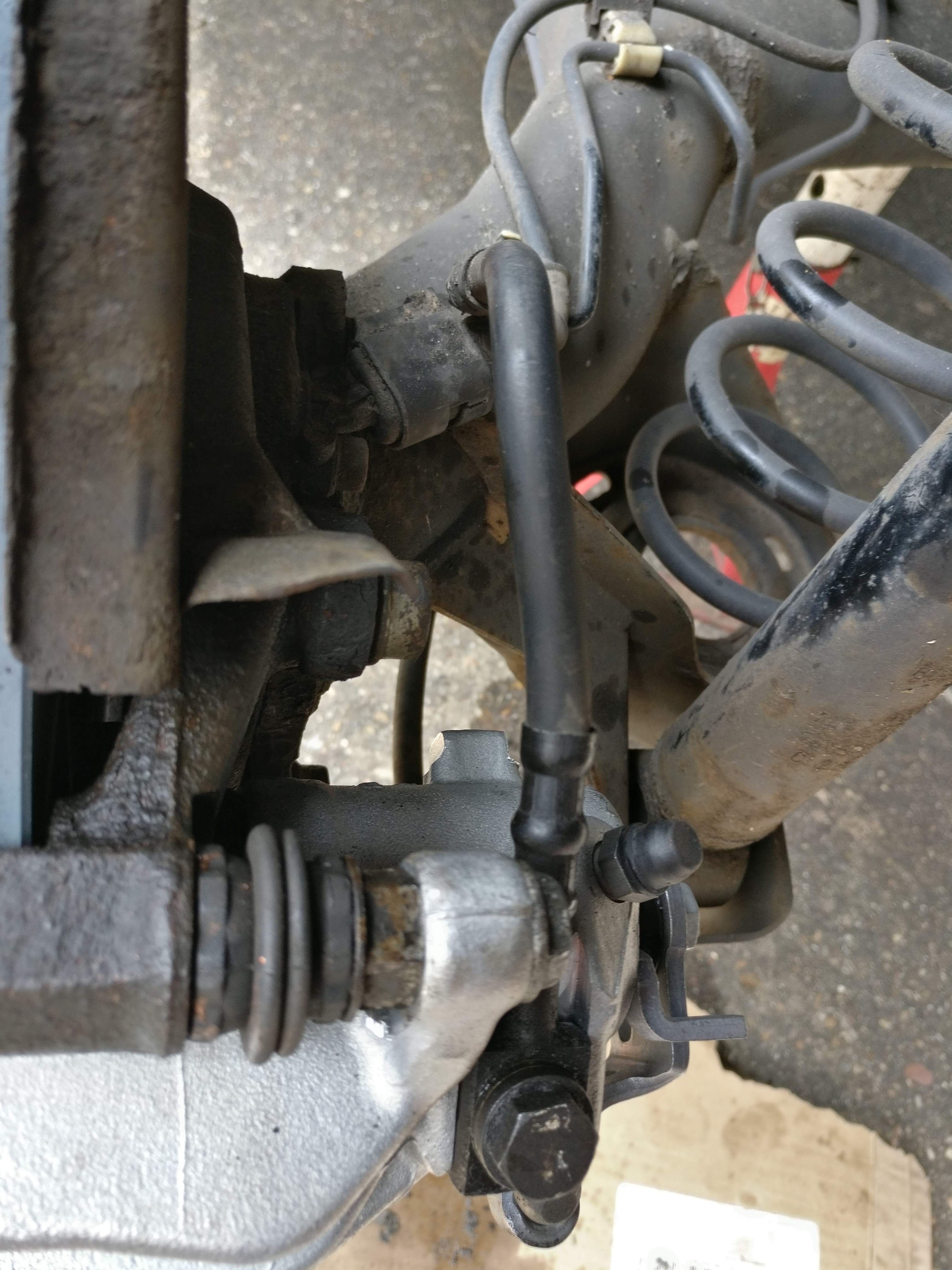

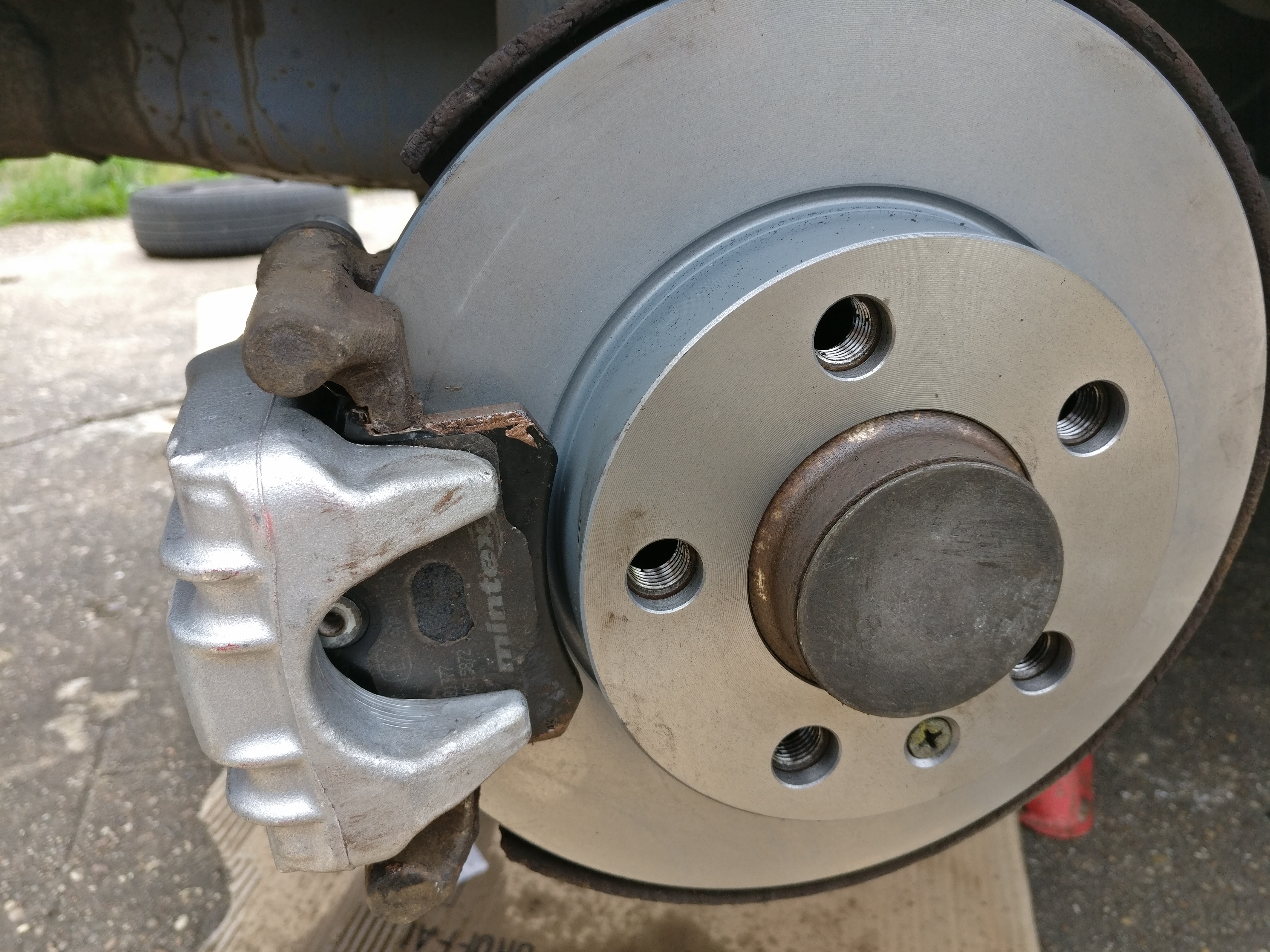

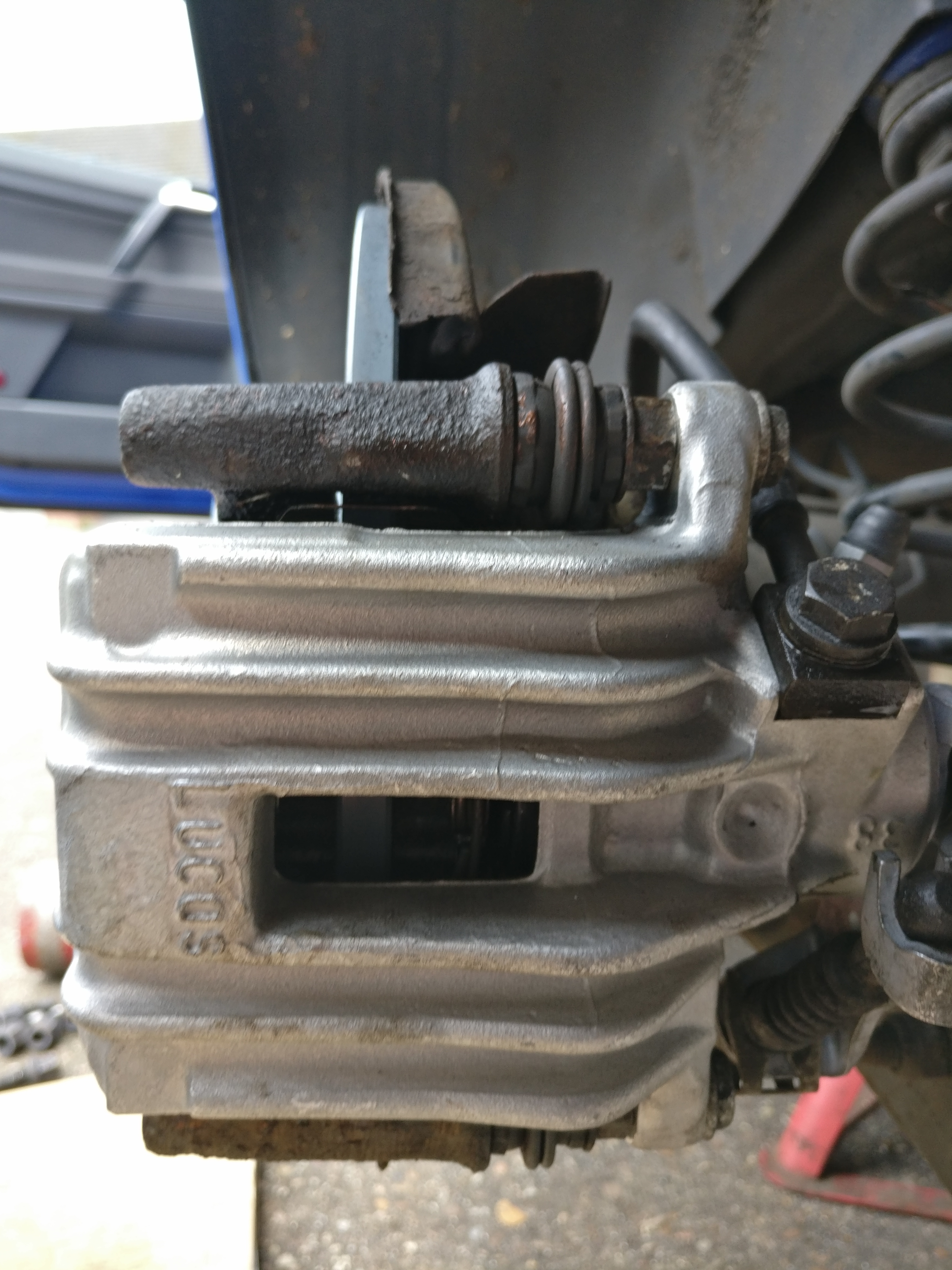

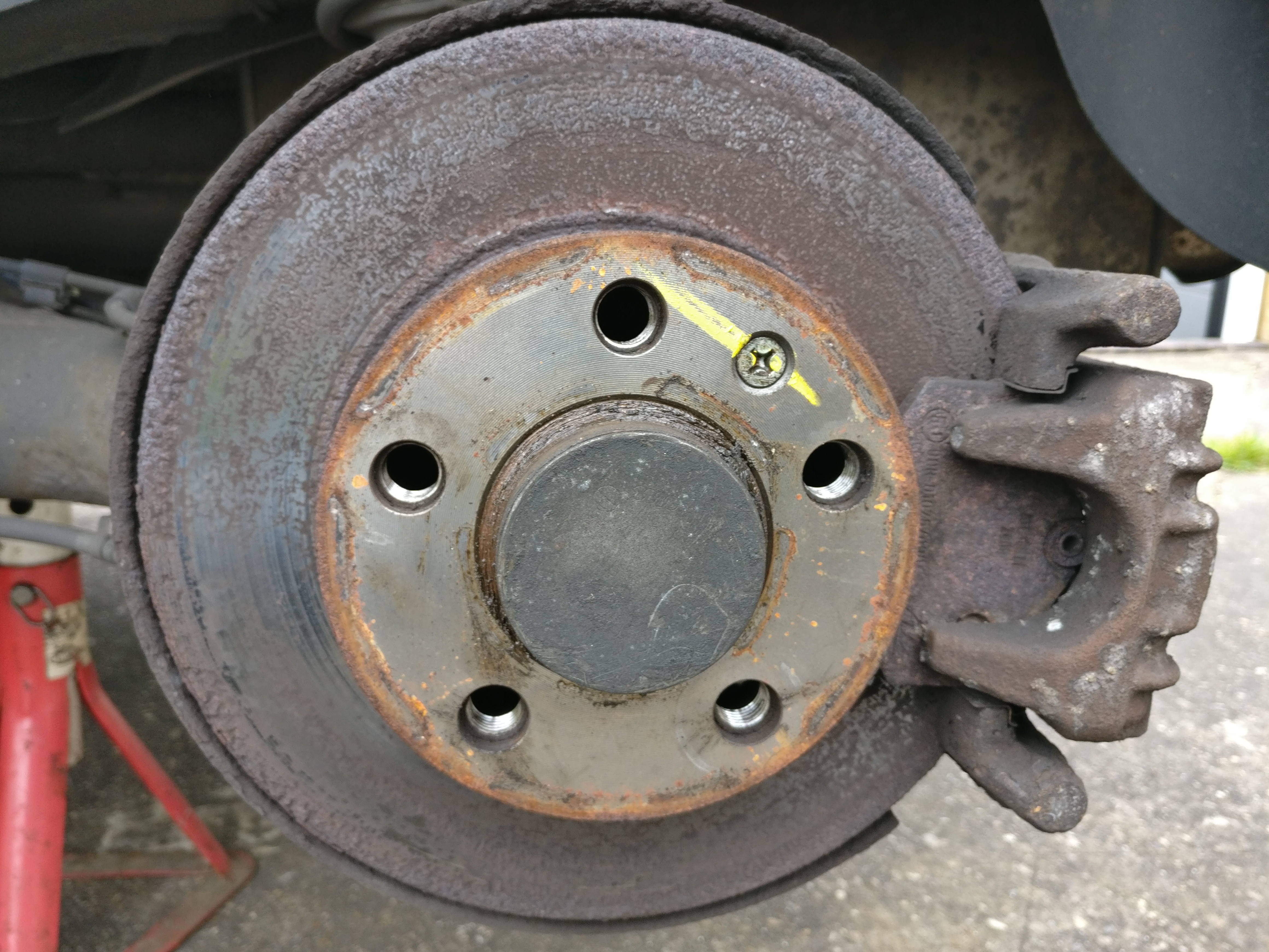

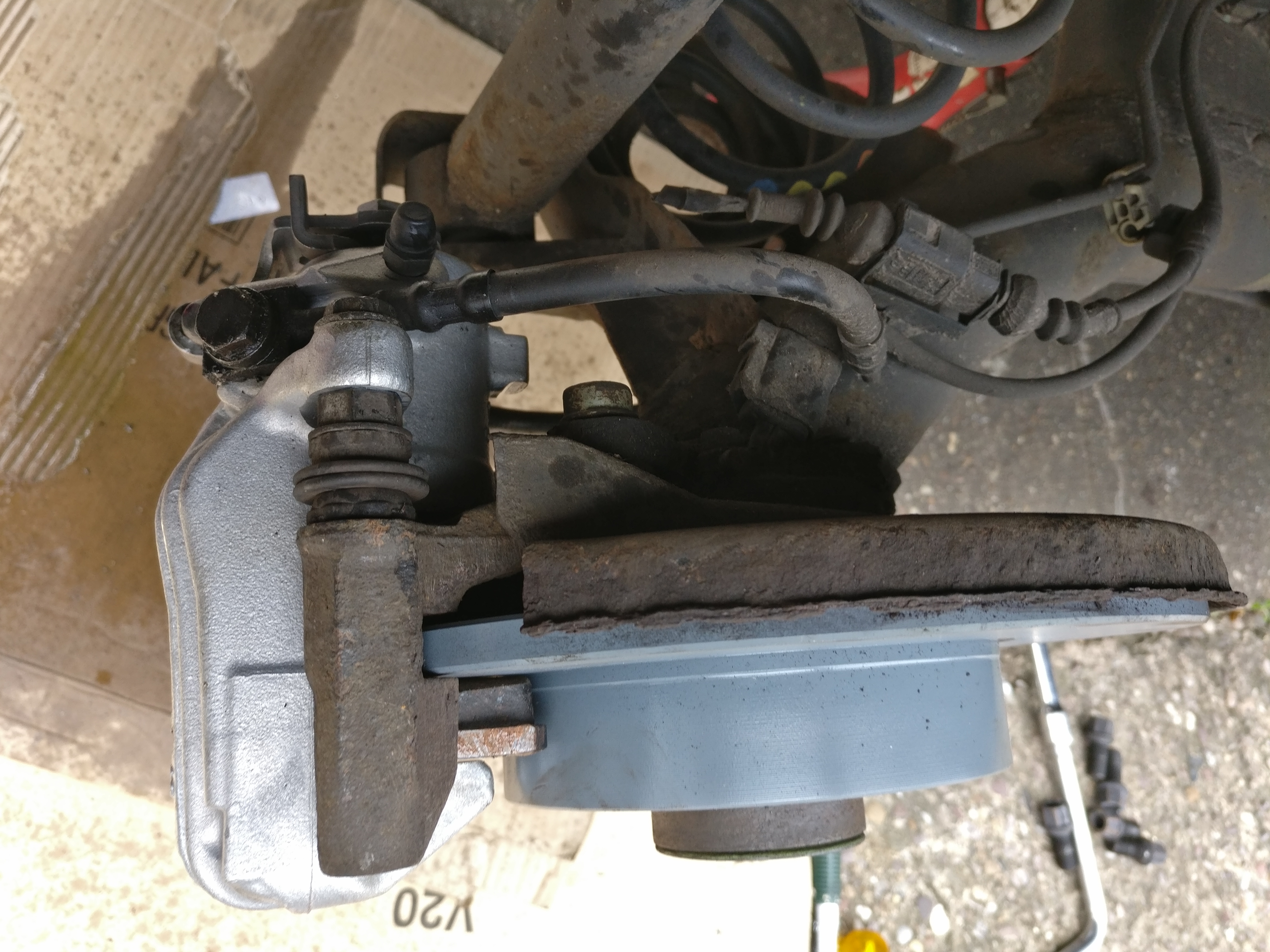

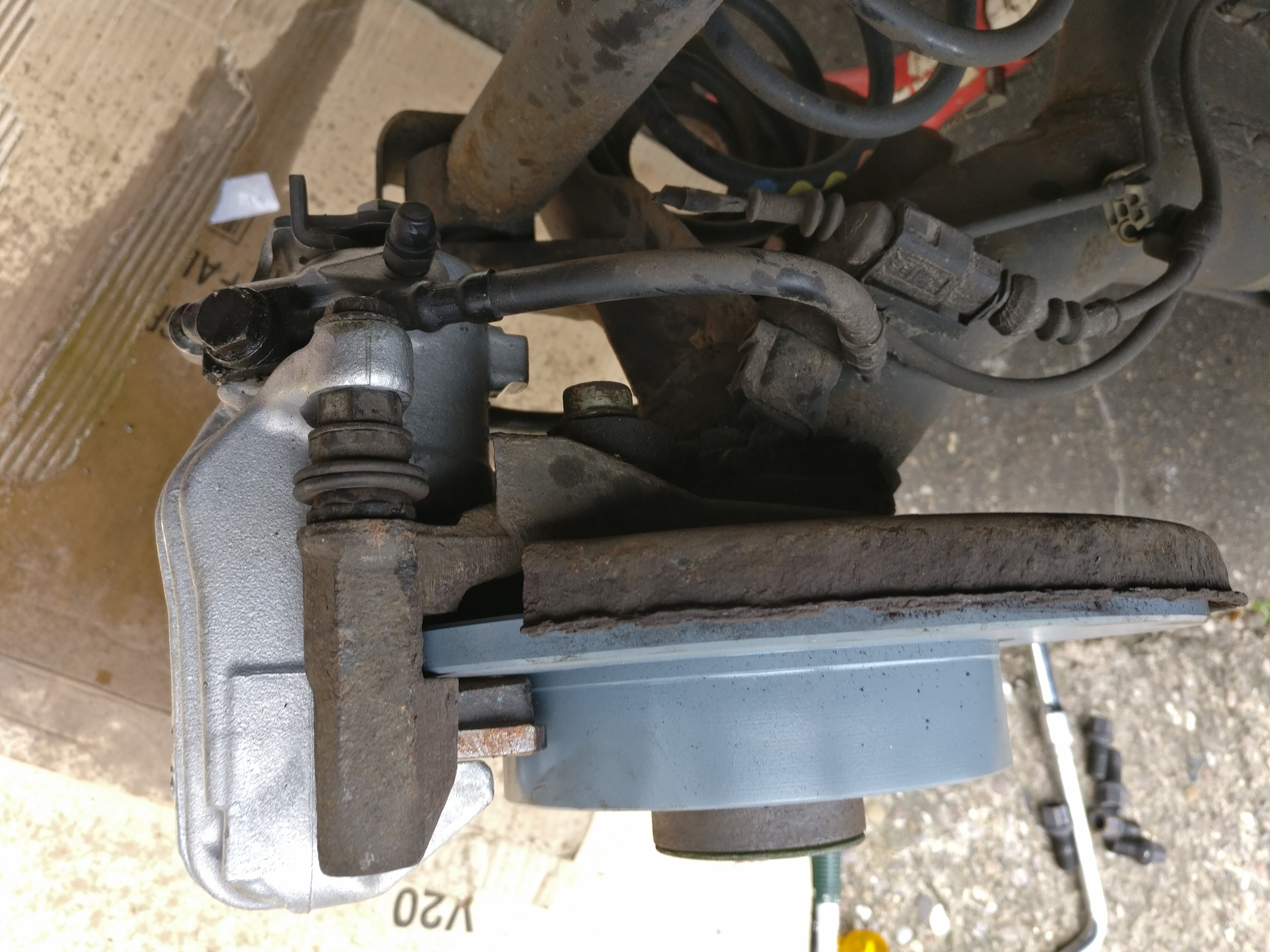

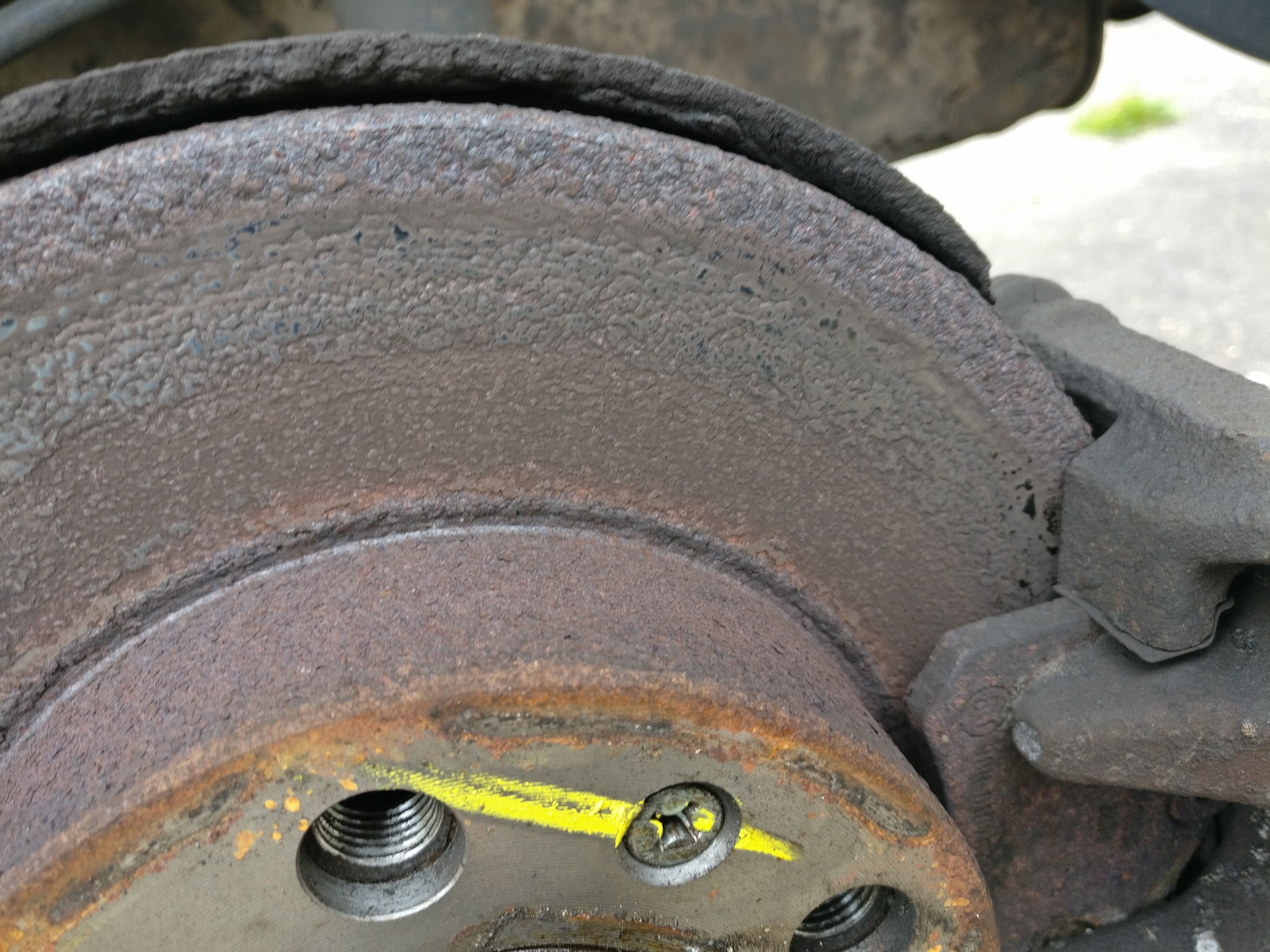

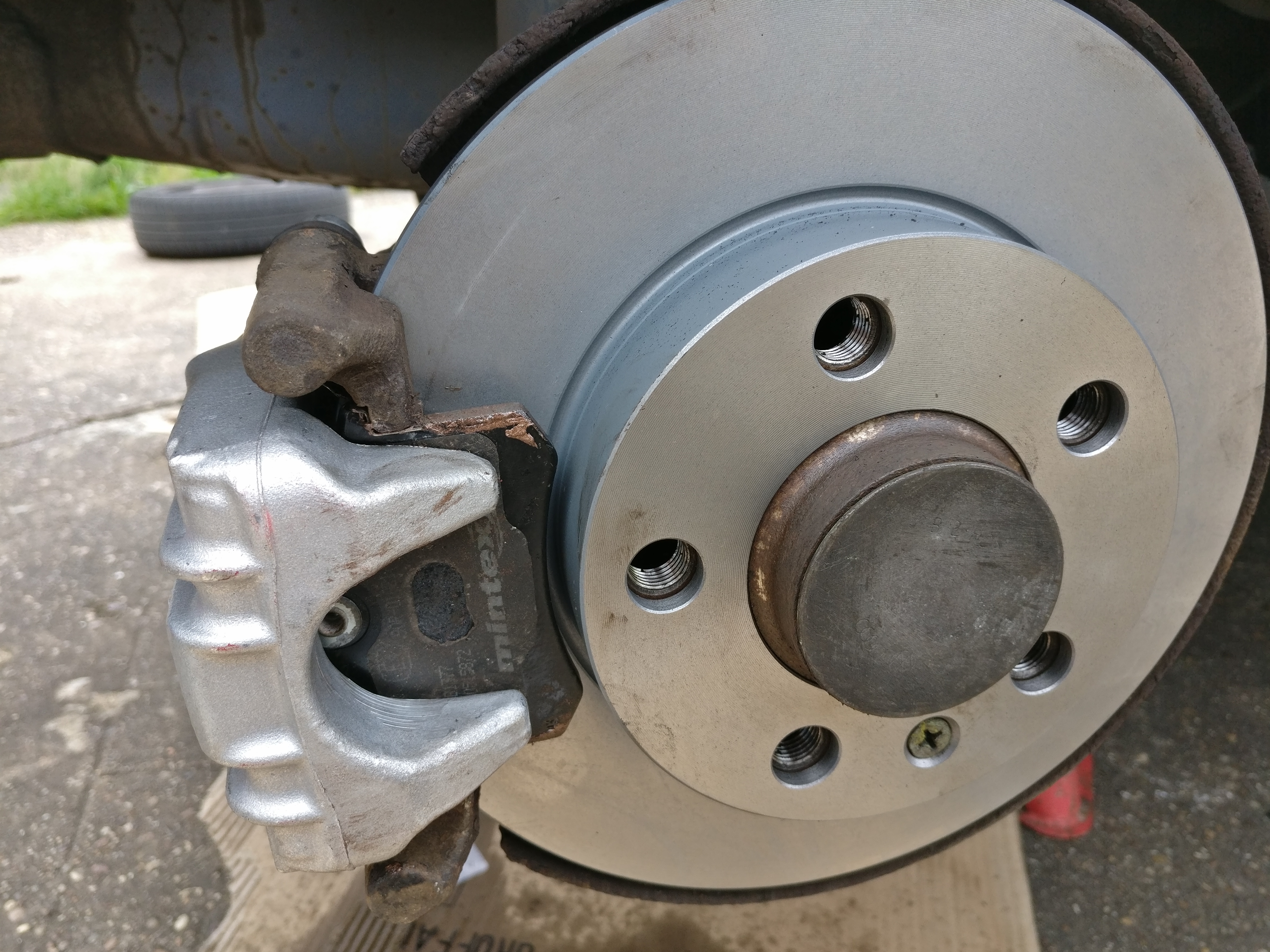

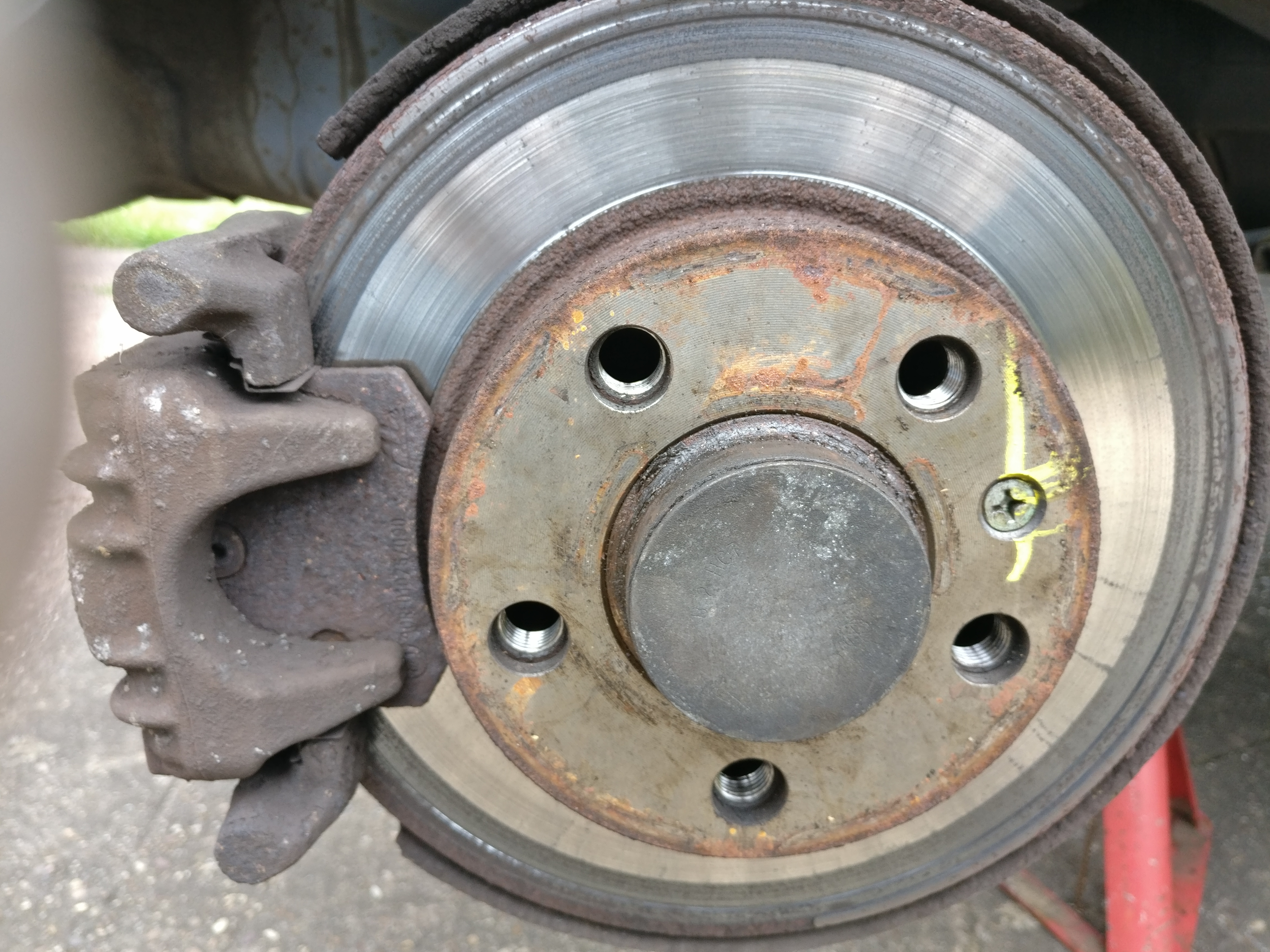

Here's a few pics of the old and the new:
Old

Ah, that left side disc does look a bit nasty!
Avery good plan to replace both sides at the same time, I only replaced one side on my previous car a 2000 Passat 4Motion and I found that possibly the thread pitch on the handbrake operating screw was different on the new one, which meant that I had to readjust the cable on one side as on that car there were 2 handbrake cables and no equaliser yoke, so one side needed to be binding slightly to get both wheels locked when the handbrake was on. Not so much an issue on the Polo with its equaliser yoke.

RUM4MO wrote: Sun Jul 21, 2019 10:05 am Ah, that left side disc does look a bit nasty!
I had to do both sides. The pads were almost like cigarette papers. Also the pistons were stuck.

Thanks for labelling which are the old and which are the new :lol:
