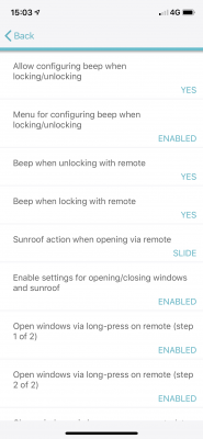

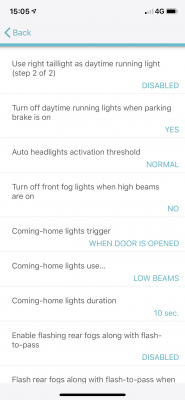

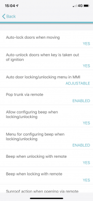

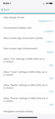

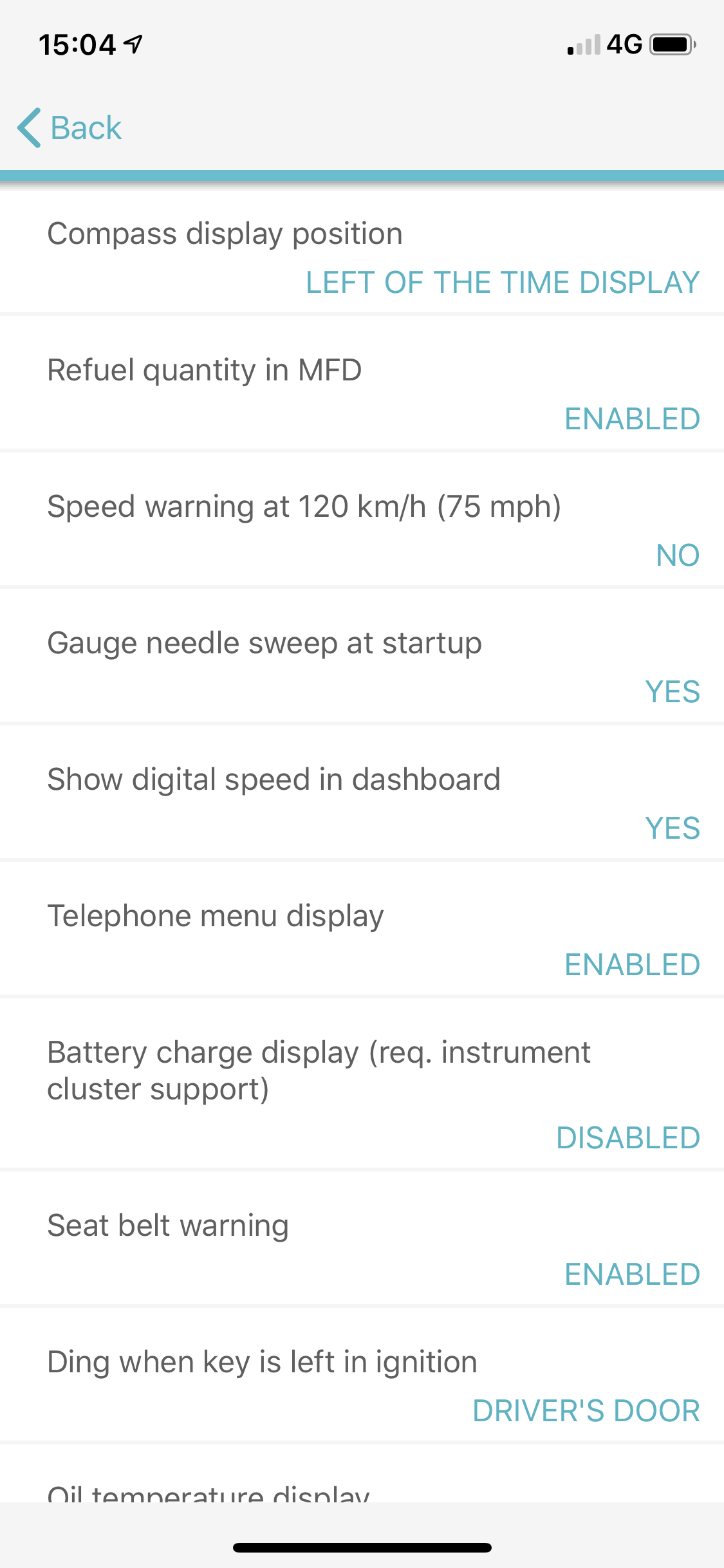

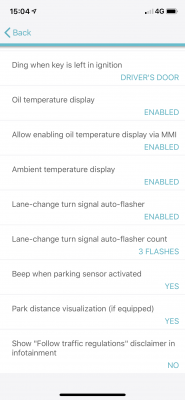

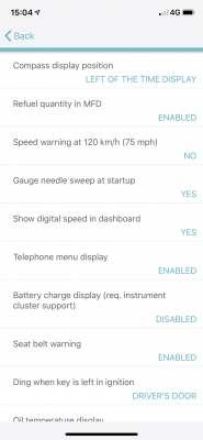

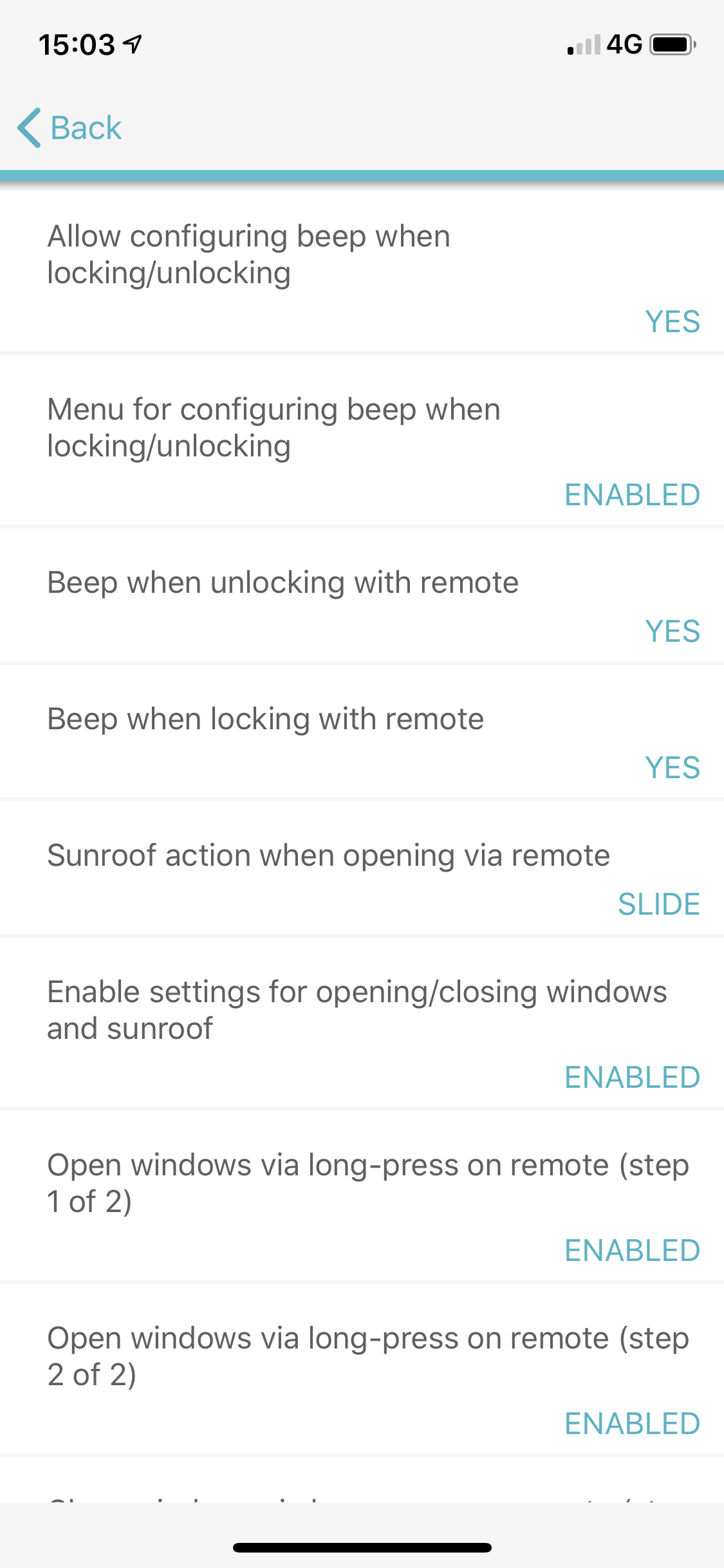

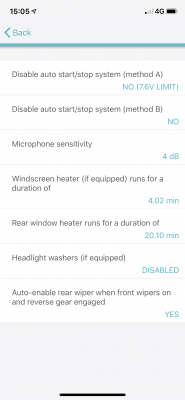

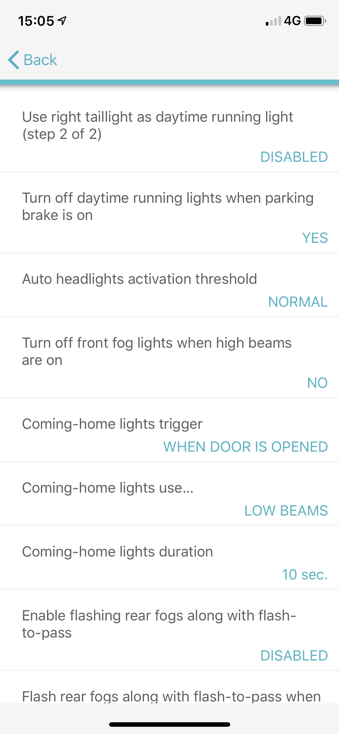

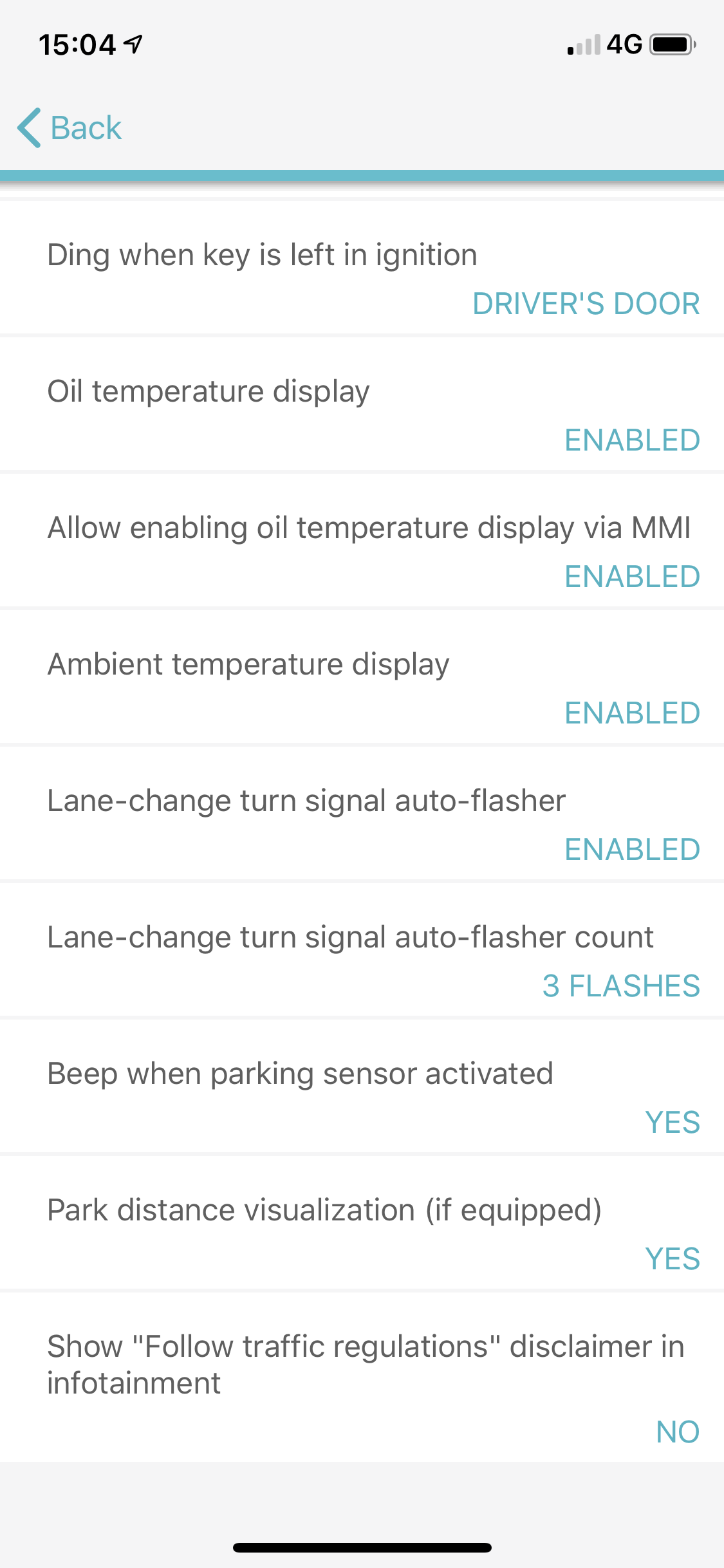

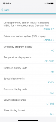

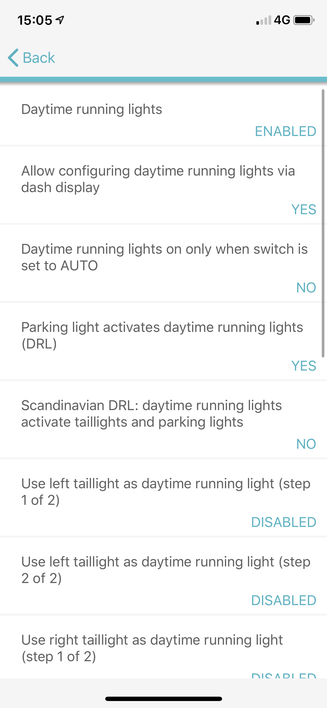

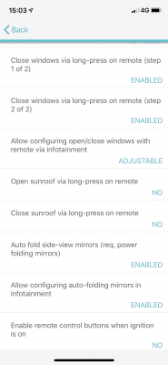

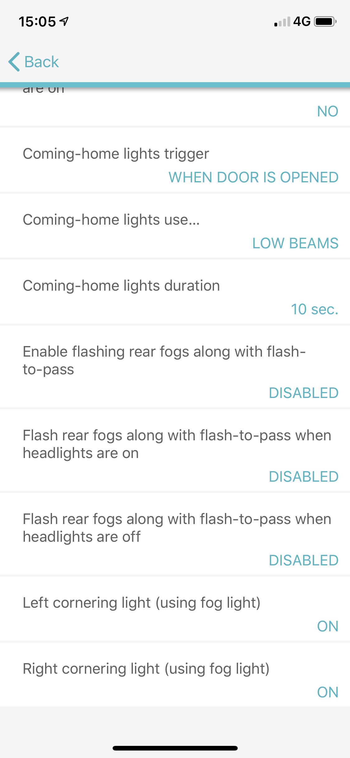

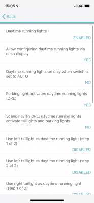

Hi there i hooked up the carista obd and i dont see any option for rvc ( Polo 6C 2017 )... yes obdeleven pro has long coding Which allows to to set camera options and park sensors.
here is what options the carista app displays:

Thanks for posting all the options massimo. i have a 13 reg BlueGT (6R) i might have fewer options then you.
If that is the case.. i don't believe i can disable the reverse camera with Carista. I might have to spend the extra bucks and get the OBDeleven instead..
Unless anyone knows any other option..
