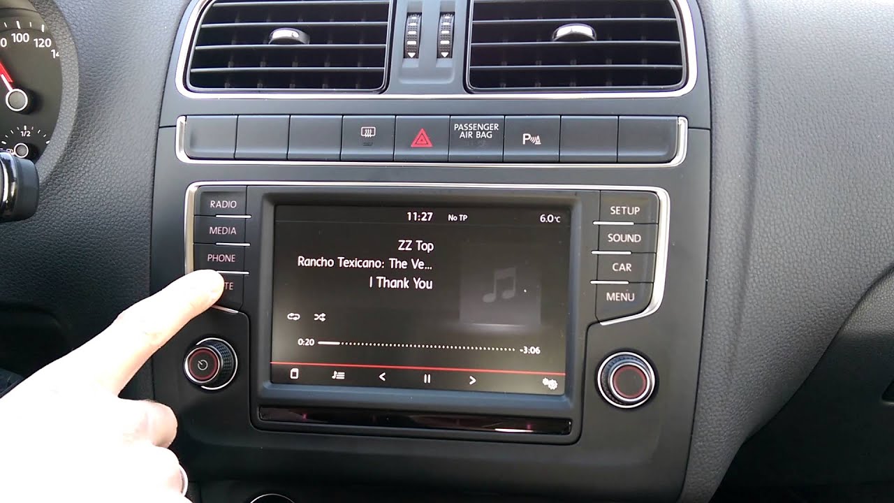

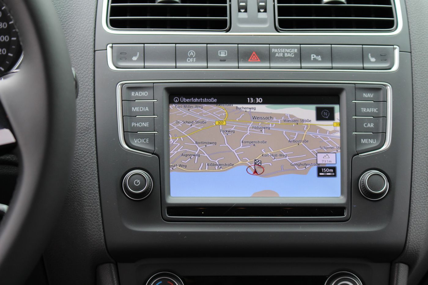

I’m a little confused - you’ve said your infotainment unit is the Discover Media unit but you then say it didn’t have sat nav as an option, which suggests your car has the Composition Media (non Sat Nav) unit.
The standard Polo GTI infotainment unit is the Composition Media; this doesn’t have sat nav and is the one that’s fitted to the Polo GTI at the factory if the first owner didn’t pay for the upgraded Discover Media infotainment unit. Visually, you’ll know if you’ve got the Composition Media unit as it’ll have a ‘Nav’ button to the right hand side of the screen.
As far as I know, it’s not possible to add the VW Sat Nav maps to the Composition Media unit, although if your infotainment unit has App Connect (or is App Connect compatible), you can use an app such as Google Maps or Waze on your phone and display the maps on your infotainment unit screen.
Here’s the Composition Media unit; And here’s the Discover Media unit with the ‘Nav’ button to the right of the screen;

Thanks for the reply. Makes sense to me . I don't have the Nav button and thought I had the Discovery Media Unit as that is the title on the front of the manual in the owners pack.
