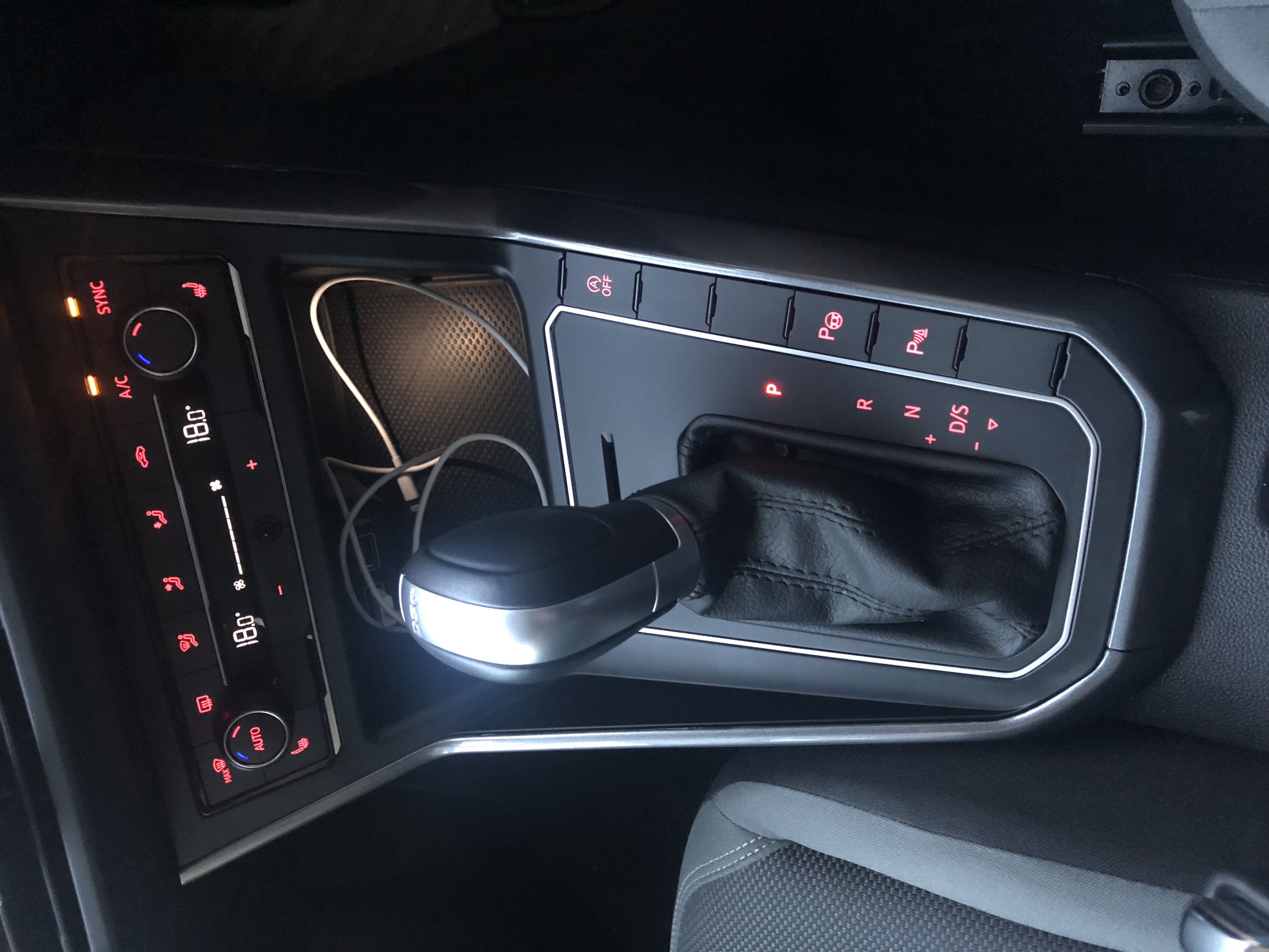

Added this today....Park Assist 3.0

Scotty_boy vw wrote: Wed Sep 04, 2019 3:16 pm Added this today....Park Assist 3.0
Scott
Could you add a guide? I've already got the parking sensors and camera...would love Assist
