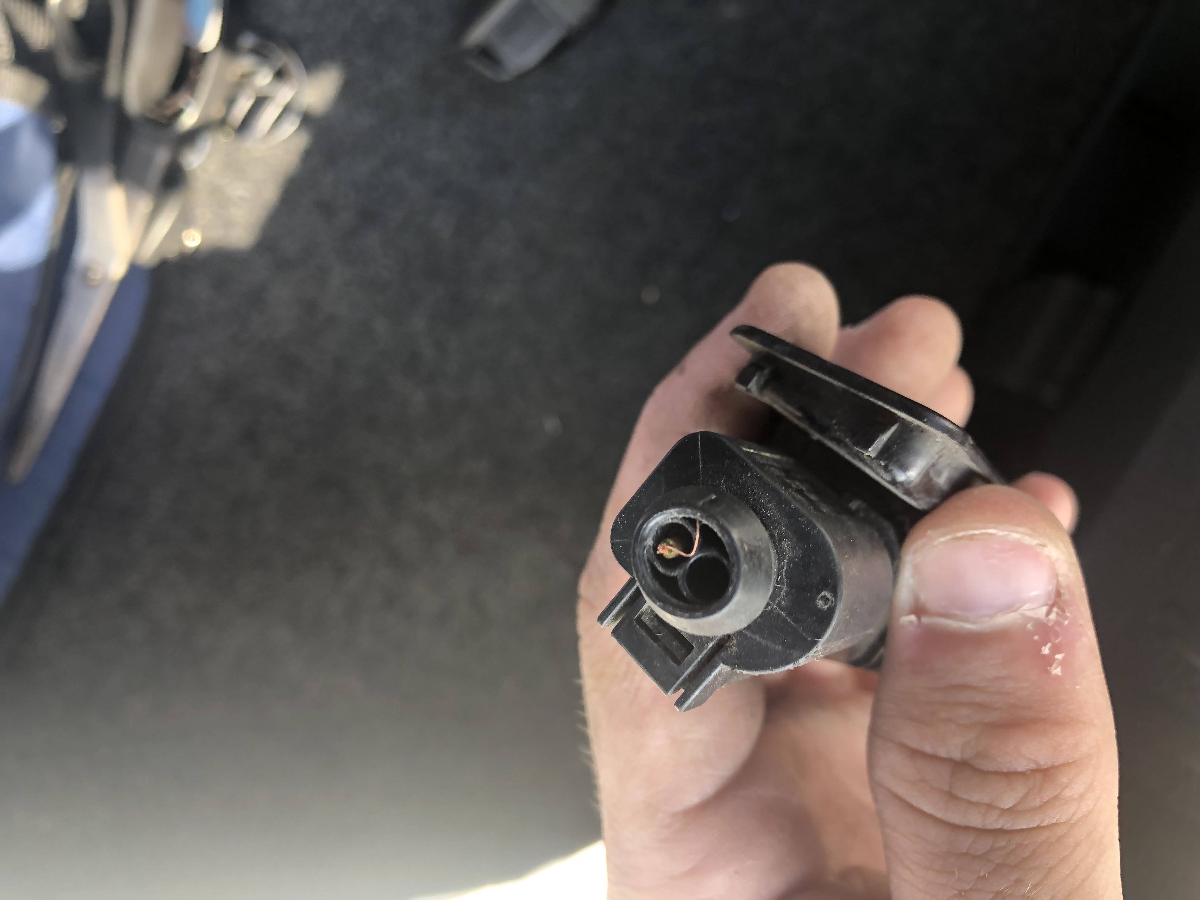

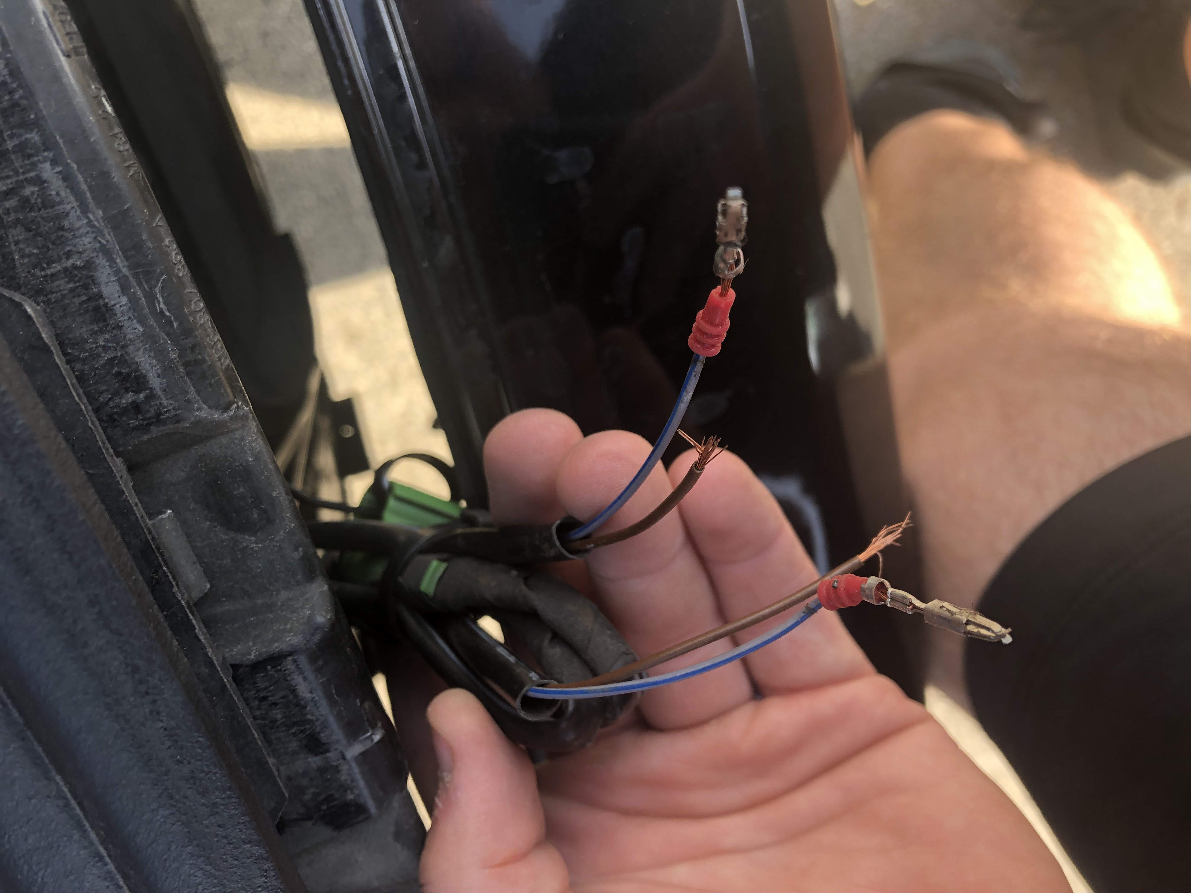

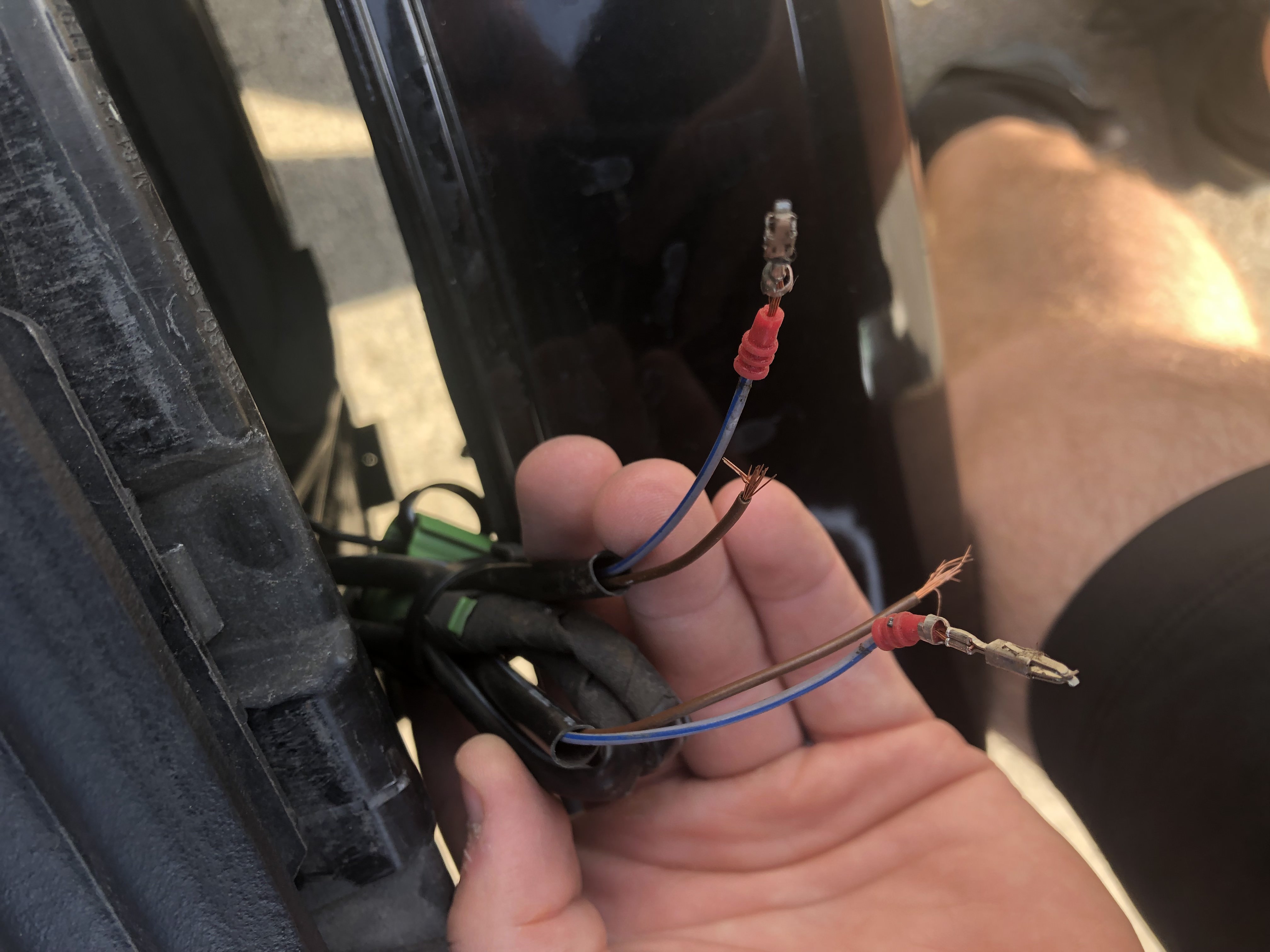

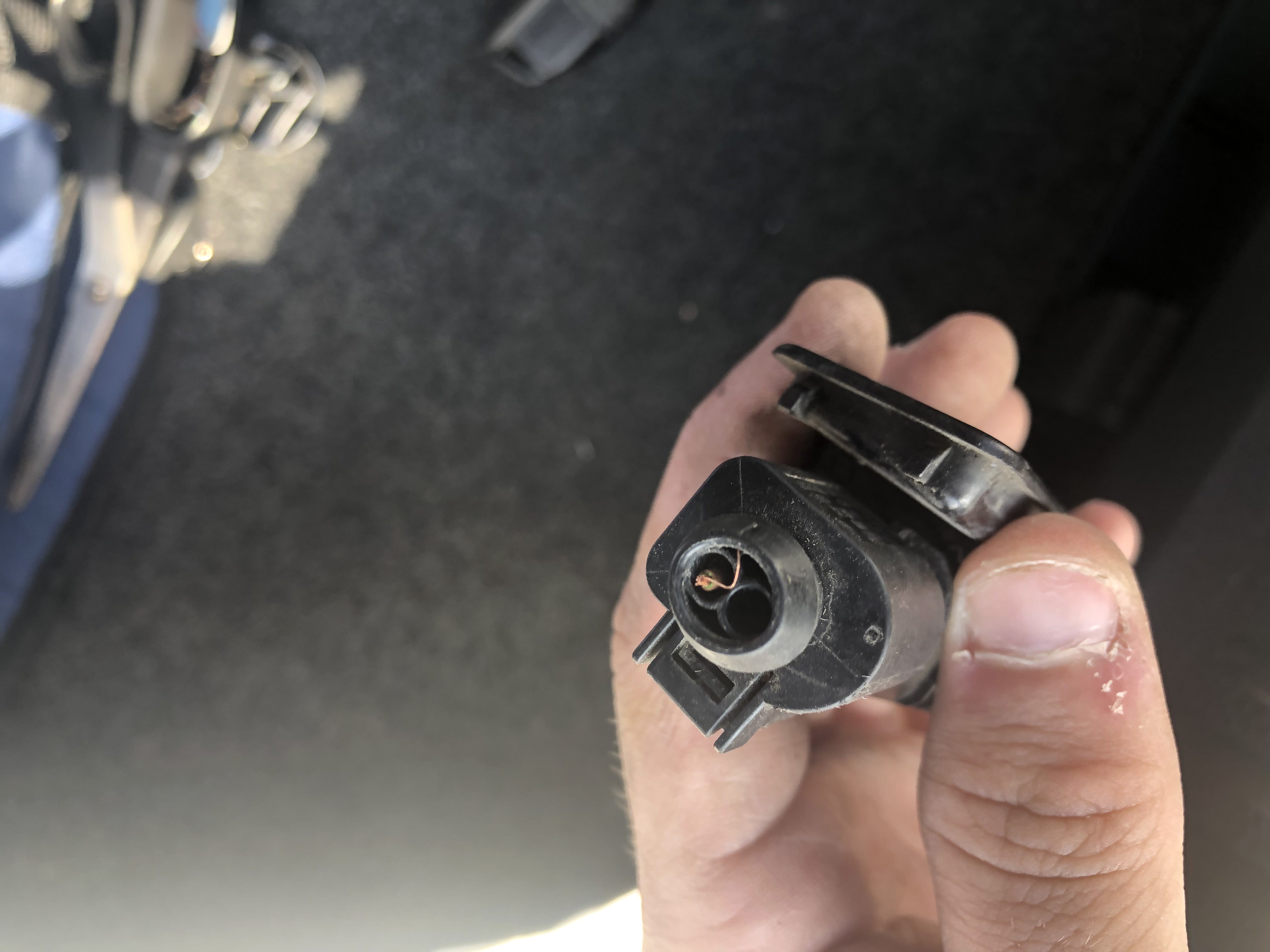

Hey gang,
I've recently had my 2010 Polo reversed into in a car park, which has led to my rear bumper being ripped off because they pulled forward after reversing in with their tow-bar.
This has led to my number plate lights being ripped off the wiring loom.
I've attached images, however as you can see it doesn't look repairable.
Will I have to buy new kits for the lights and re-fit or can this be repaired? Let me know.
Thanks lads.

You can remove light from socket,depin the socket if possible recrimp or resolder the pins and you can reuse the lights
Posts: 6687
Re: Polo 6R - Rear Number Plate Lights
I agree
