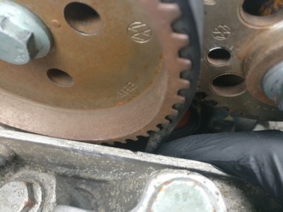

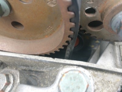

As I set out to have a look at the injectors this morning out of curiosity I pulled of the top belt cover. It seems there is too much play in the main belt as it can be deflected a cm or so just under the pulley using finger pressure. It's possible that the cam belt tensioner has failed or come undone. Would this be a plausible explanation for overfuelling? If its jumped a tooth would valves be damaged?

Re: MOT fail (position/fog lamp, brakes, emissions)
Seems like a fair bit. Cam tensioner may not be working correctly. Yes if the timing was a tooth out, that could cause an overfuel scenario
