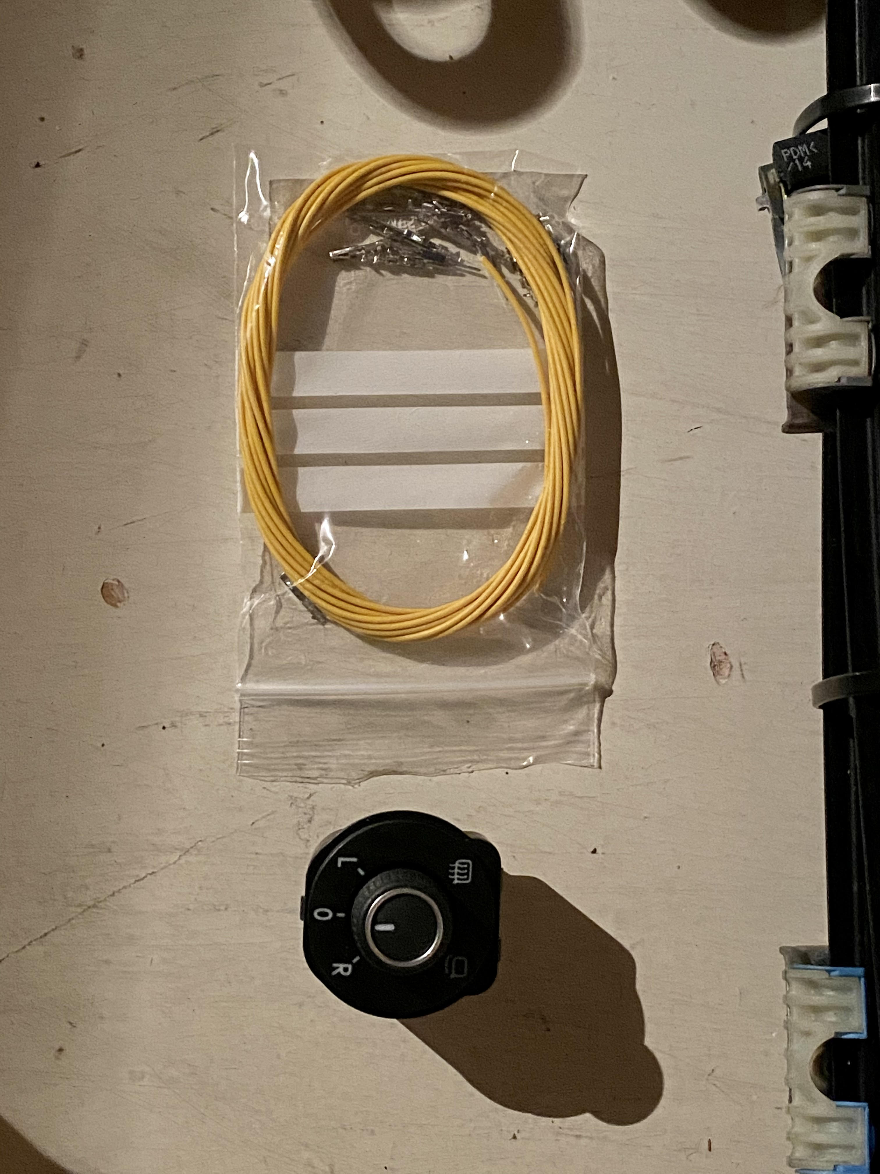

I'm trying to get my power folding wing mirrors sorted, as since fitting the new wing mirrors, the switch and window regulator motors, not only does the new folding function not work, the electrical adjustment and heating do not work. I have these wires to add (see attached photo), but where do they need to be fitted? It's a total nightmare trying to find anywhere to do an retro fitting and coding work in UK, as they either don't have the knowledge, they are too busy, too expensive (£100+ an hour) or just don't want the work or mess you around/ignore you!

Hi,Aquavalver wrote: Tue Jul 02, 2024 3:03 pm I'm trying to get my power folding wing mirrors sorted, as since fitting the new wing mirrors, the switch and window regulator motors, not only does the new folding function not work, the electrical adjustment and heating do not work. I have these wires to add (see attached photo), but where do they need to be fitted? It's a total nightmare trying to find anywhere to do an retro fitting and coding work in UK, as they either don't have the knowledge, they are too busy, too expensive (£100+ an hour) or just don't want the work or mess you around/ignore you!
I would recommend using this post for the wiring, as it is what I followed when I did my retrofit.
I would suggest trying to find someone with VCDS locally to do your coding, maybe on the forum, or maybe with a VW specialist.
