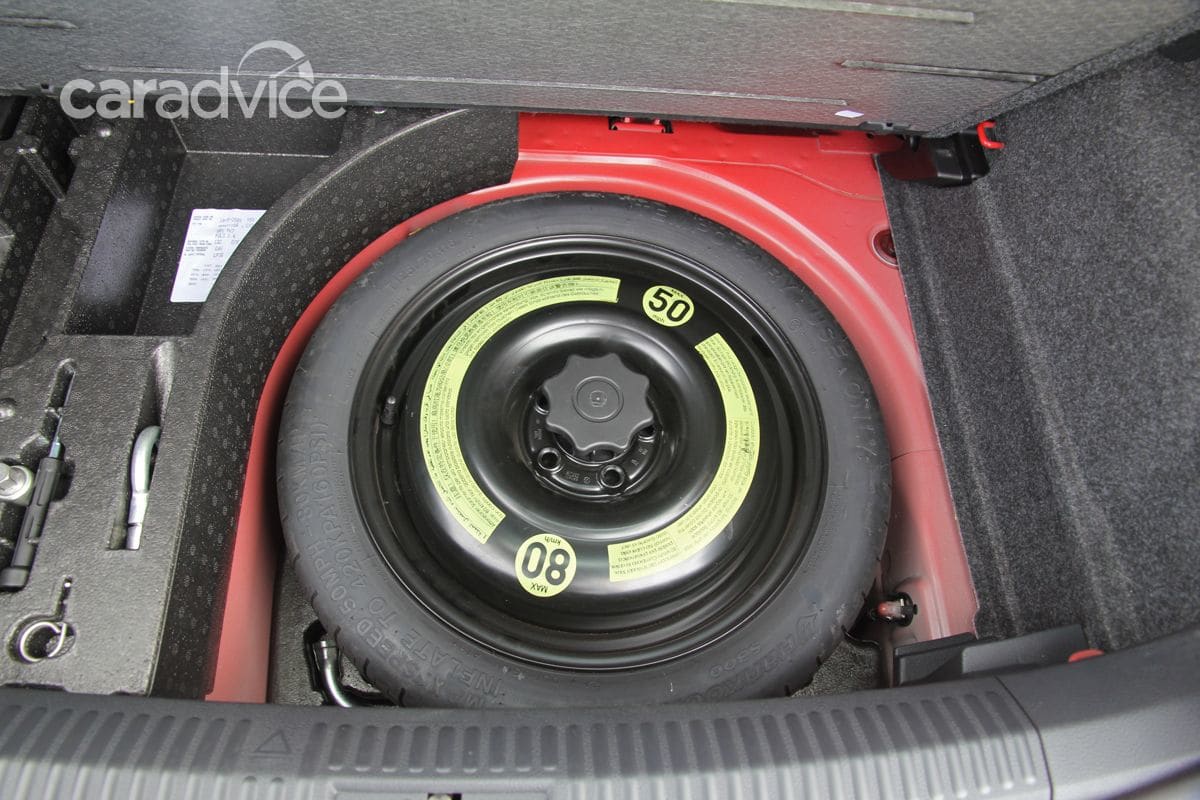

Can anybody help me with a list or picture of the spares should be in the boot of a 6C 2017 GTI as standard?
I believe mine is supposed to have a space saver and a jack!

You should have the following spare wheel kit under your boot floor in your GTI;
- space saver spare wheel
- jack
- locking wheel bolt adapter
- tool to remove the black plastic wheel bolt covers
- box spanner
- threaded towing eye bar
- screwdriver
- two moulded polystyrene storage trays for the above tools - one that sits to the left of the spare wheel well and another that fits in the bottom of the spare wheel well around the base of the battery.

Hi SRGTD,
Thanks for the reply.
Looks like I have a fair amount missing from the boot!
The retainer for the spare looks quite different in mine to the example provided.
Do you know if the picture you linked is from a GTI or a lower specced 6C polo? At a guess the wheel size is the only difference.
Posts: 3830
Re: 2017 Polo GTI - spare wheel/accessories
Looks like you only have the box spanner and the locking wheel nut adapter.
The picture was from a 6r Polo GTI, so the pre-facelift model with the 1.4 twincharger engine, but the spare wheel and tools should be the same as the 6c GTI. It’s quite possible that VW changed the design of the plastic spare wheel retainer at some point - sorry, can’t check mine just now as I’m not at home and my car is!
The space saver spare in my 6c GTI is an 18” space saver with a 125/60 R18 tyre.

Is it me or is an 18" 125/60 space saver an odd side? I can find lots of 125/70 on eBay, but yet to locate the exact size needed.
Also what do you think to this:
https://www.ebay.co.uk/itm/2016-Volkswa ... 3843442838
Looks about right for the parts missing...
I think the jack actually goes underneath the spare wheel. A first aid kit goes where the jack is in this picture.
Posts: 3830
I don’t know if an 18” space saver with a 125/60 tyre is an odd size or not. It’s probably 18” to fit over the larger GTI’s brakes, and the tyre and 125/60 so it’s pretty much the same rolling radius as the 215/40 tyres on the 17” road wheels.
I don’t think that the equivalent performance models of the Seat Ibiza or Audi A1 had a spare as part of standard equipment (they had a can of sealant), although I think they might have been offered as an extra cost option, so you might be able to find an 18” space saver from an Ibiza or A1 with a 125/60 tyre. An 18” space saver from a later model Golf, A3, Leon or Octavia won’t fit as they have a different bolt pattern (5x112) to the Polo (5x100).
You could also try breakers yards near to you to see if they’ve salvaged any from Polo GTI’s that have had frontal damage (so the spare in the back wouldn’t have been damaged).
The tool kit looks to have all the items that are missing from your car. And yes, the jack is under the spare wheel in my car.
