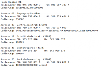

I have the problem, that my kessy unit and ELV has no errors, but my car wont open and close via door handle. BCM is 7E0 937 090 A and Kessy is coded.
Do you have an Idea? Do you need more information?

An autoscan would be nice.

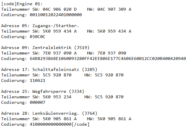

Maybe a Problem with BCM?
Or a Problem with adaptations.
I can not upload a scan. The Forum said this is spam. Maybe cause of german words inside.
I uploaded a compact picture. Maybe it helps.
Posts: 6685
Re: retrofitting kessy to the Polo 6R
You can copy paste the text into the post

Nope =(
I always got "Forbidden. Contains contacts. Message seems to be spam. " Error. But it is the same content like in the picture.
