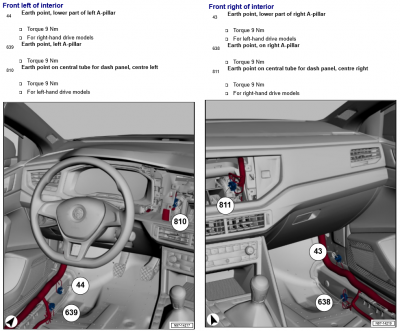

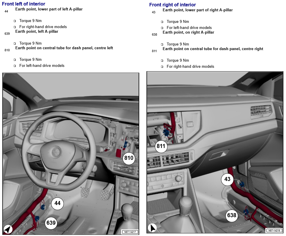

Little red wrote: Thu Oct 31, 2019 2:40 am I am currently experiencing intermittent electrical problems which I know are a bugger to fix. Front assist daily stops and starts. Car went into sports mode for 3 days despite having selected eco. iPhone not connecting WLAN or the Vw dongle of course when garage have it everything is good.
Could this be caused by loose earth wire / points?
(Earth Points not torqued properly.)
The following is just 2 sample pictures from ErWin, but this is what I meant for earth points:
I have the entire Earth Point document of the AW Polo in pdf format, if you need it feel free PM me your email address.
