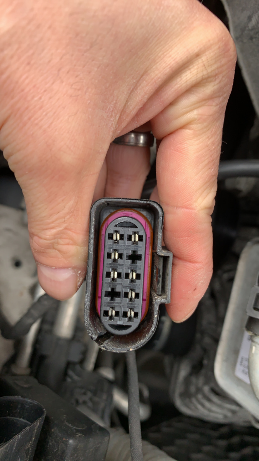

Hello,
Does anyone have the pin layout for this plug? See attached.
@Iitchel or @ciclo?
Any help is much appreciated. Thank you
Halogen plug pin layout? Iitchel or ciclo?

Re: Halogen plug pin layout? Iitchel or ciclo?
1 +12v terminal 15
2 leveling motor
3 lieveling motor
4 vacant
5 GND
6 low beam
7 vacant
8 high beam
9 indicator
10 parking light
Hope this helps
