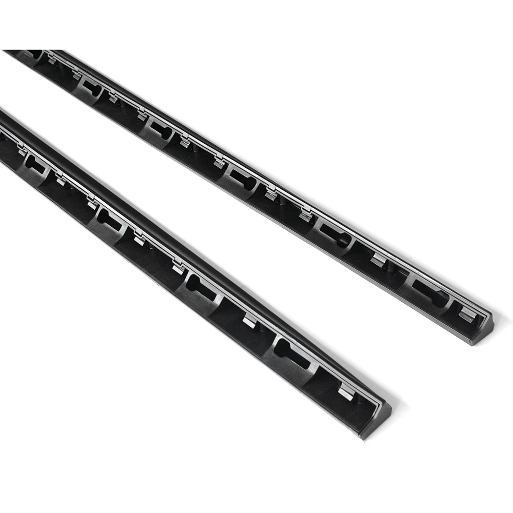

It looks as if your sill has been pushed in behind the side skirt, creating a gap between the side skirt and the sill. Here’s the reverse side of a mk7 Golf GTI side skirt, which is the same design and uses the same fixing method as the skirts fitted to the Polo - the slot screw holes on the reverse side of the plastic side skirt fit over a series of bolts / screws that are threaded into the metal sill on the car.
If you look under the bottom of the side skirt, you should see two (I think) hex headed bolts. If you remove these, the side skirt should then slide sideways - I think, it slides towards the back of the car, so for the driver’s side on a RHD car, it would slide to the left. Once the side skirt has been slid sideways as far as it will go, it should just lift away from the car.

If the metal sill behind the side skirt has been pushed in as it seems to have been judging by your picture, it’ll probably mean the screw-in fixing points into the sill are extra-tight into the slot holes in the back of the side skirt. Might be worth trying to push the side skirt inwards towards the sill at the point where the metal sill is damaged at the same time as sliding the side skirt side wards.
