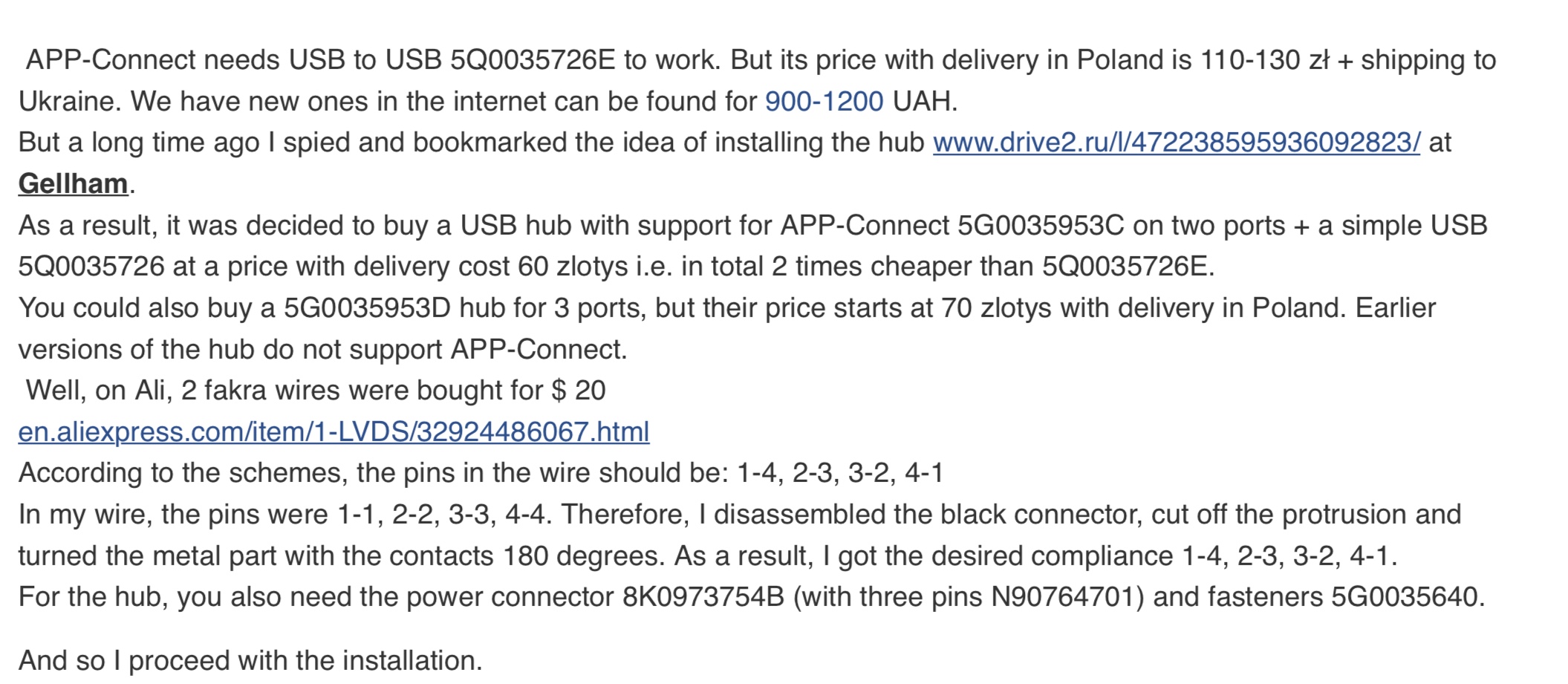

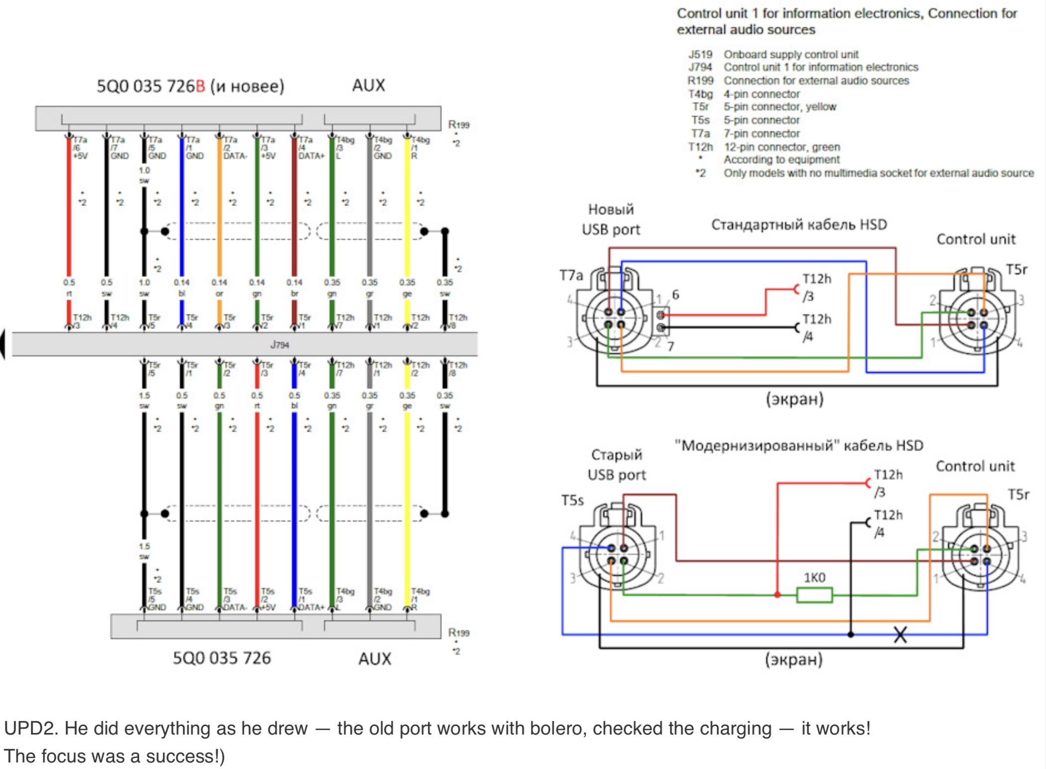

So after much trawling I found this great post on another site covering exactly what I need to find out.
If you have a basic 510 stereo system you will need to get the usb cable and new socket for android / CarPlay / mirrorlink when updating the media unit in the glove box
https://www.drive2.com/l/533524549434606087/

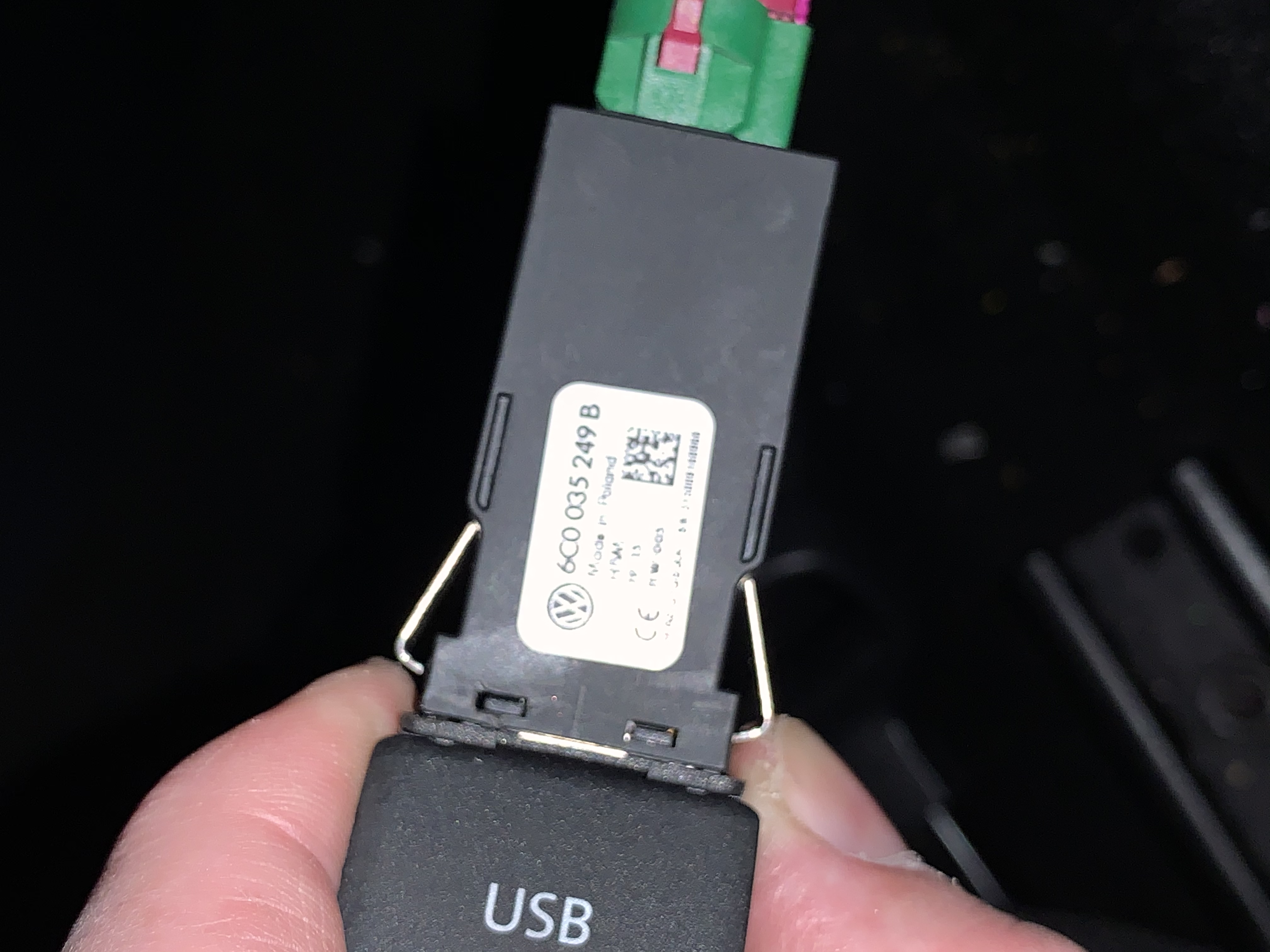

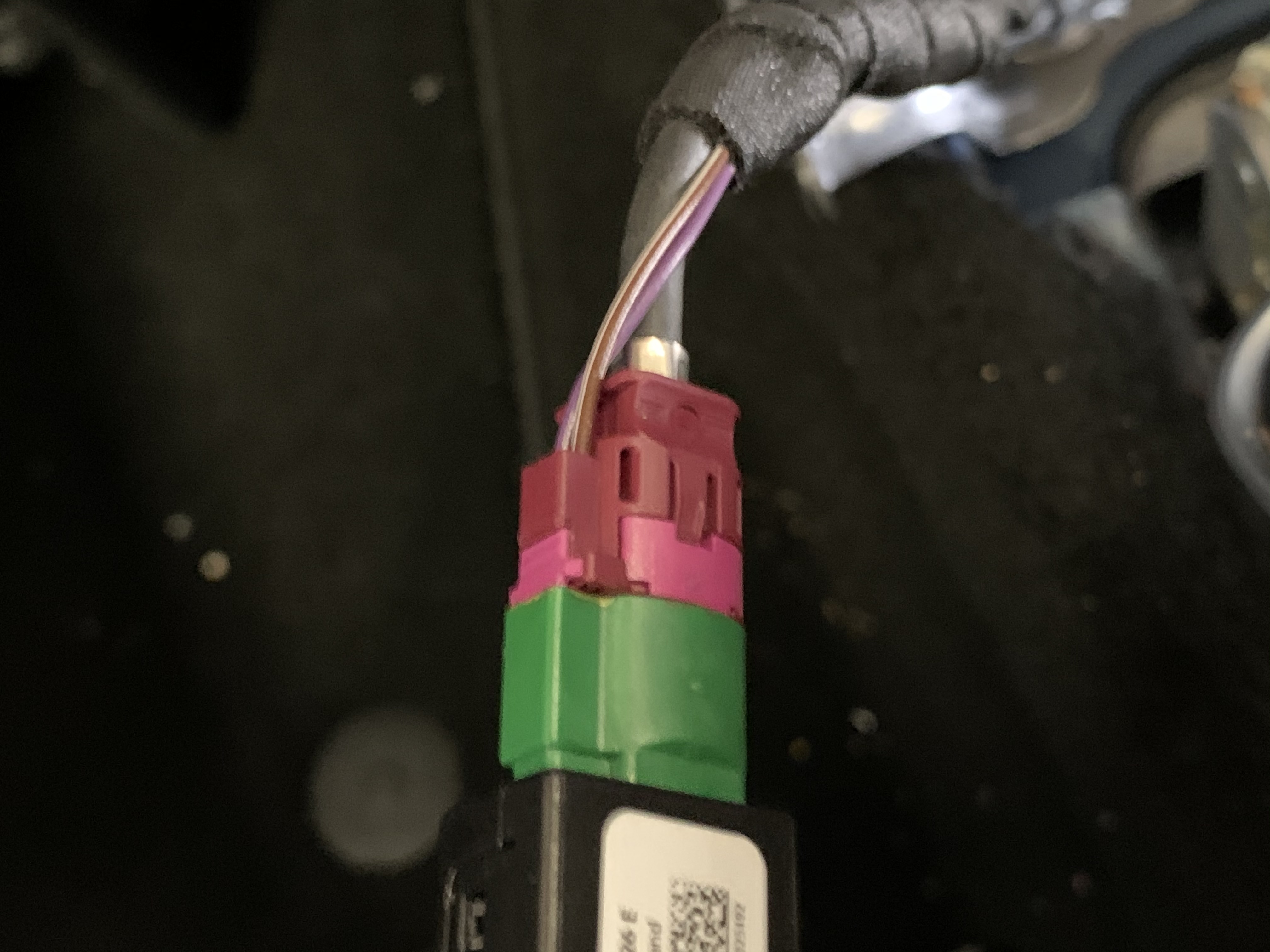

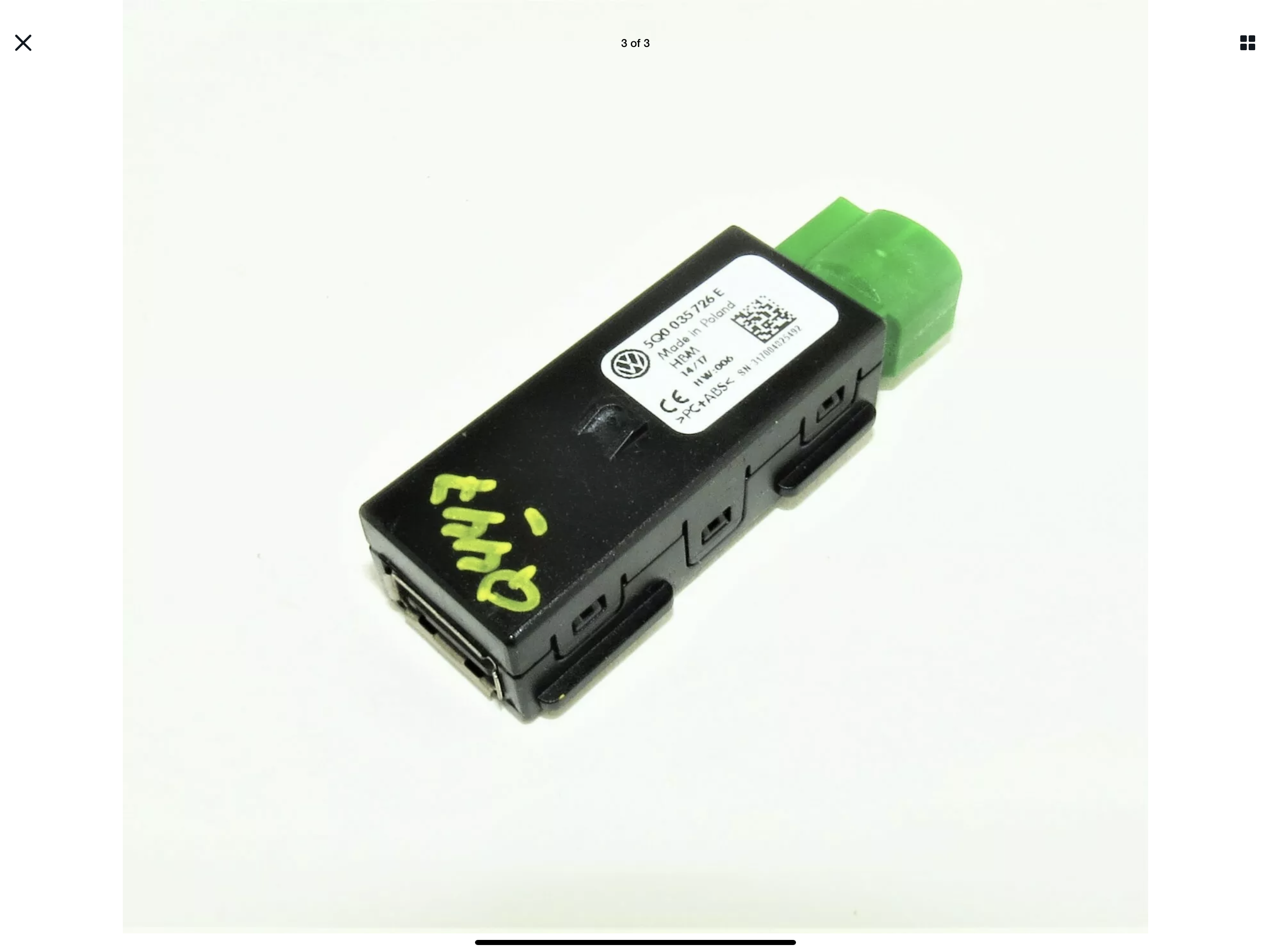

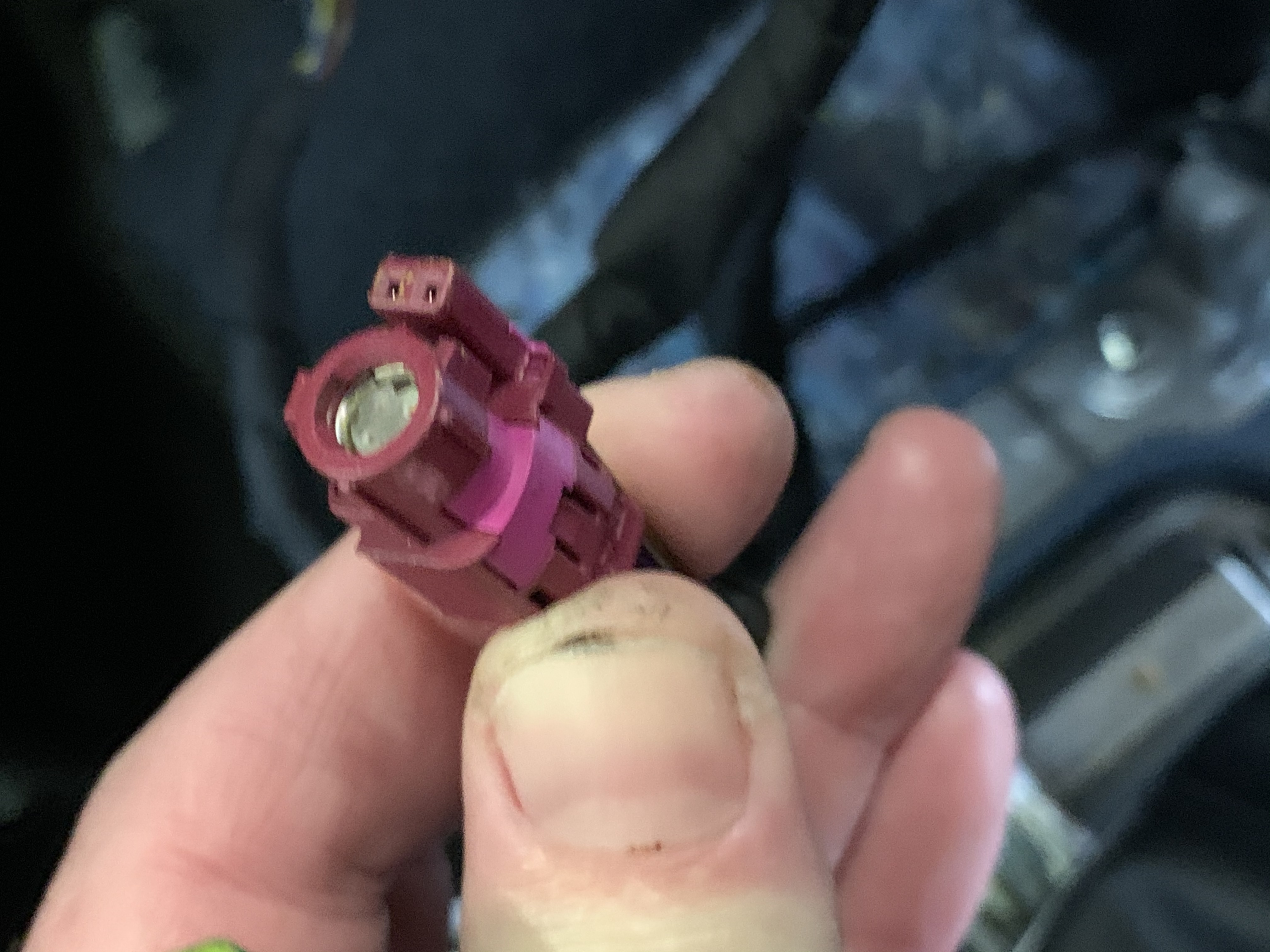

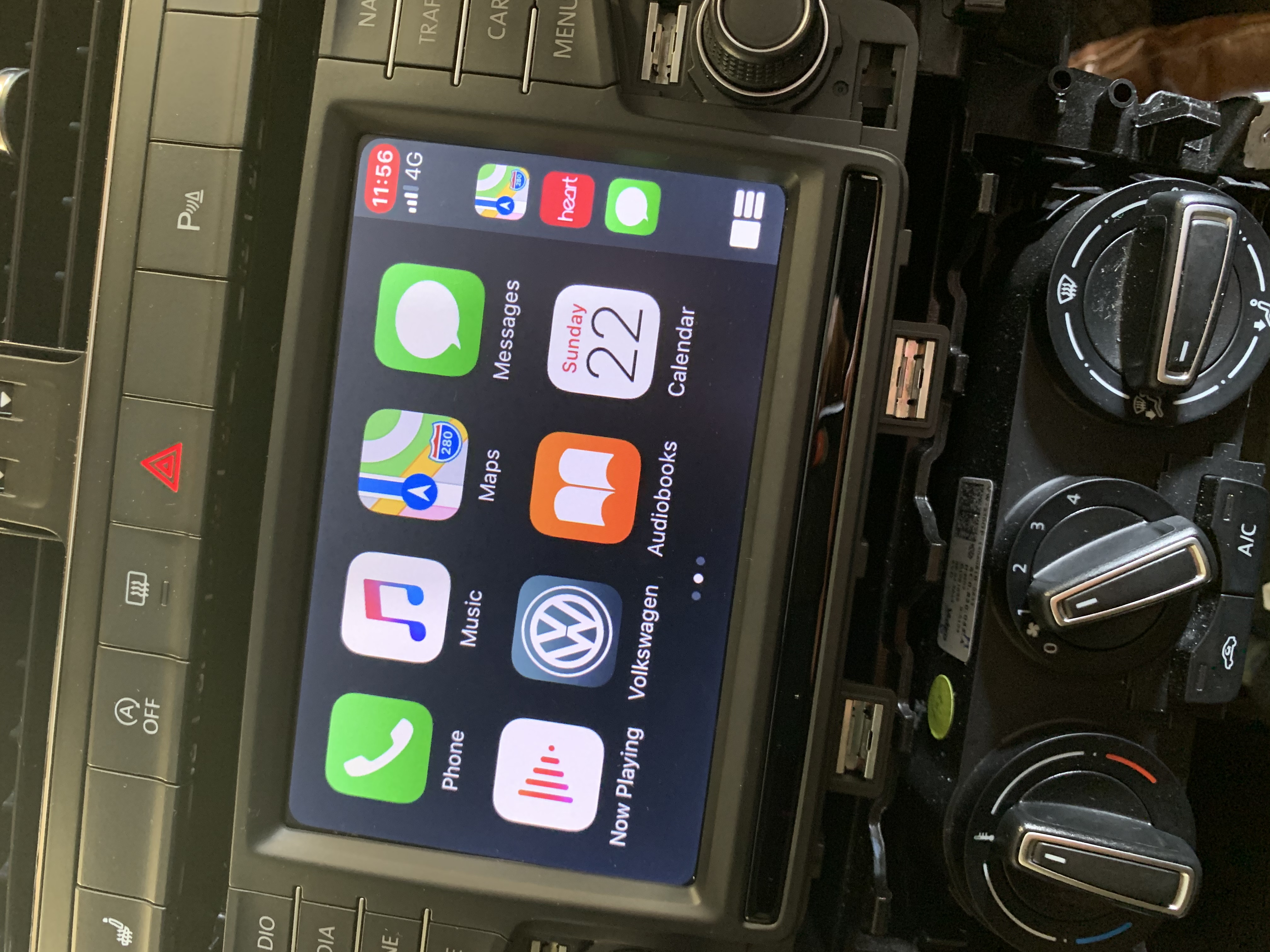

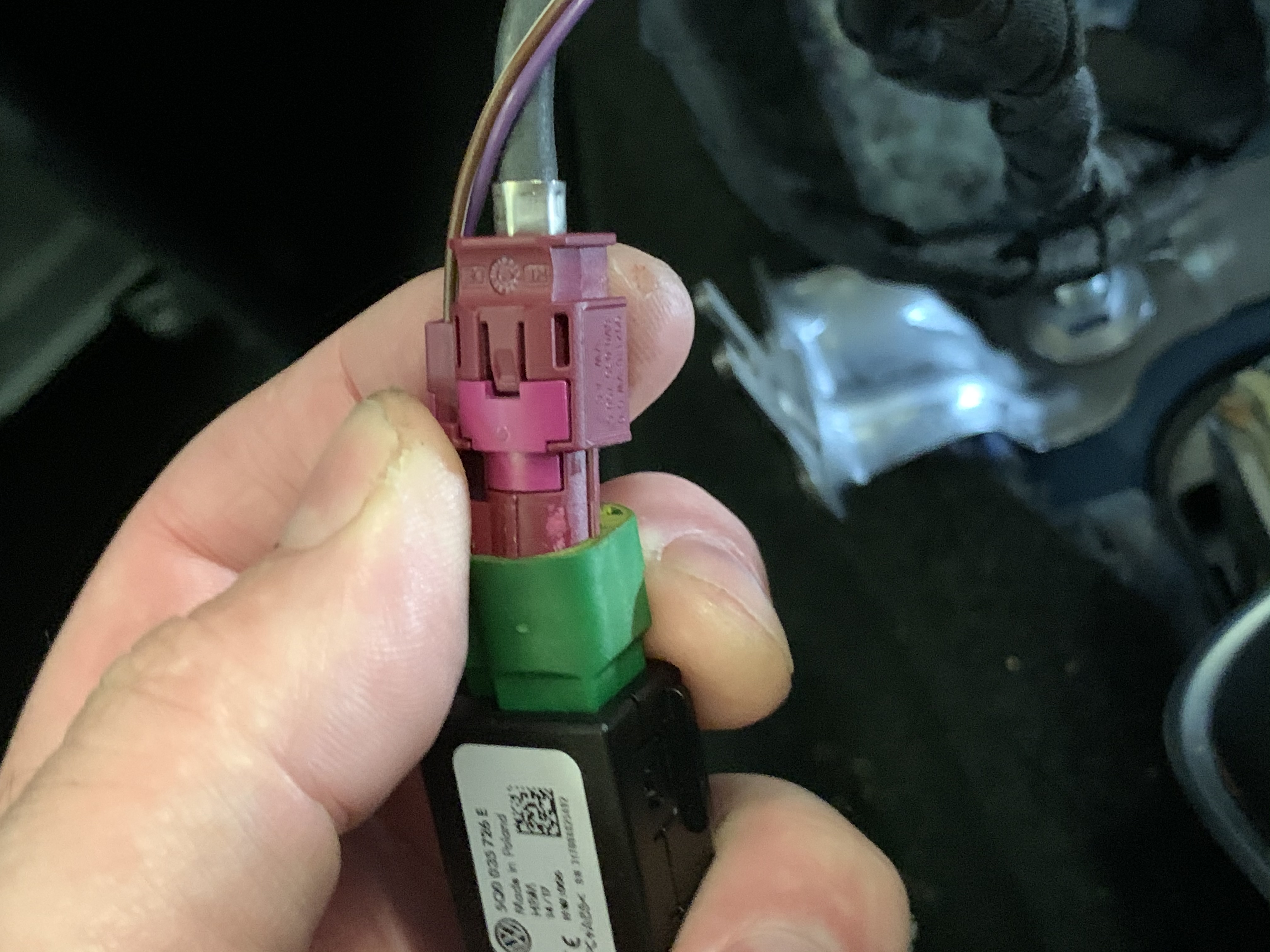

So I received a new green socket new 2017 version 5Q0035726E in the post yesterday, not facial fitting to try and get my Apple CarPlay working.
Now my car has mib2 but being 2014 only a red socket fitted when new, not compatible with CarPlay.
So the cable connection is polarised for a red socket by 1 edge preventing fitting to the green socket, bar that identical in wire orientation.
So I trimmed this off to allow trail of the system..... I fired up the car and success! Apple CarPlay fully operational I am awaiting a USB hub to try and expand the usb connections in the car with voltage converter for 3 of them..... Don’t know if this will work, but as the interior is current apart fitting this in the rear for power only for the back seats Hoping heated seat kit arrives Monday so I can fit everything all at once

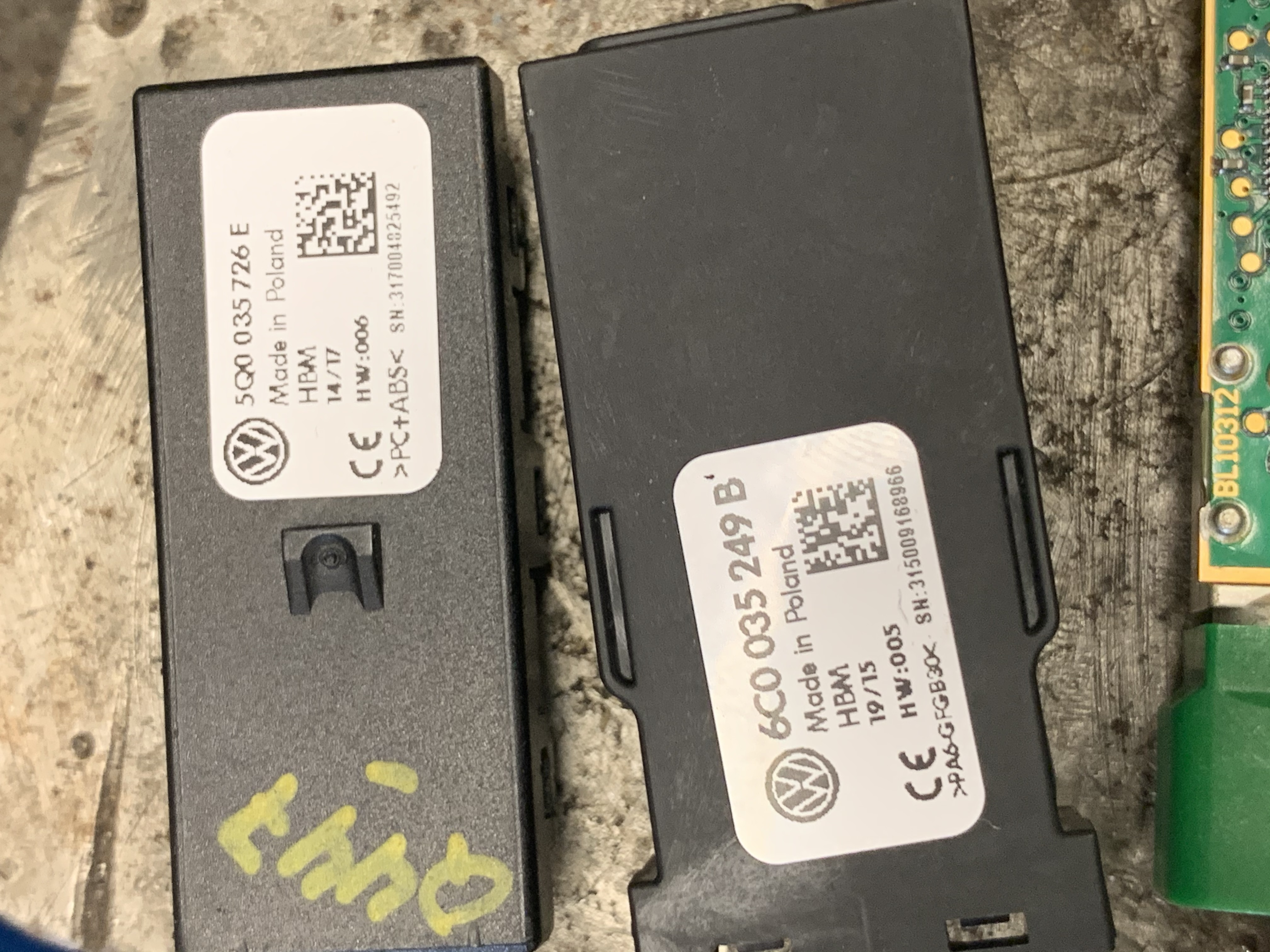

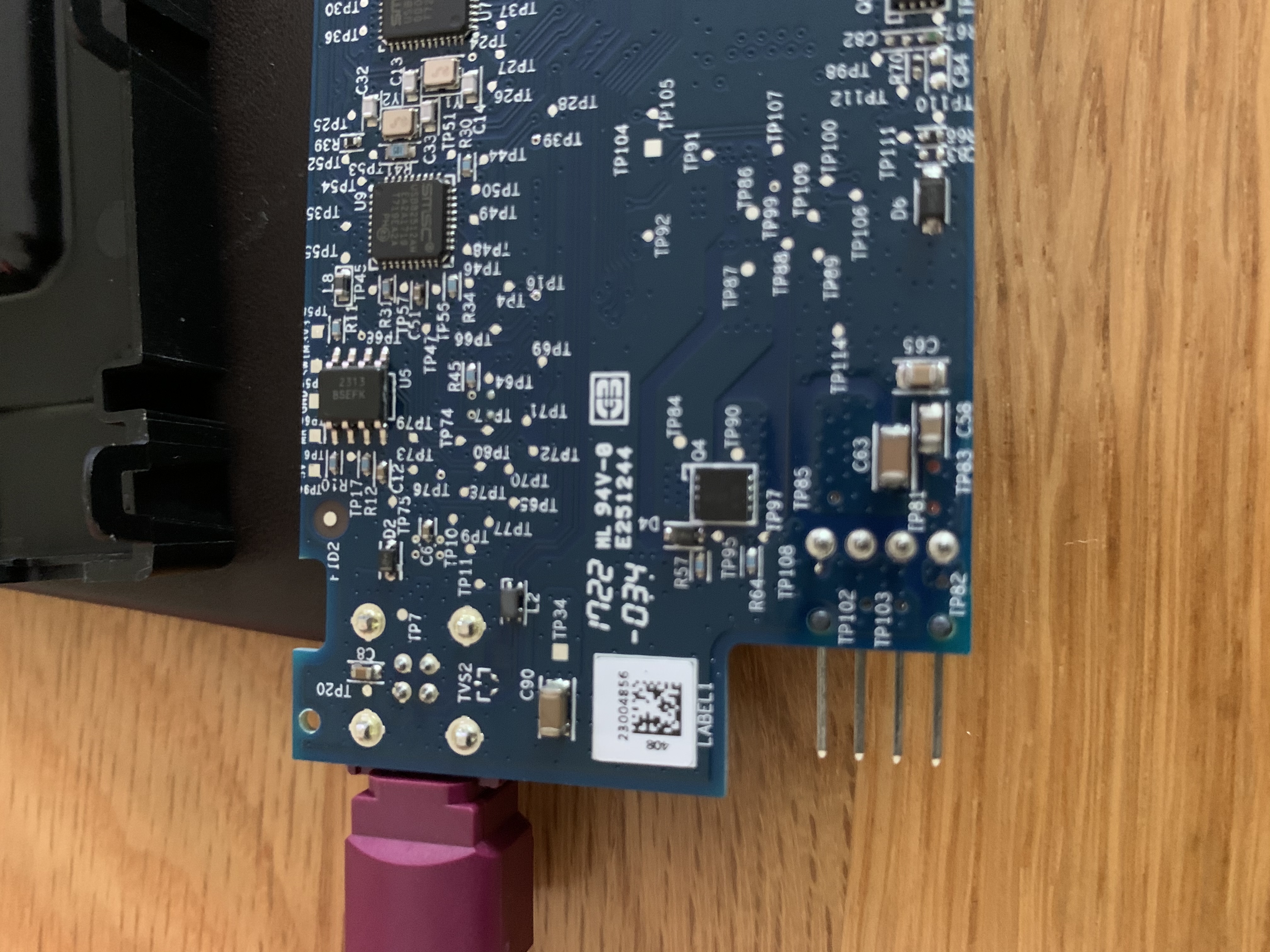

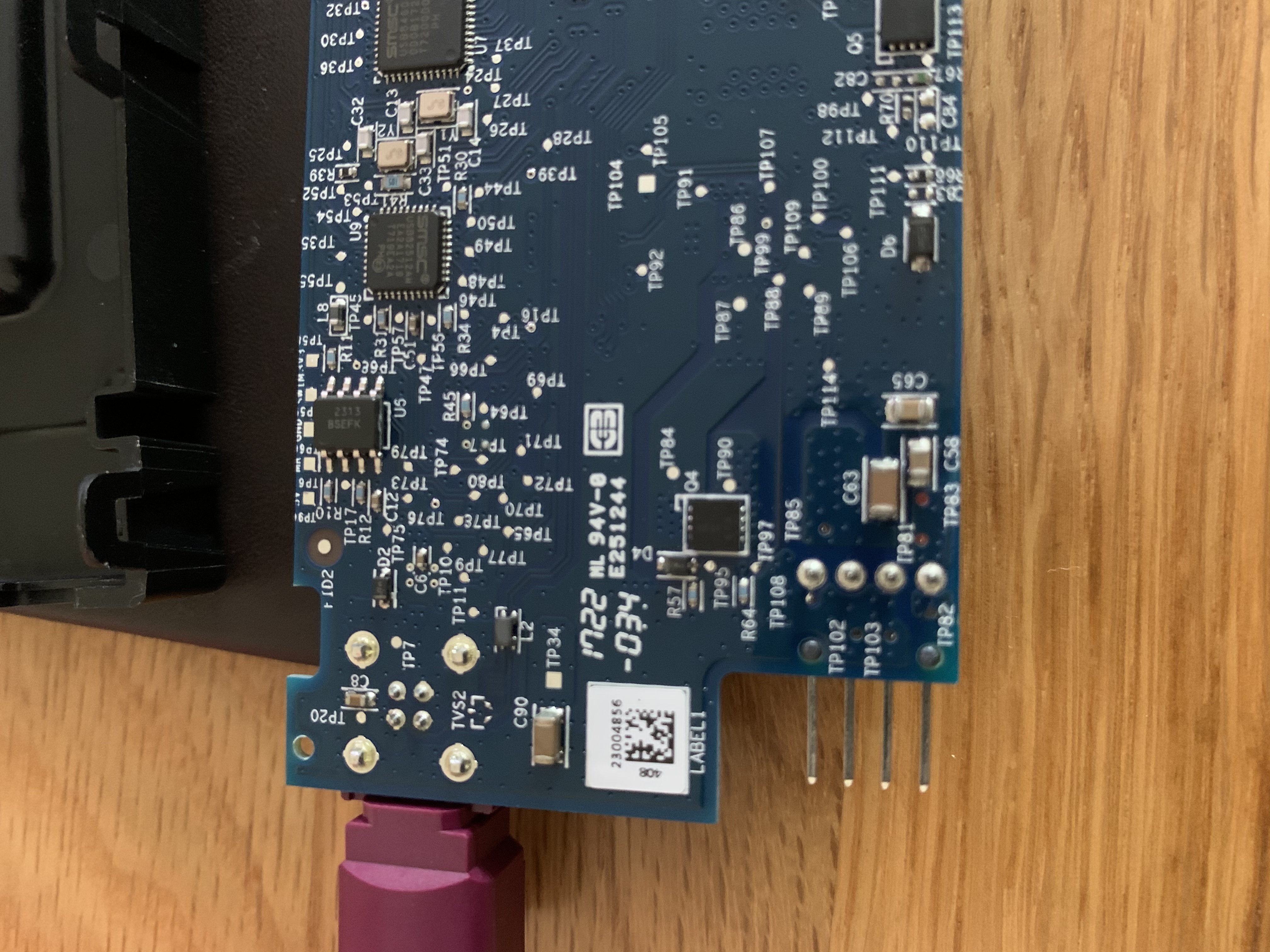

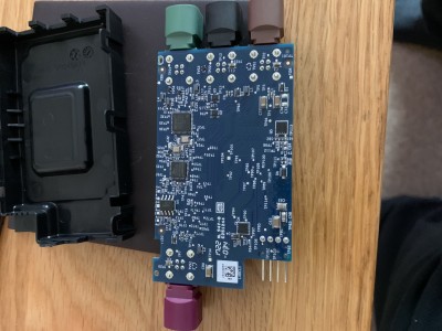

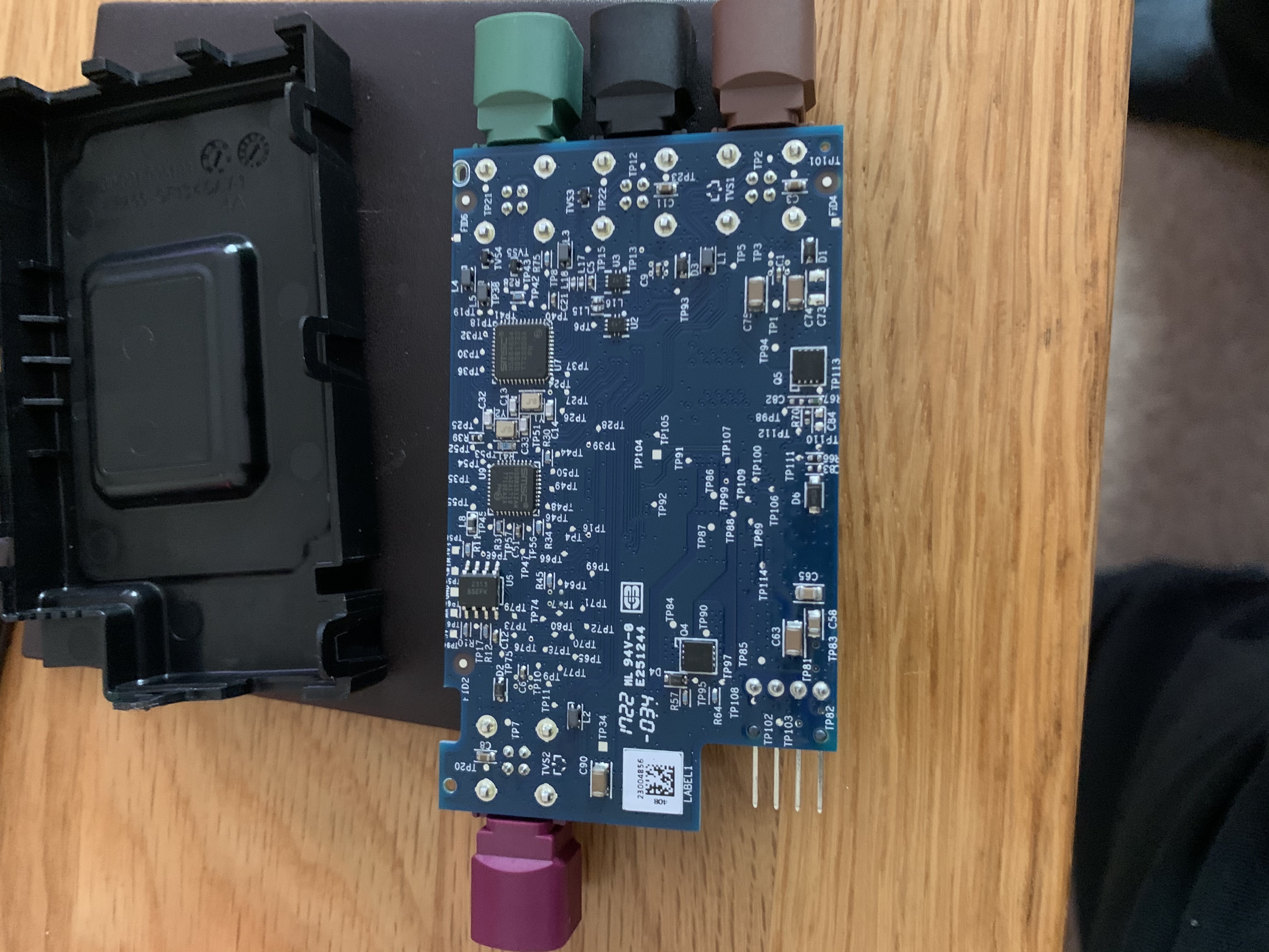

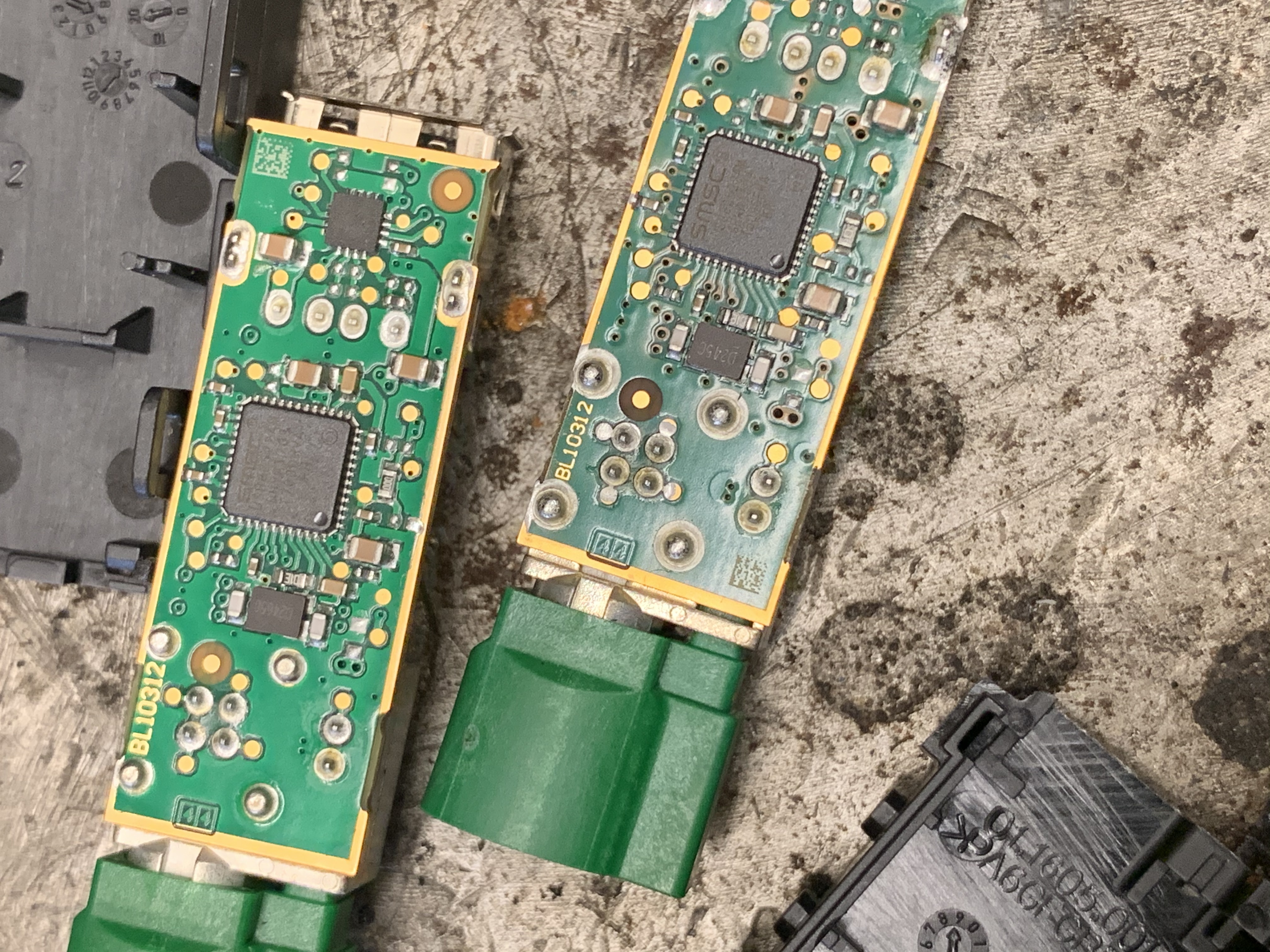

So the other usb socket arrived today which has the surface mount format.
Decided to compare the 2 units and ends up they have identical inner boards so here is the info in the pics folks for info.

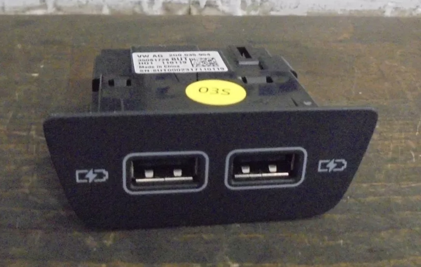

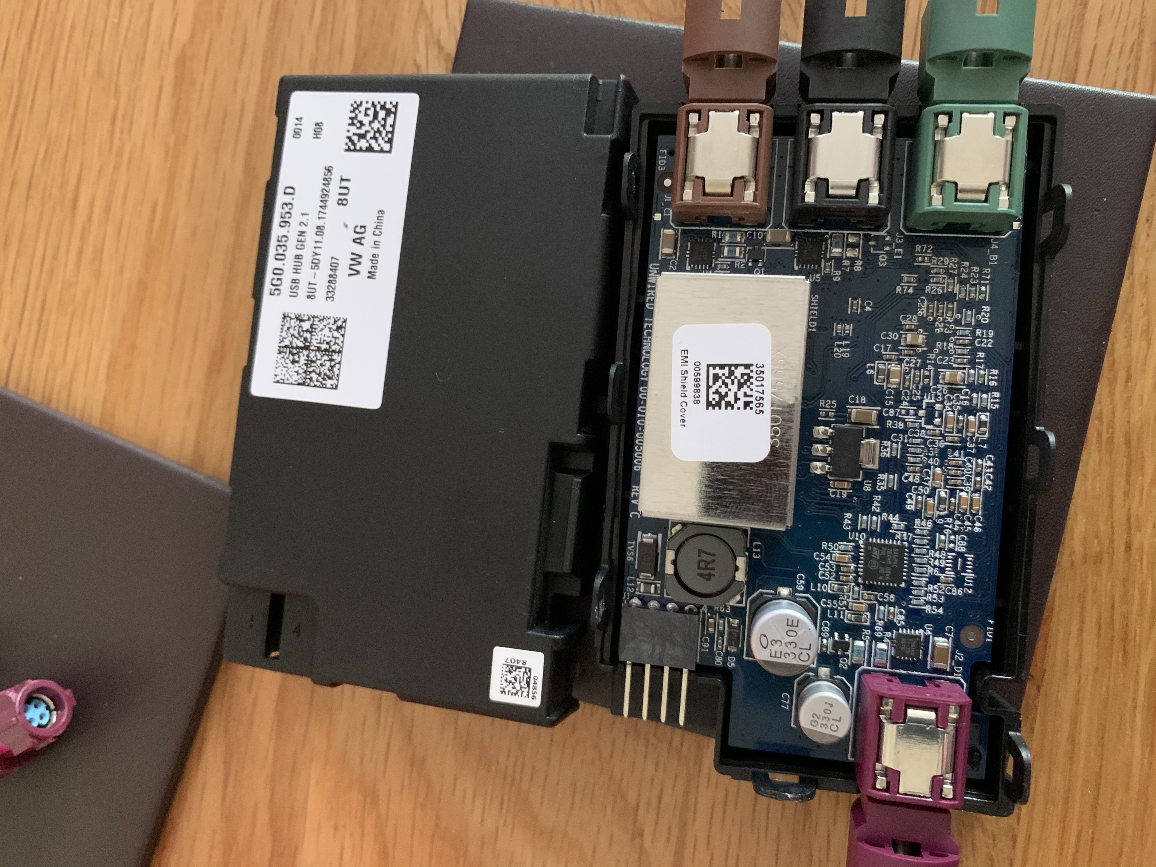

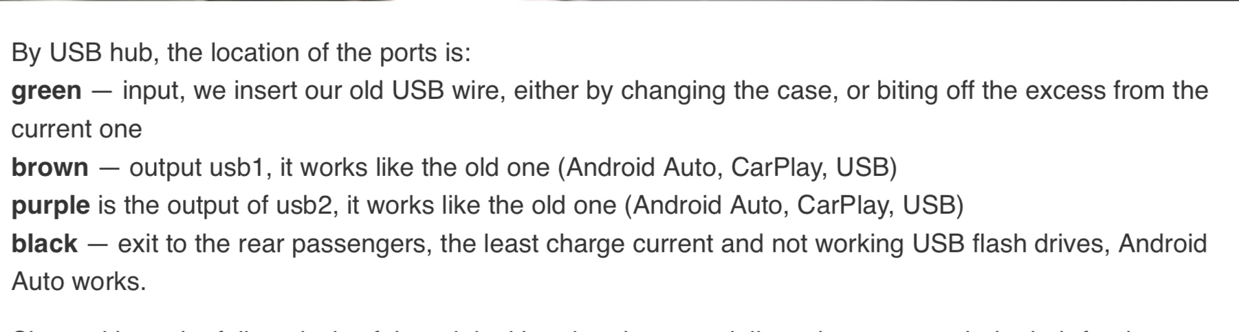

So the hub arrived and this is what it looks like close up
Just need to see if anyone can help work out the 4 pin connections
As this is the only info I have found.....

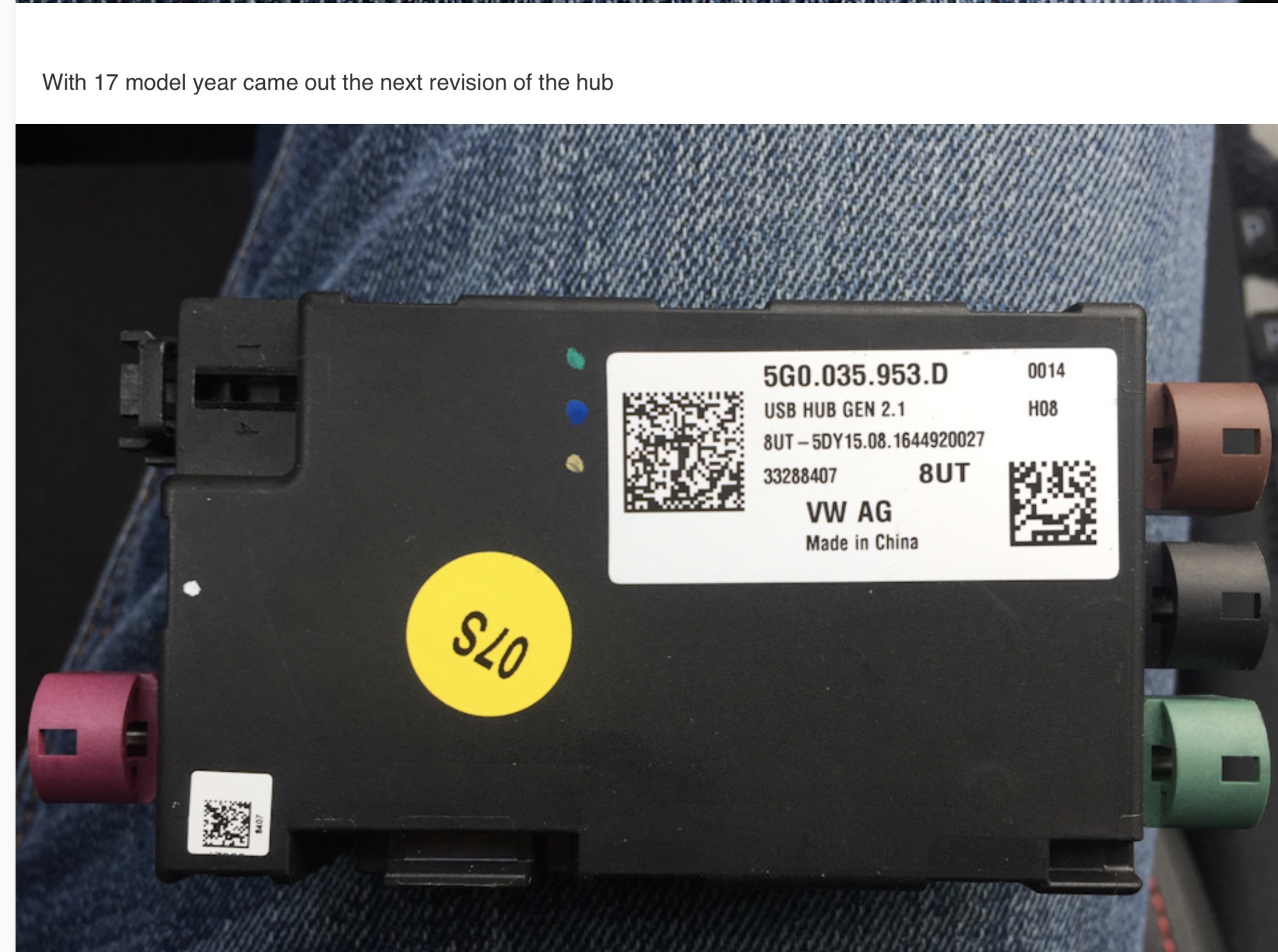

So after several hours of travelling the internet I found this which makes more sense,
Pin 1 - 12 volts
Pin 2 - earth ( taken from usb earth feed)
Pin 3 - n/a
Pin 4 - media unit =5 volt ( taken from original usb power feed)
The unit connections of the actual Fakra ones are
I need to get my hands on 3 A type Fakra 4 pin cables to allow me to plug the 3 socket in.
Pin 1 - 12 volts
Pin 3 - n/a

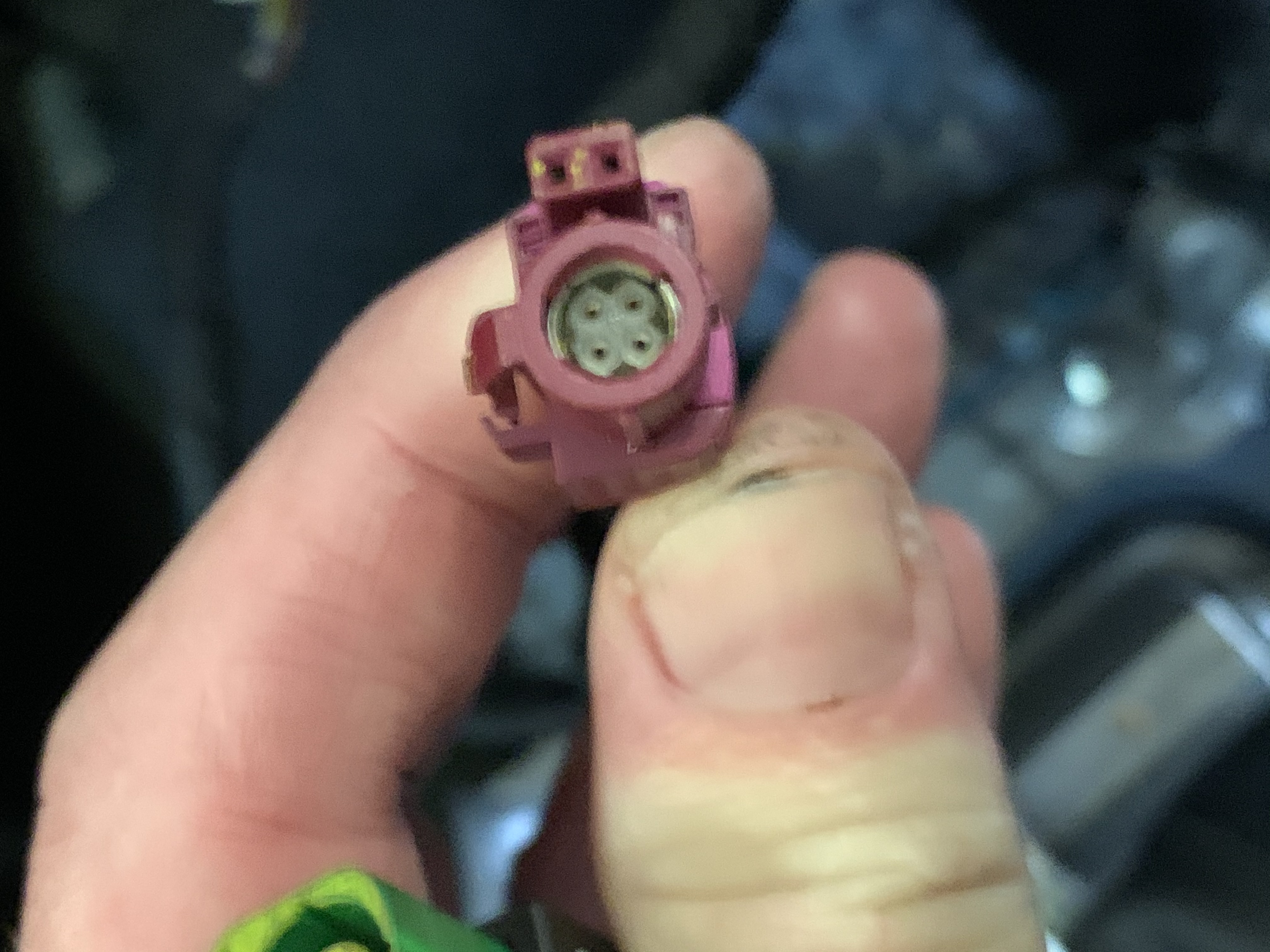

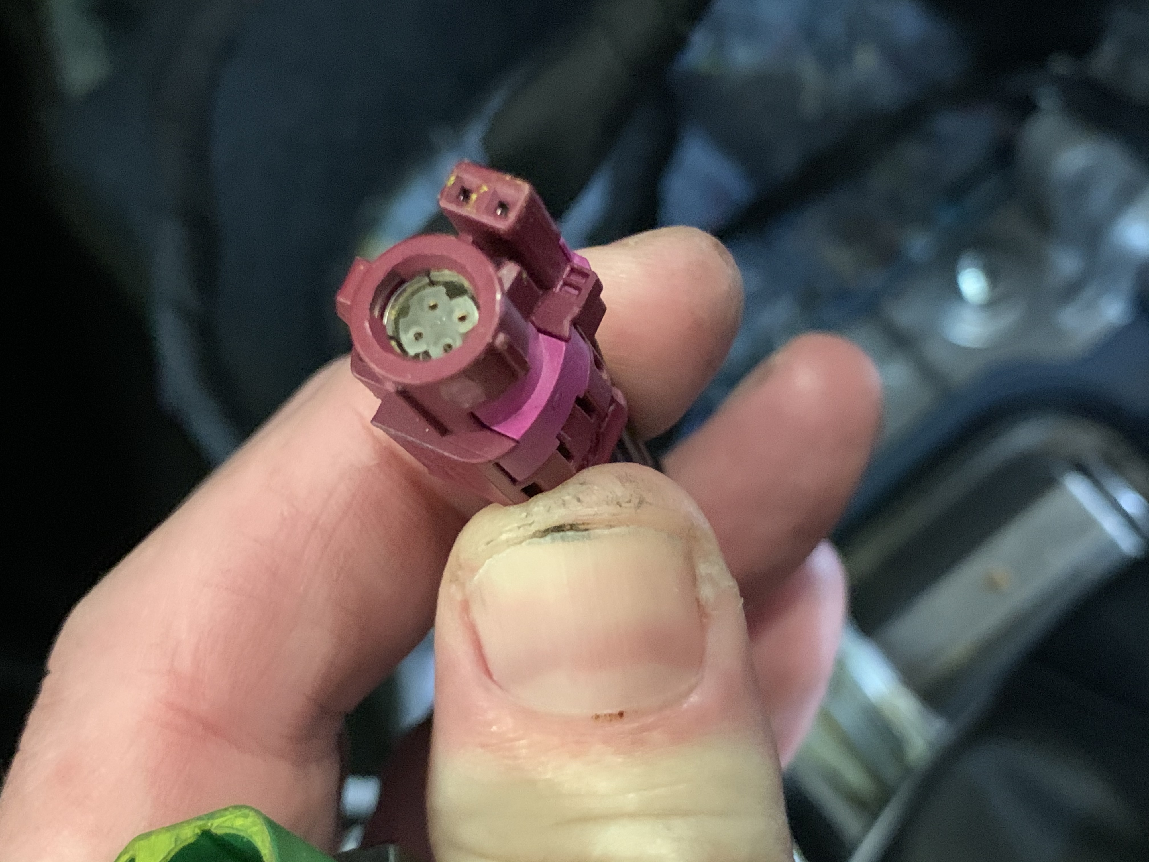

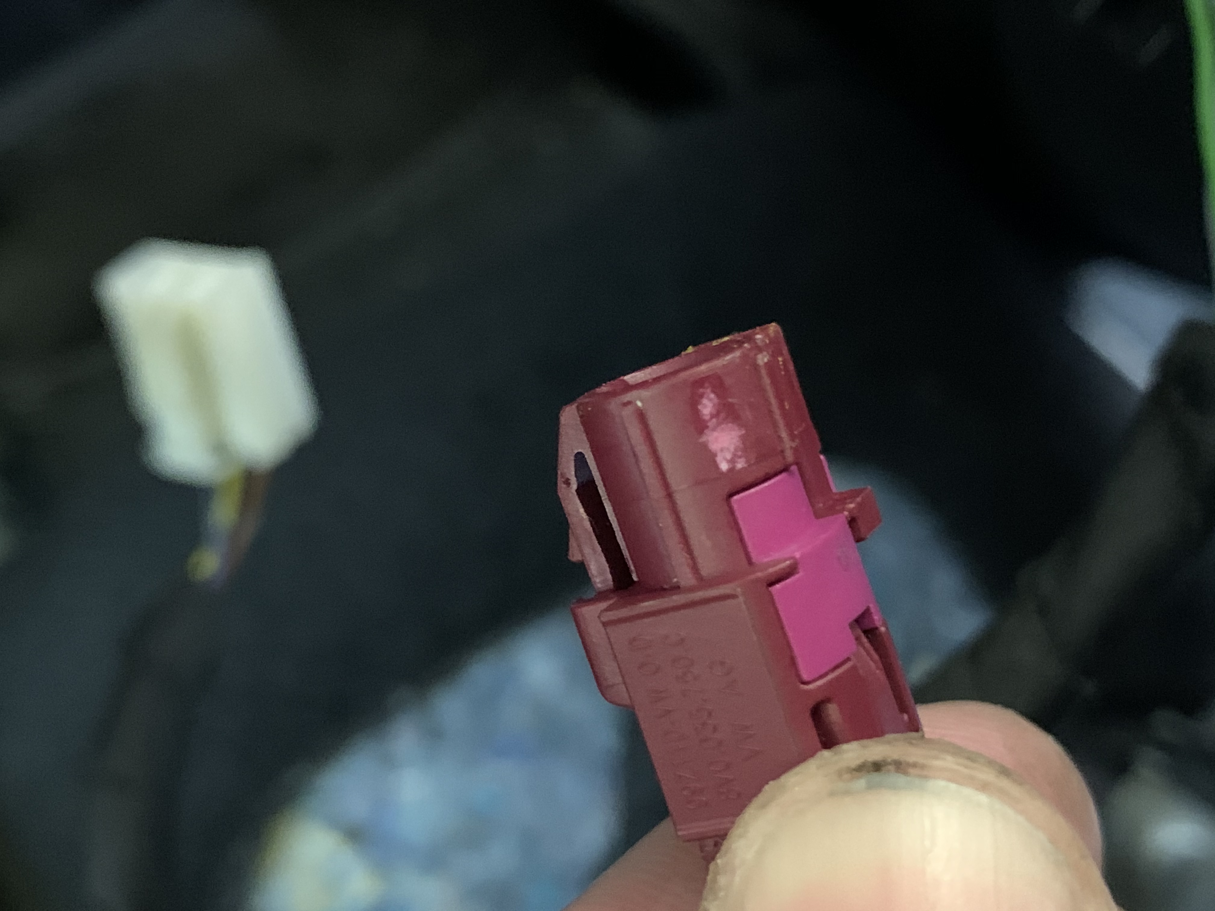

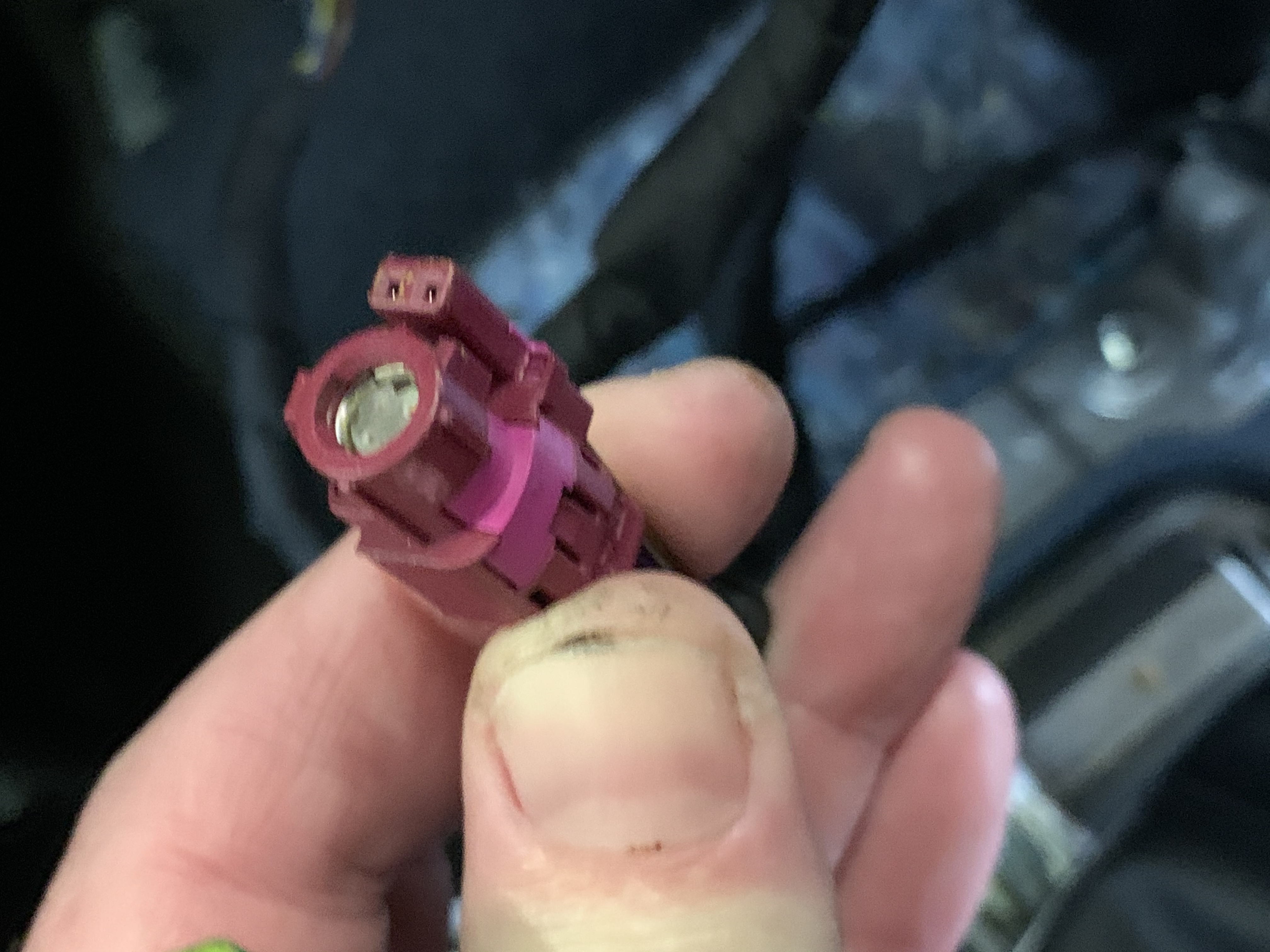

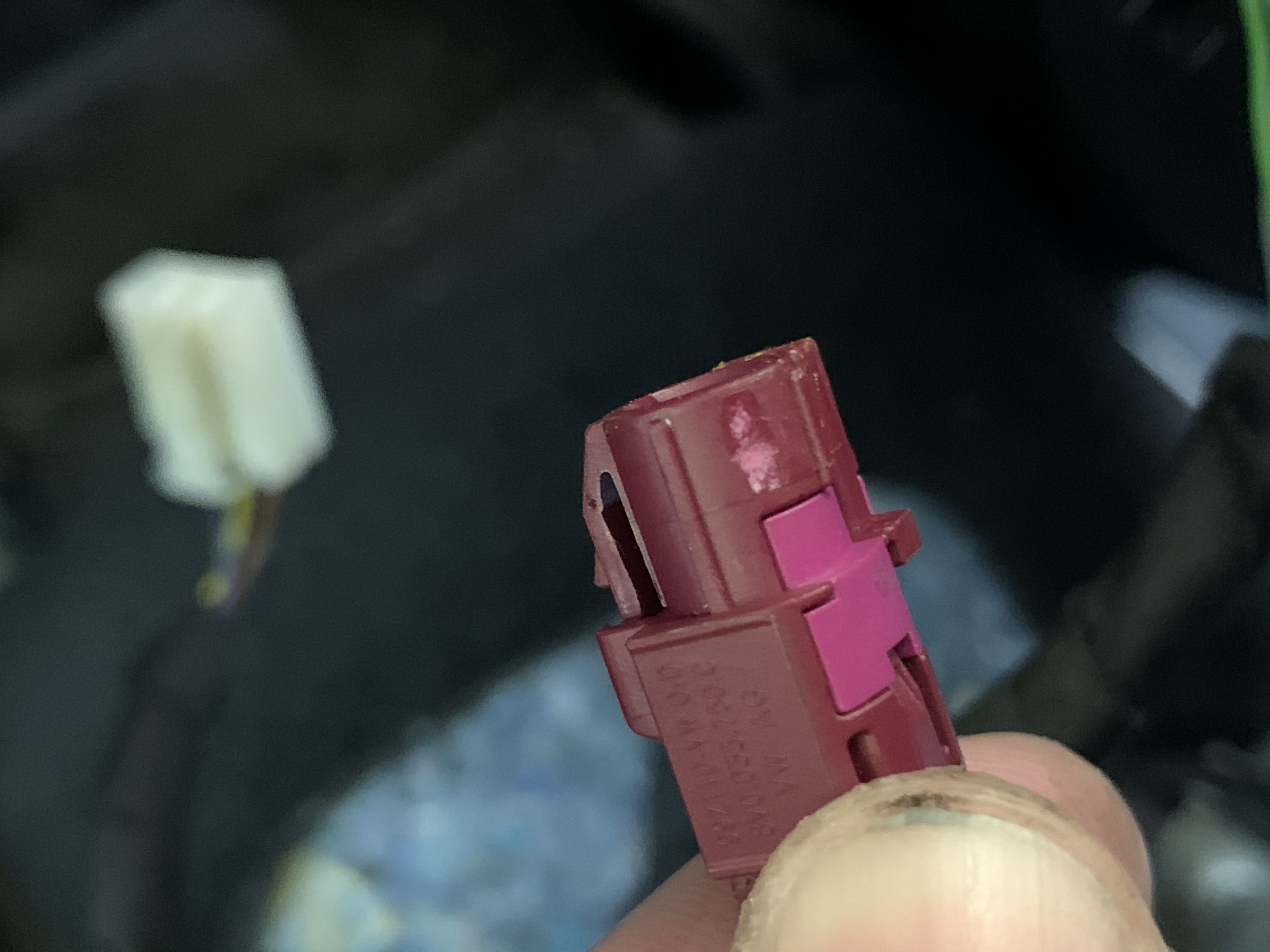

Reason we have to change the usb sockets also now identified, however if a cable mod is done the same sockets also will work
Cable mod is to rotate 180 deg and make it refit the plug
Re: Usb issues after full nav media upgrade
Hi Robbo770
Great post....My son bought his first car recently, a 3 door Polo, and I've treated him to an upgrade of the media unit through Vagtech as he wanted DAB, NAV and Car Play. Had it fitted locally to me with new aerial and leads and all works fine except for Car Play.
Now i've worked out, and you have confirmed that the USB is not active so only charges the phone. I've purchased the correct one, green end, and will be fitting this weekend - that can be my daily exercise. The lead for the socket is purple like yours, are you suggesting that if I adapt it like yours it will work for Car Play, so i don't need to change the lead?
Thanks in advance
Thanks in advance
Robbo770
- Posts: 109
- Joined: Sat Mar 14, 2020 1:56 am
- Drives: Polo SEL 1.4 tdi 2014
- Location: Scotland
Hi, correct, trim the tab stopping it fitting the green new usb socket and bingo all will work
