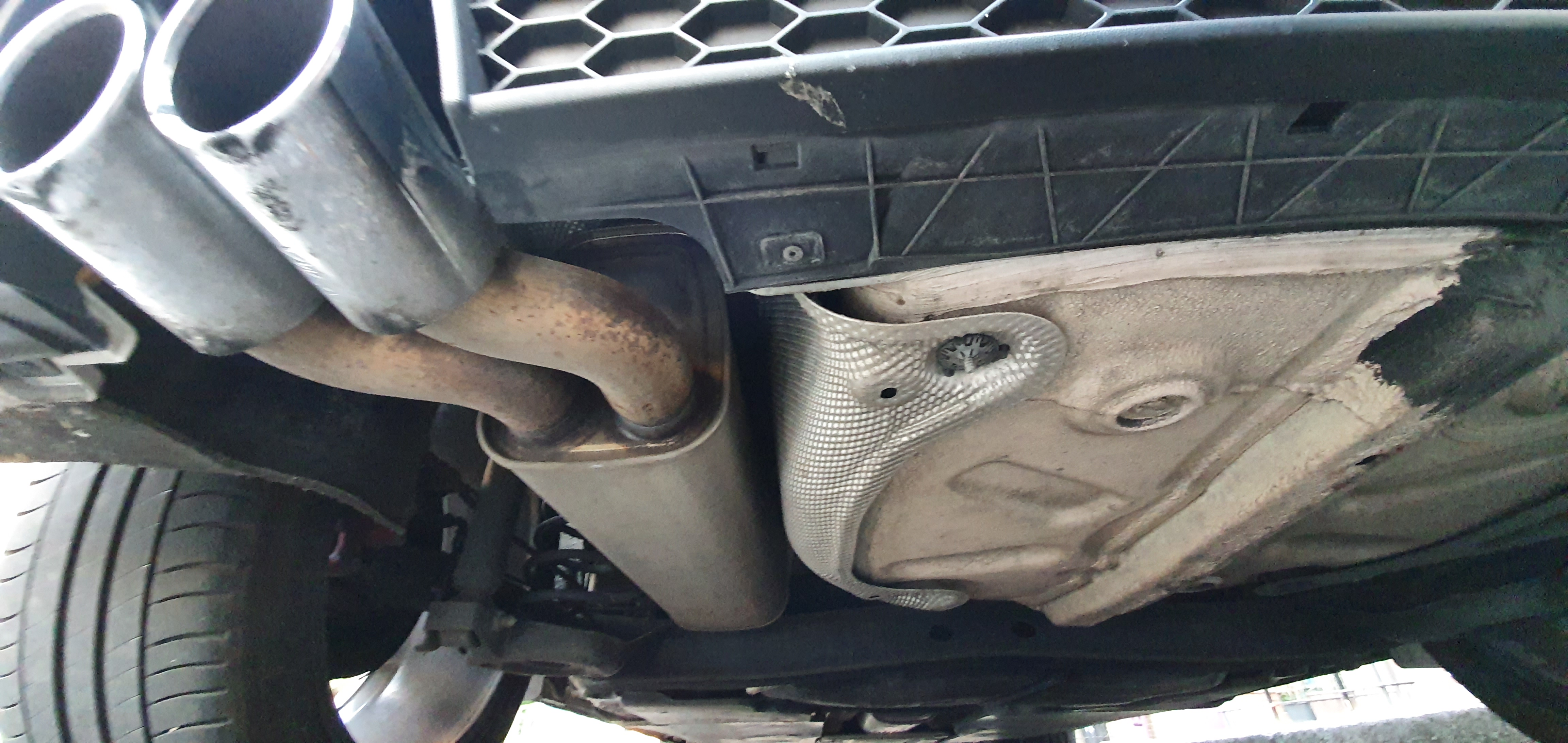

How do I confirm whether my polo GTI plus is a pre-wltp?
My car was registered on June 2018 and I have had a look under the vehicle and all I can see is a resinator.

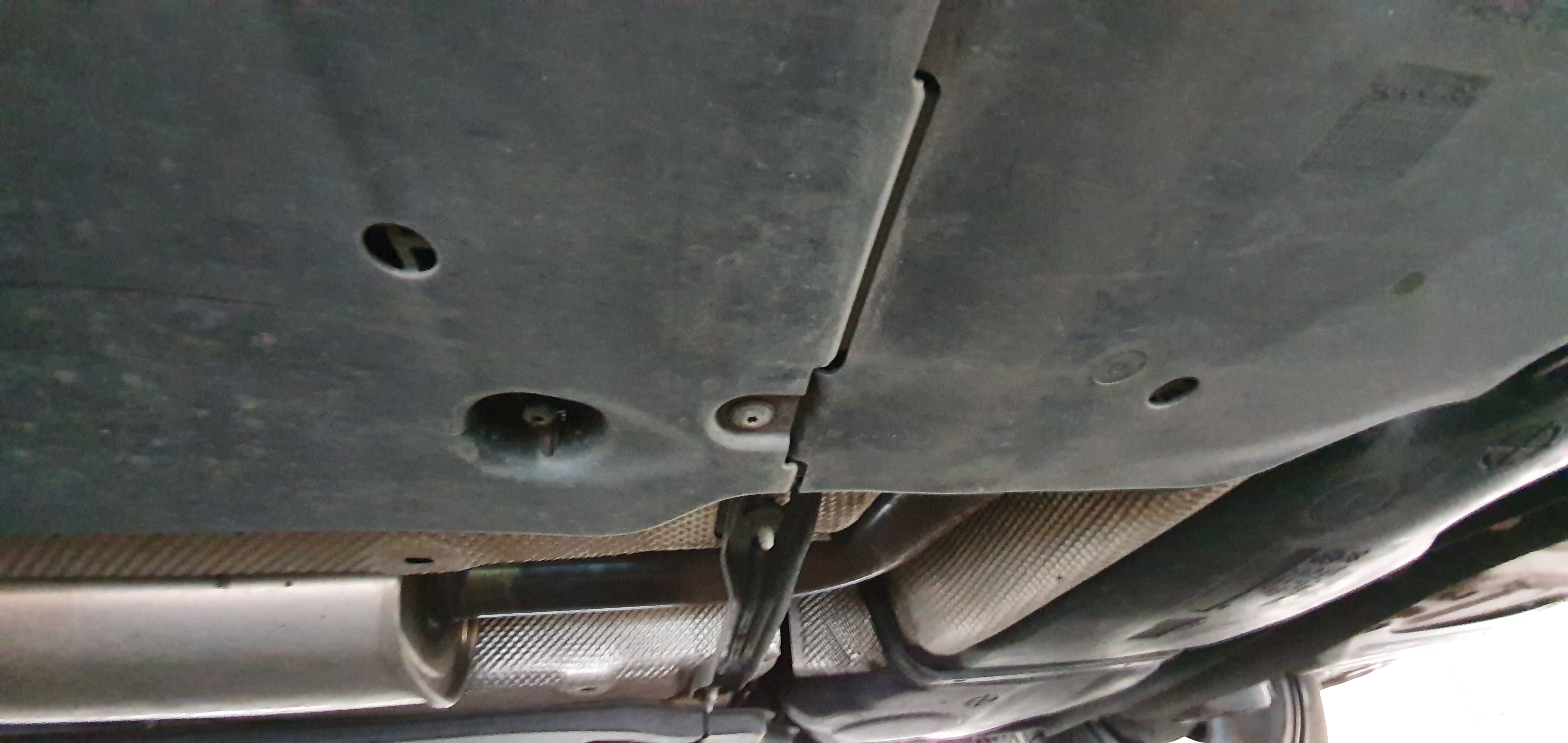

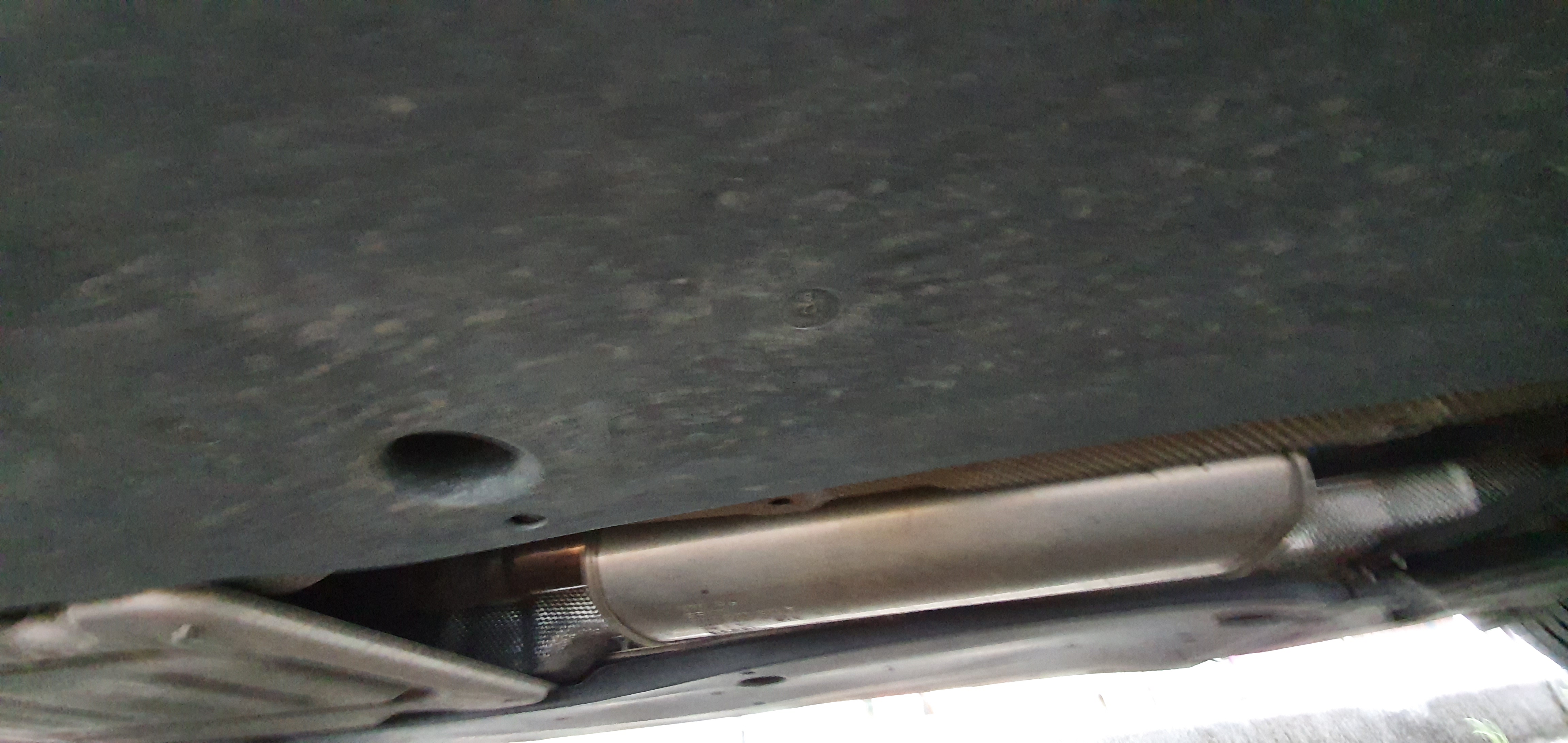

Ive tried to take a photo of the WLTP so everyone can see what it looks like but once the vehicle is on the lift and hoisted its kind of tricky to get a clear image.

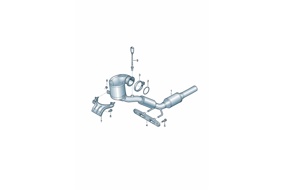

This is what it looks without gpf:

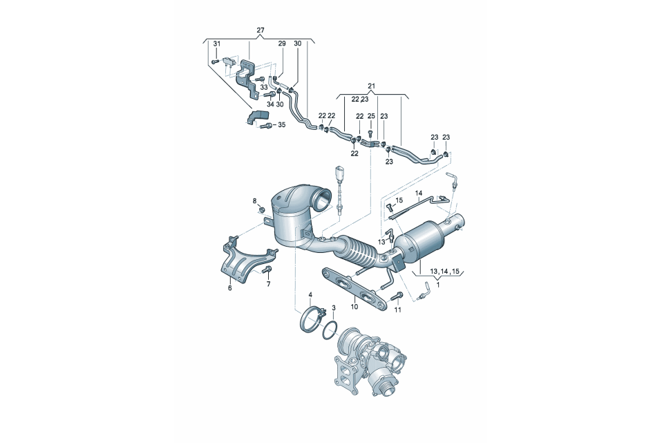

and with gpf:
there are few little visible changes to design and they should be visible on car too - OomStu_ZA

Thank you, this will help to confirm when I have the vehicle up on the hoist again. To be honest I recall the angled box (closest to engine) as smooth and not ribbed as per the image 2.
