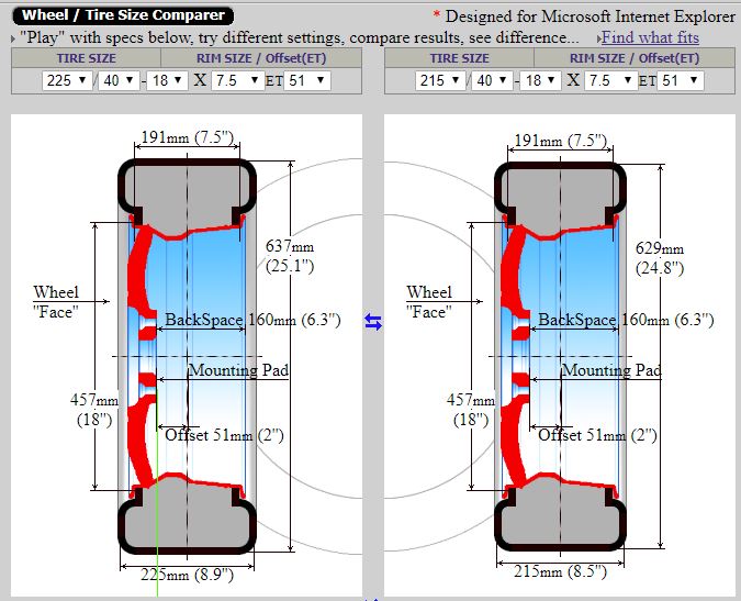

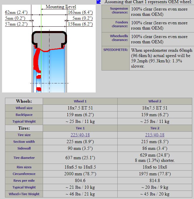

Found a website that offers some technical explination in the images below:
- the speedometer is going to mark correctly the speed?
[from what I've read there will be an approx. 1.4% difference in reading, so not really that noticeable]

This has been discussed at length previously. 225/40 R18 is the standard tyre on the 18" wheels of the Golf GTI/GTD/R. The standard wheels on those models are 7.5J wide, same as Polo GTI's Brescia. Perfect fit.
The rolling circumference of the wheel will increase by 8mm as you say, but this results in an increase of approximately 1.27%, contributing to 1mph under-read on your speedo at 70mph. As the speedo over-reads by about 3% vs GPS anyway and there is an allowable tolerance of (can't 100% remember) something like 2.5% then we're fine. The difference in rolling diameter between new and fully worn 215/40 R18 is about 12mm - to put your 8mm into context!

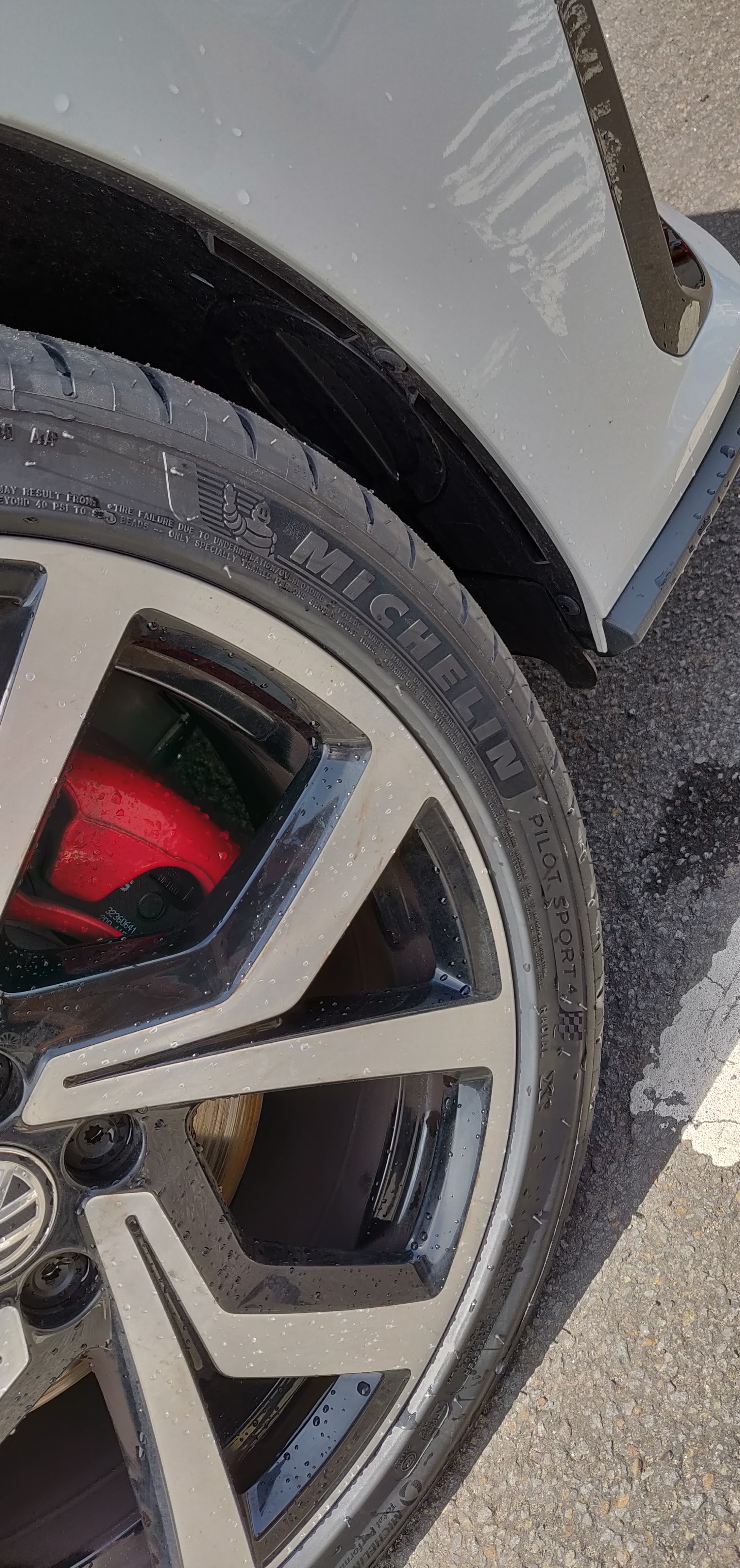

Got some pictures at hand if that helps. :)
I bought the PS4's on monkeyhanger's recommendation. Would recommend anyone else do the same, they have improved the car ten fold. And having the protective lip is a benefit!

Great pictures. The rim protection looks great. Price for 4 looking good too. Thanks for the advice .
