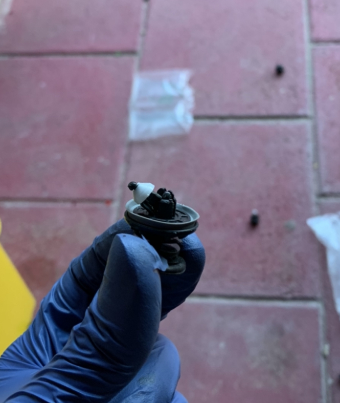

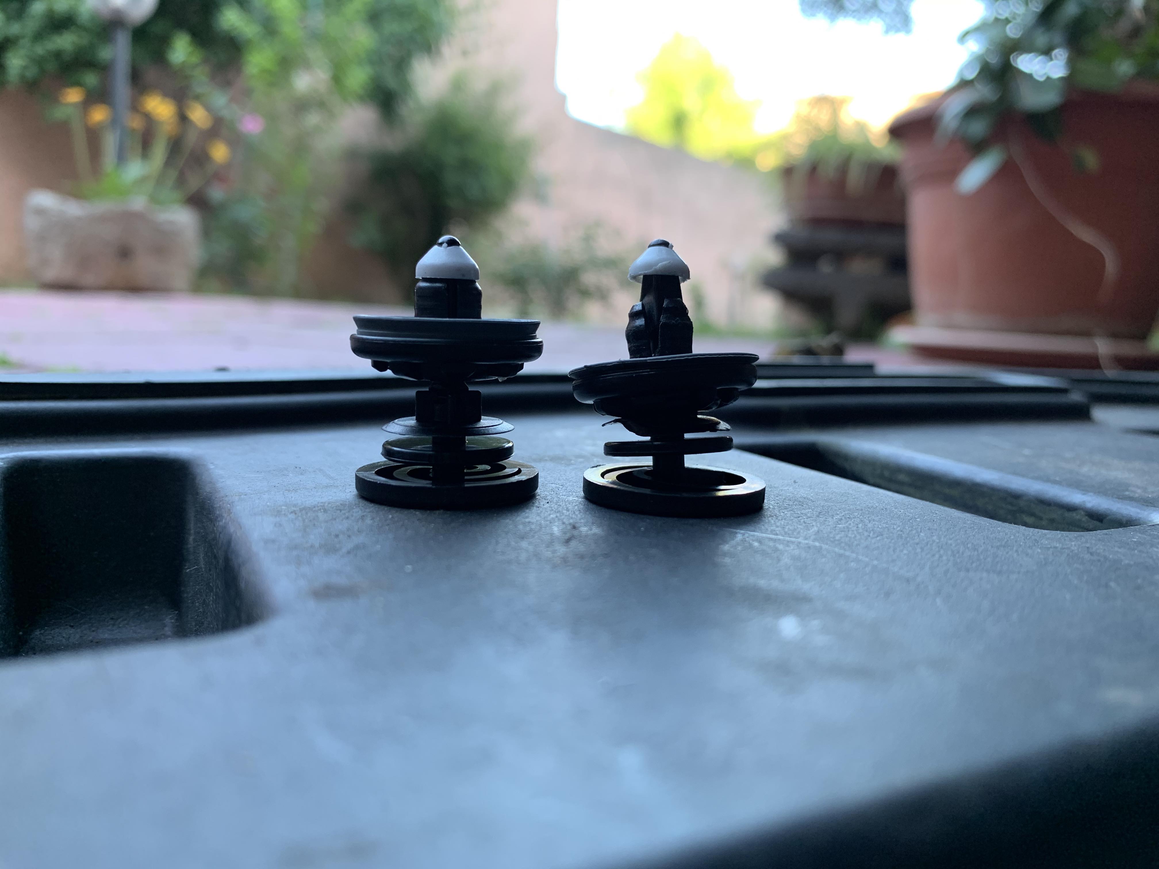

3) All the door panels now have new clips (original and not the cheapest version which were installed previously) and this is the difference
