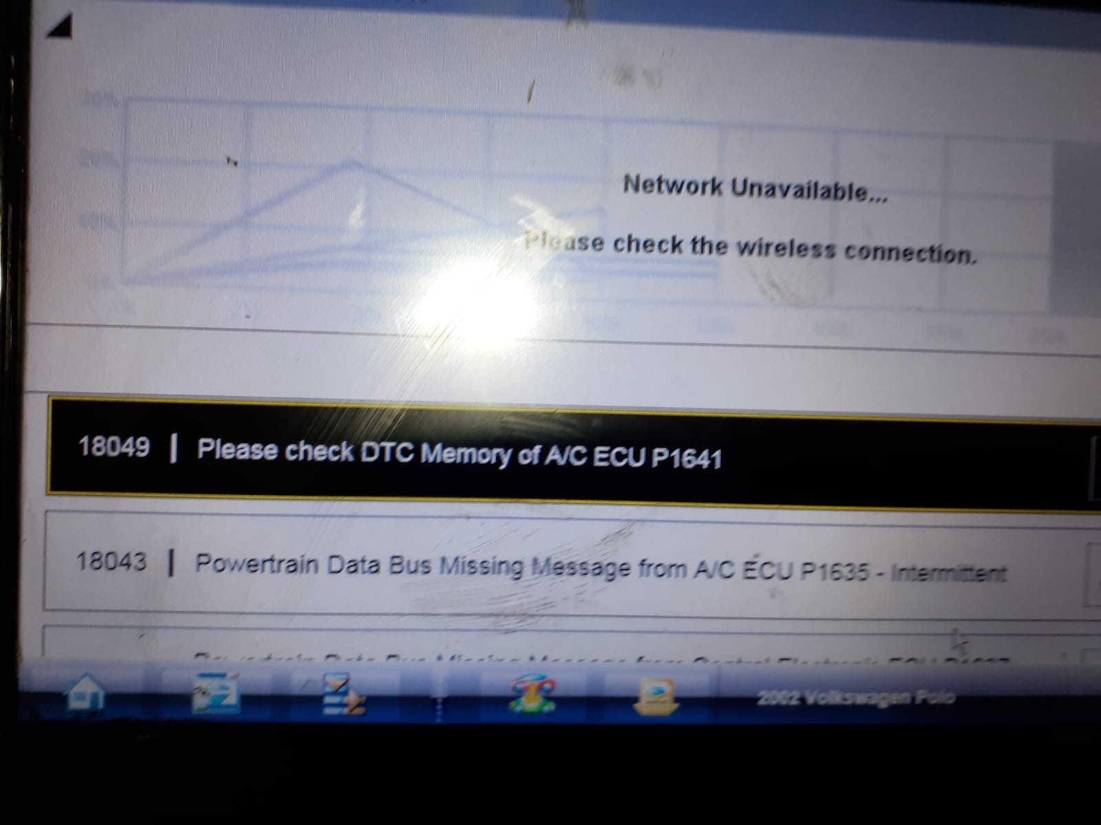

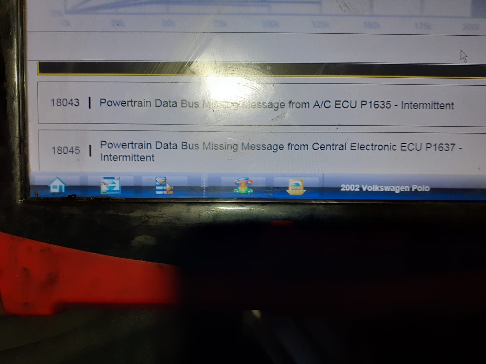

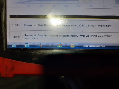

I took my car to a different mechanic for a second opinion and asked him to test the ABS pump/brakes. The mechanic drove my car and tested the ABS pump/brakes. He told me that there wasn't an ABS fault with my car. He then connected his diagnostic machine tool to my car and identified the following faults.
High pressure sensor -G65- Signal too low | I was told that this was the reason the engine management light was on. I've replaced the AC pressure valve (£50 labour + £65 part from TPS) but the engine management remains on.
Now there are three separate errors:
18049 | Please check DTC Memory of A/C ECU P1641
18043 | Powertrain Data Bus Missing Message from A/C ECU P1635 - Intermittent
18045 | Powertrain Data Bus Missing Message from Central Electronic ECU P1637

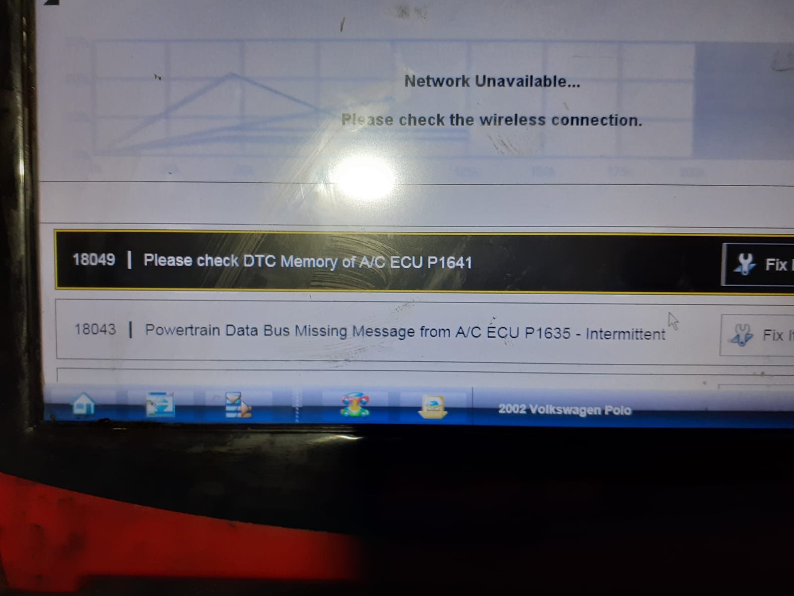

I've attached pictures of the three errors
18049 Please check DTC Memory of A/C ECU P1641
18045 - Powertrain Data Bus Missing Message from Central Electronic ECU P1637
18043 Powertrain Data Bus Missing Message from A/C ECU P1635 - Intermittent

Sounds like either an A/C issue or fuse issue
