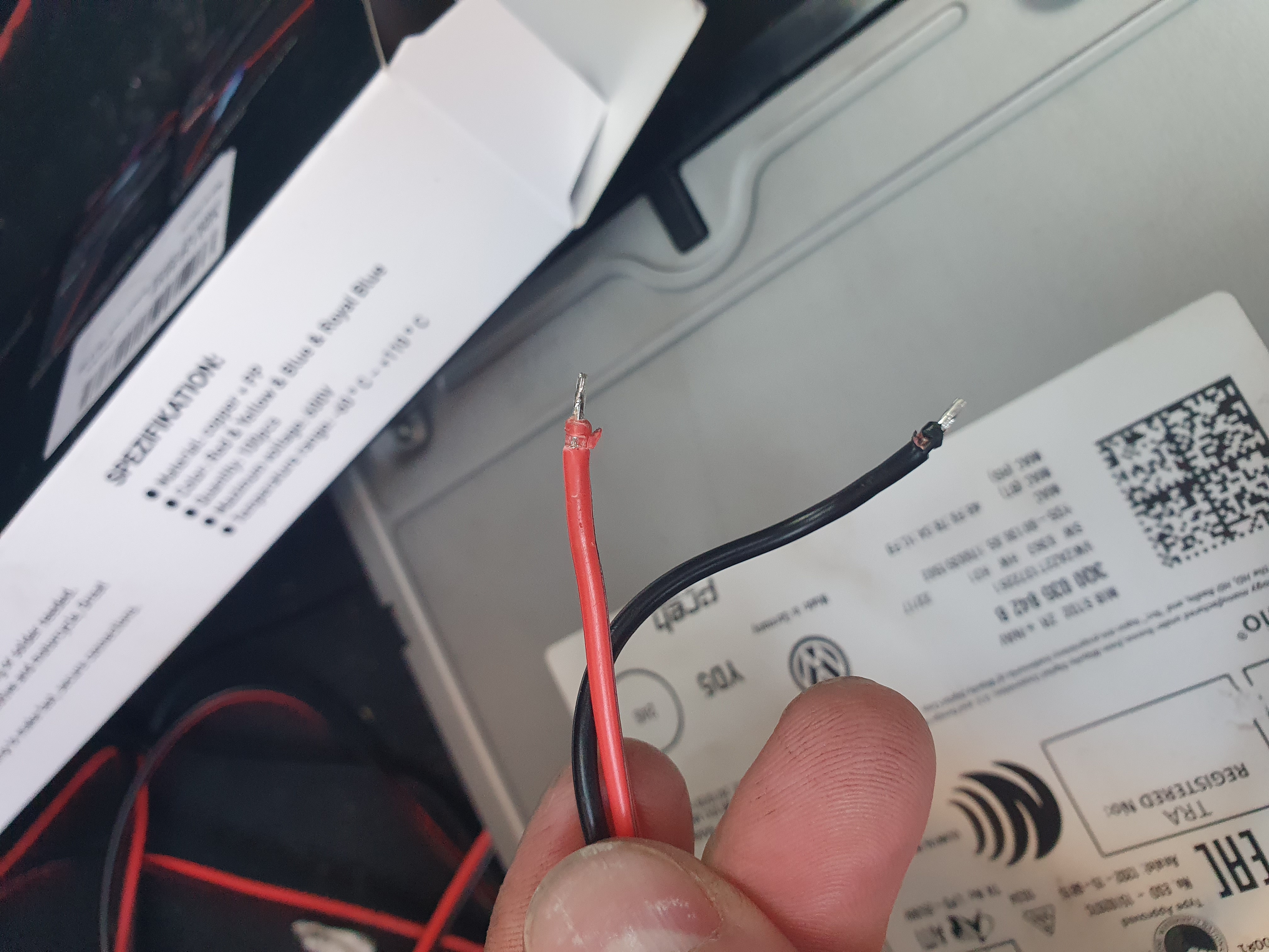

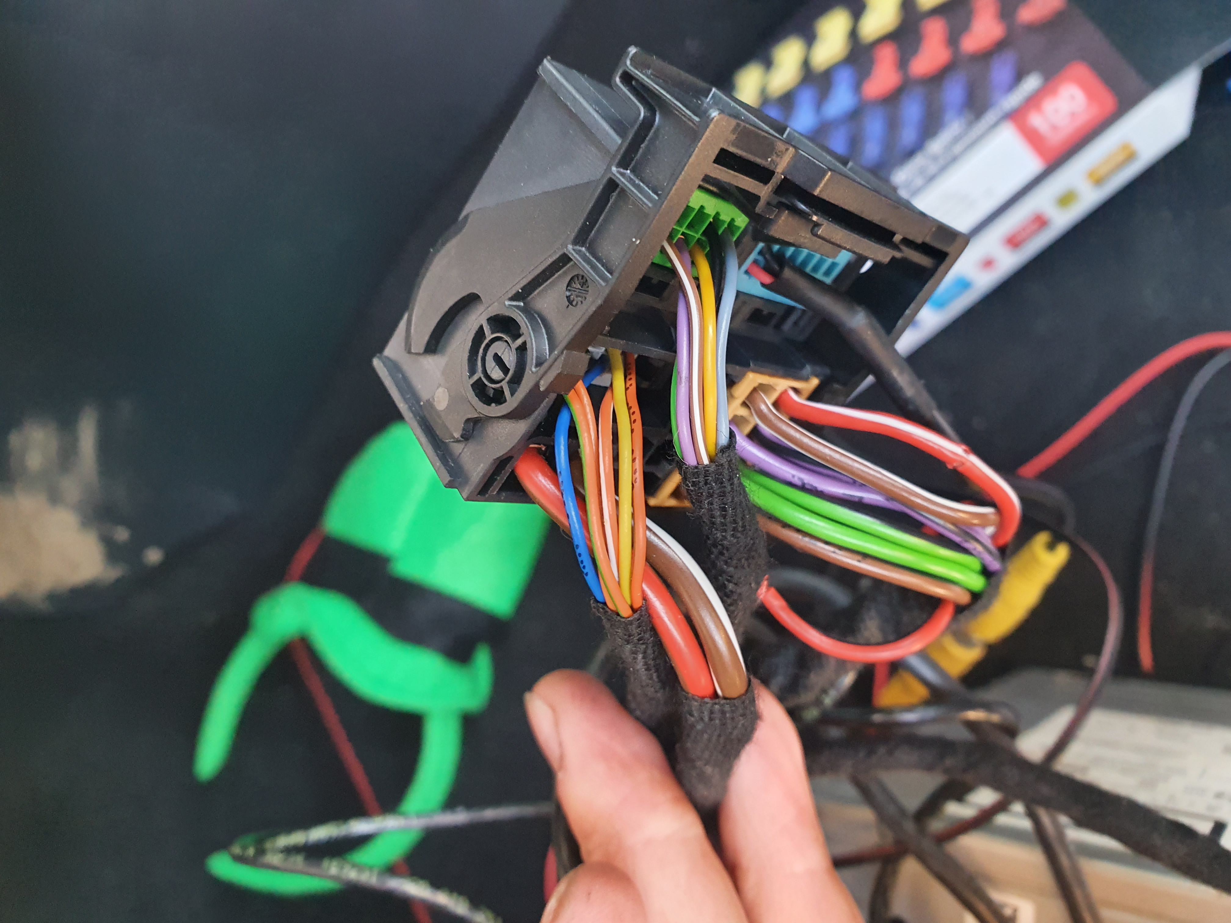

struggling to figure out the wiring for my reverse camera. ive got it all wired through the car but im stuck on these final wires
i have a MIBII unit. my instructions say connect to pos and neg from dvd lines
MIBII doesnt have dvd lines??

Use T12/6 and T12/12 of the blue connector of the quadlock. I can't tell you what's the positive and negative though.

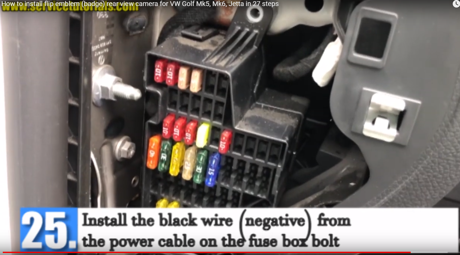

ive found this video. looks like the exact same kit ive got. do you reckon this would be the easier way to connect it
https://www.youtube.com/watch?v=pnpN7ZUtryk

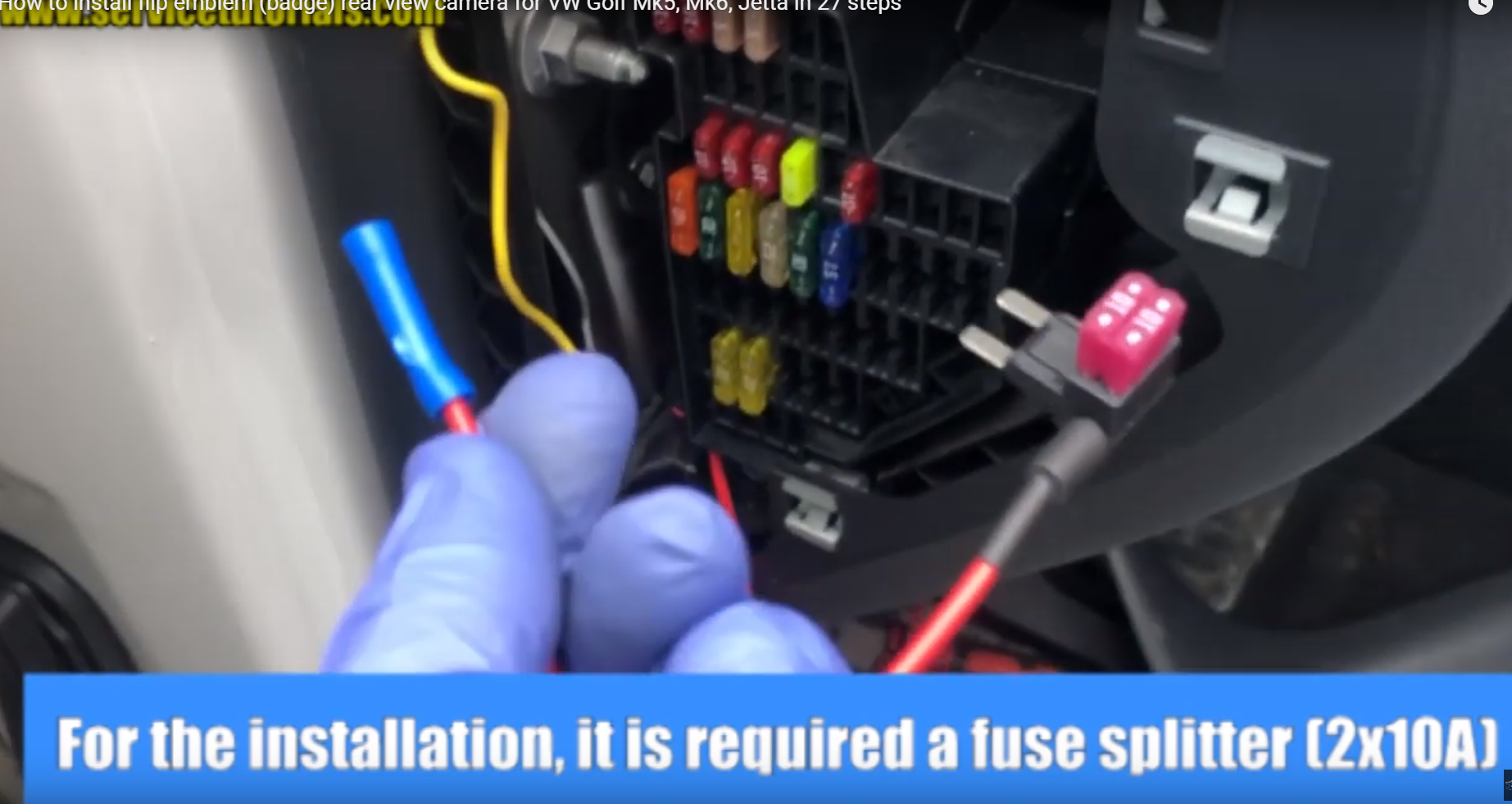

iichel wrote: Thu Mar 26, 2020 2:04 pm Could you give me a tl;dr? I don't really feel like watching a 17 minute video ;)
red into fuse splitter
black into ground?
Posts: 6687
Re: Reverse camera
Ah yes, my mistake.
Connect the black to the thick brown/white wire (GND)
Connect the red to the thick red wire.

+ wire plugged into a constant power fuse enables to boot to be opened without keys in the ignition
need to get a connector to attach the - wire to a grounding point somewhere
halfway there kinda

just needed to ground the black cable to a bolt behind the dash cover next to the drivers side door
