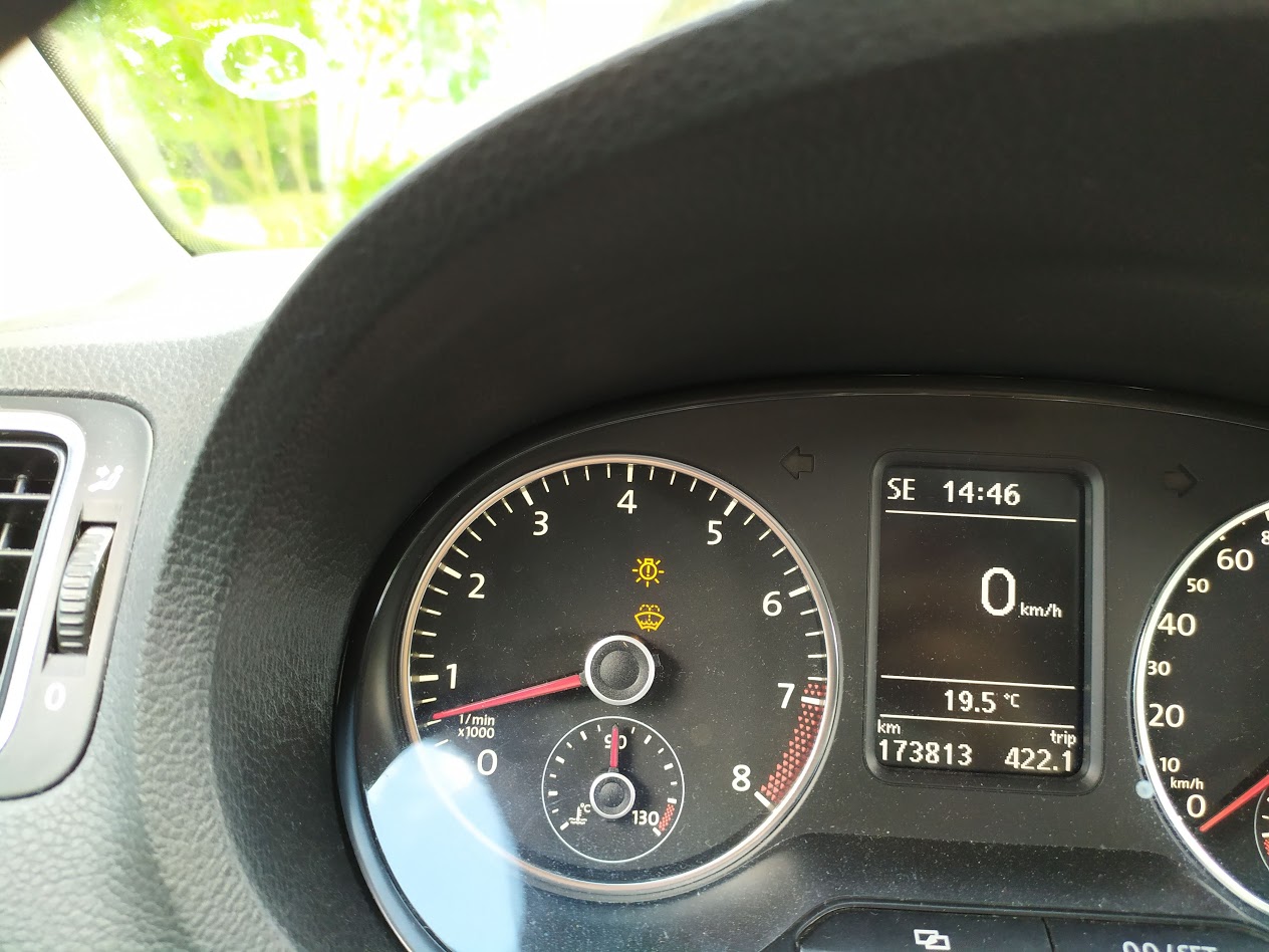

I did the installation according to Ciclo instructions :D In 03 ABS I can not calibrate the steering wheel sensor in the basic settings an error appears.
after selection
Bit 21-2.7
Bit 12-6
Bulb failure warning is also active on the instrument clusters.It may not work with ABS without ESP, or I have too old cable. :roll:

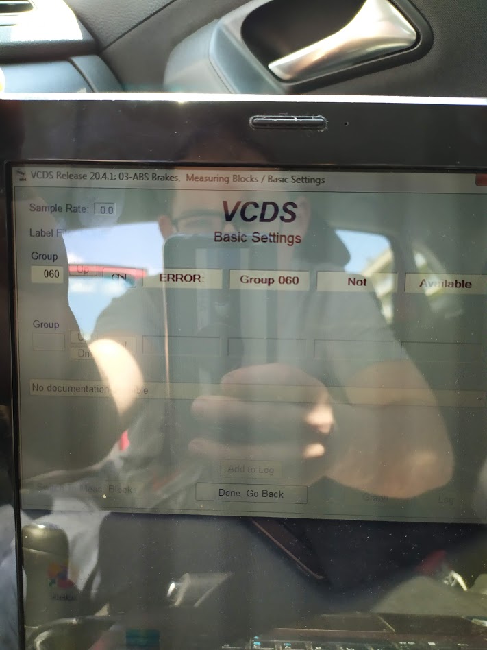

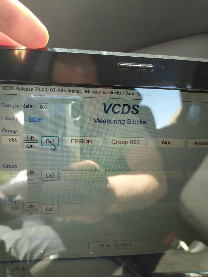

Hi iichel :D , I bought OEM VCDS,There is a very big difference between OEM and clone :D :D now I can see 04 control tables in module 04.
In 04 basic settings, I cannot calibrate the sensor because you must have an access code.
Whereas 03 ABS
basic settings in group 060 I write that it is not available
In the evening I will try to do it
"[Select]
[03 - ABS Brakes]
[Security Access - 16]
Enter 40168
[Do It!]
Turn steering wheel full lock to lock then center out so front wheels are straight ahead, steering wheel is level.
[Basic Settings - 04]
[IDE02284-ENG98502] Steering angle sensor: carry out zero calibration
[Go!]
I believe you should get a message of "Finished Correctly".
[Stop]
[Done, Go Back]"
thank you for help :D

The cornering lights do not come on.In position 03 abs the g85 sensor is not visible.so it probably won't work for me :roll:
after selection
Bit 21-2.7
Bit 12-6
Bulb failure warning is also active on the IC.

dcgumis wrote: Wed May 20, 2020 2:54 pm
They will work for you when the SCLs wiring is installed correctly. You can be absolutely sure. :wink: :lol:
I wonder if you installed the wiring for automatic lights. :?: :?: :?:
According to iichel's instructions for installing the SCLs wiring, he is referring to the T17 connector of the old light switch, and it is not correct with the automatic lights wiring.
On the other hand, I notice that you do not want to have the automatic lights activated in the BCM coding. :?: :shock:
Note:
You cannot make any kind of correction, modification, calibration, basic setting or adaptation of your new G85 retrofitted sensor in YOUR ABS unit ---> WITHOUT ESP system .. no problem for this reason. Your ABS unit is not involved in the operation of SCLs at all. (G85 and BCM only)
However, you can check with VCDS if the steering wheel angles (steering column) reach the BCM at the advanced values ​​(or meas values). If the angle values ​​change when you move the steering wheel, the installation of your new G85 sensor ring is correct. Which is correct according to your last Autoscan.
Good to know that the TinyQ parameterization worked correctly for your AFS unit (6R Europe).👍
