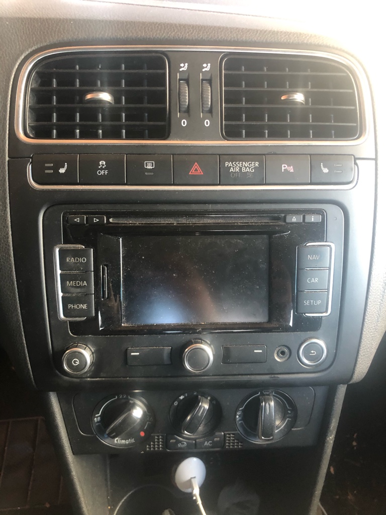

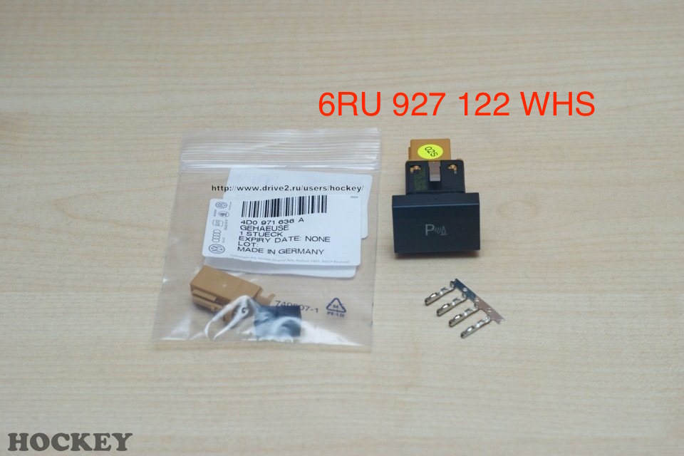

Is this button for the 6R , because the 6C button seems to be smaller
Posts: 6687
Re: Front PDC
Jim78 wrote: Sun May 17, 2020 9:36 pm Is this button for the 6R , because the 6C button seems to be smaller
Yes it is. The 6C button is square, more or less. This one is rectangular

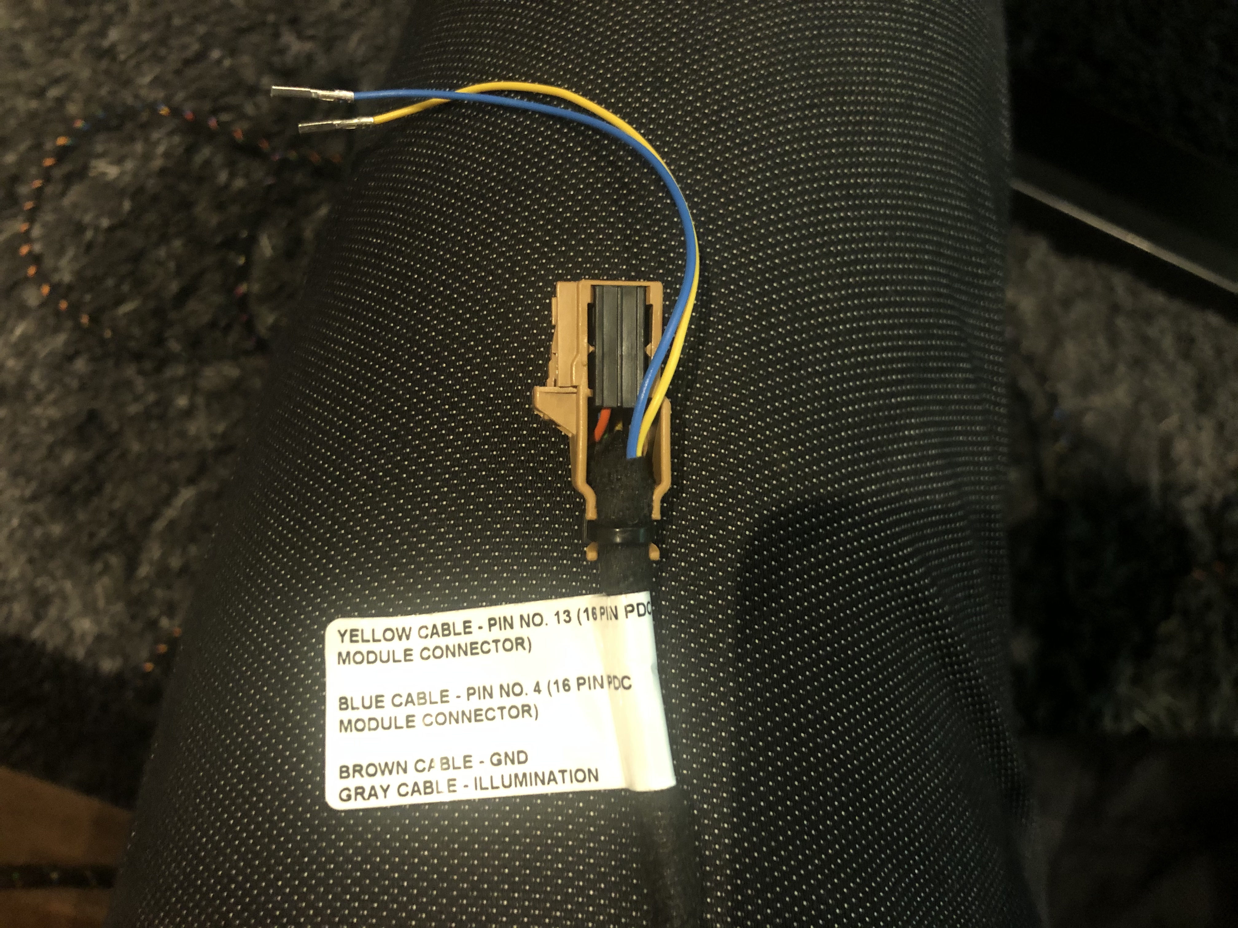

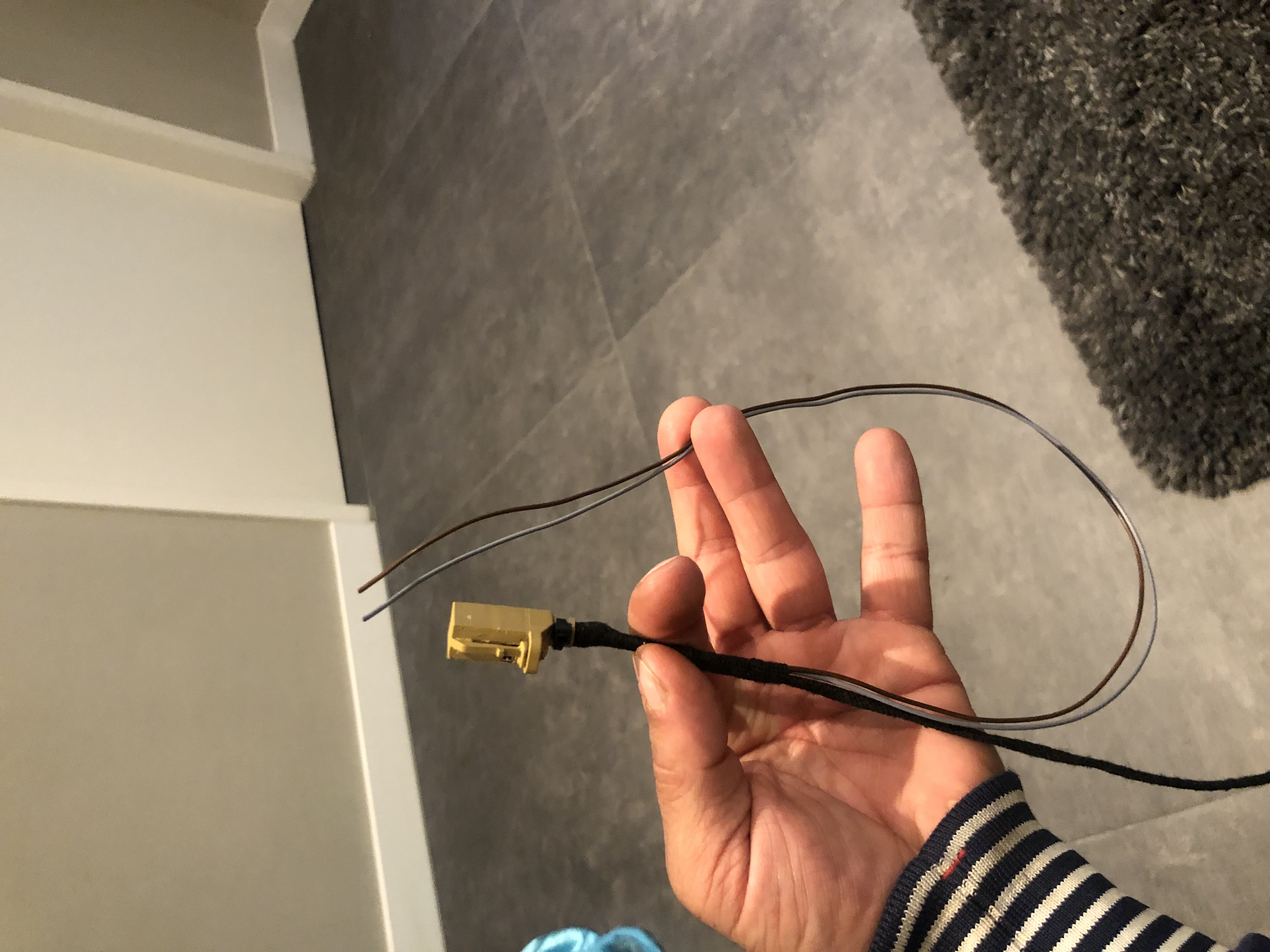

Thanx , I also got the same module.
Some last quastions
The button that you use will it connect to my wire with nr 4D0971636A.
This same wire has two wires that come out of this connector, the grey and brown. On the sticker it says brown to the ground. That is no problem to find it. But the grey it says illumination ( verlichting), but were is the best place to connect this?
Brown and grey cable coming from connector

Any of the other buttons next to it

Ok thnx, then this side.
The blue and yellow cable, how do I need to read this. It says both pin16 pdc
Posts: 6078
Re: Front PDC
No, it says that these wires go to pin 4 and pin 13 on a connector that has 16 pins and it plugs into the PDC.
Posts: 6687
Re: Front PDC
I'd say you'll have to plug it into the existing connector of your 4K system, like RUM4MO says.

Hi guys
Today just received the last part, the park switch.
So tomorrow morning I wil start this upgrade.
I did find this topic and it shows that this guy used a other way to get wiring from inside car to engine space to front bumper
https://www.motor-talk.de/forum/retrofi ... tml?page=0
Does someone else has a other idea to get the wiring from inside to front bumper sensors.
Gr Jim
Verzonden vanaf mijn iPhone met Tapatalk

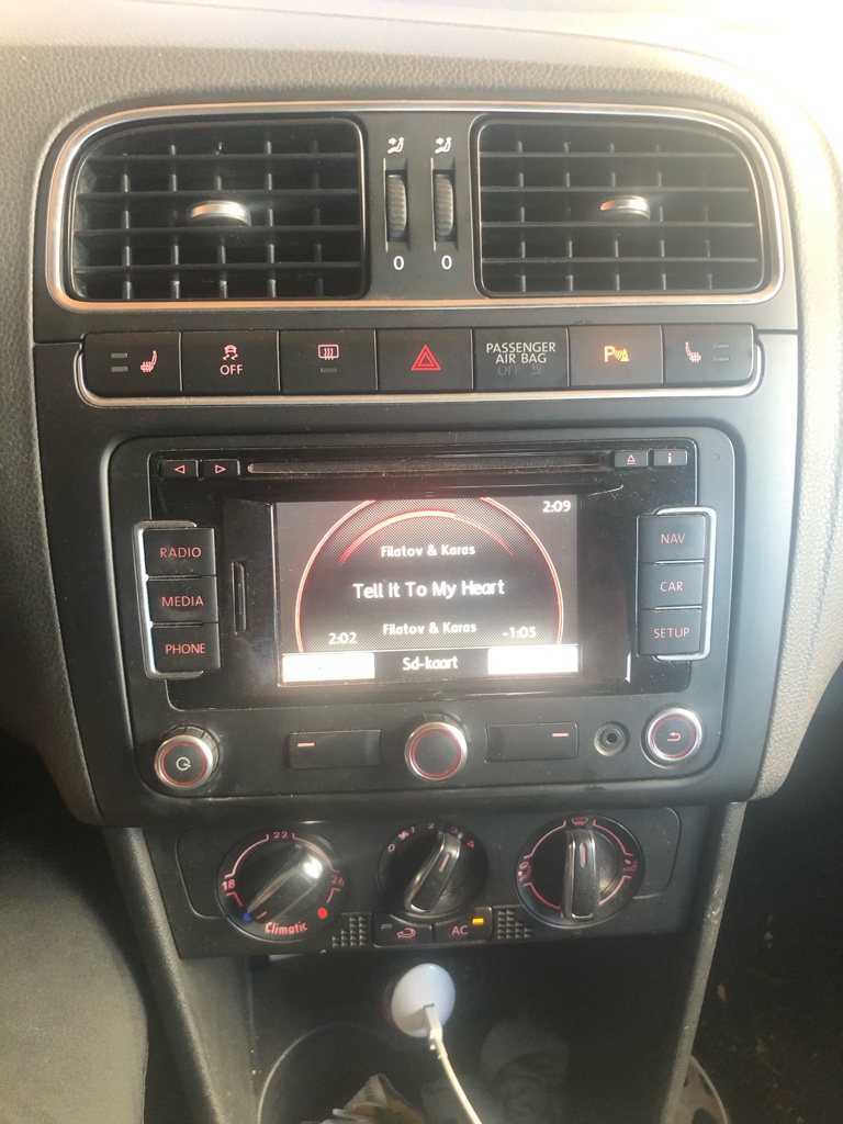

Post by Jim78 »
Today installed but not working perfect
The illumination light suddenly die not go out.
The peeps and sensors working but no OPS Wen I put gear in R. Only if I put it in Neuteal after it was in the R
Posts: 6687
Re: Front PDC
autoscan?
