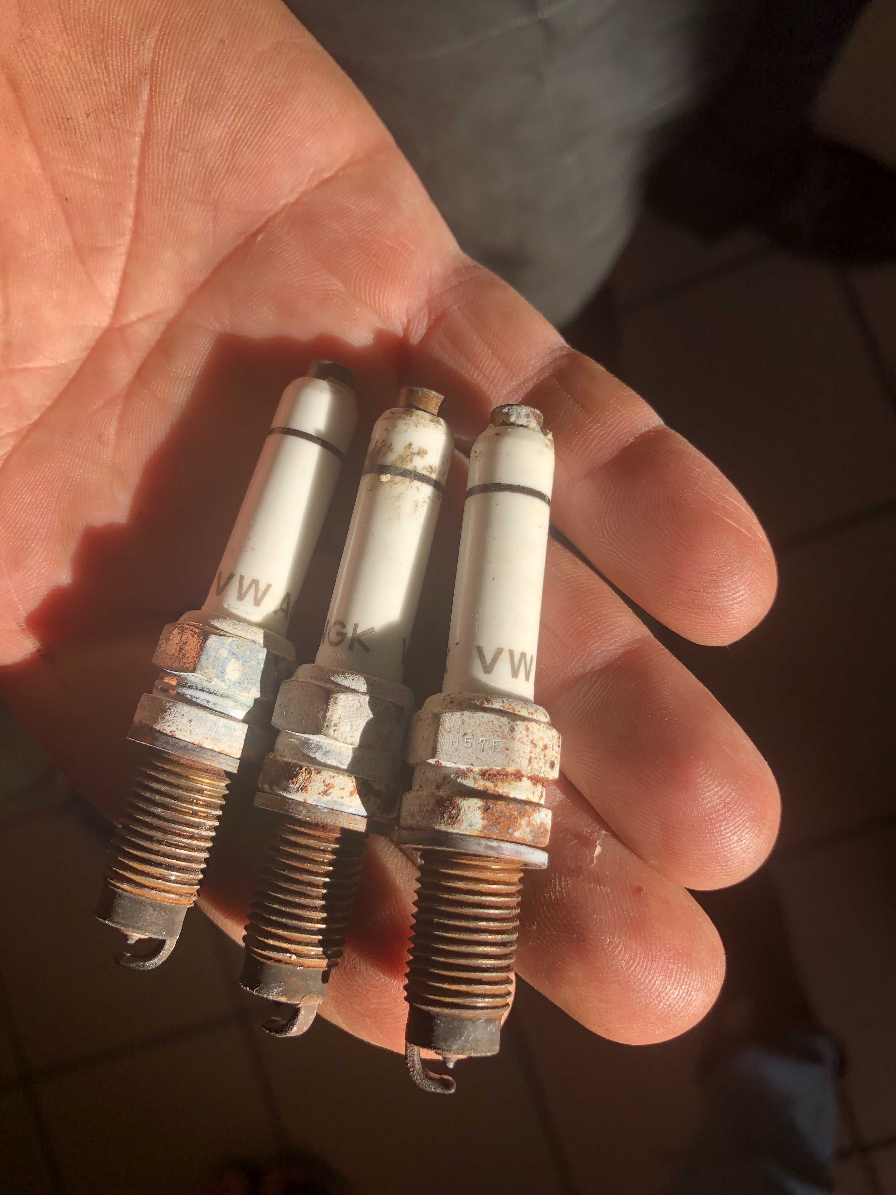

I've bought the car used and the spark plugs were the original ones (I've got a miss fire at 102.000km after 10.000km of ownership - the previous owner never changed them or other parts 🤬- ) so ngk done a really good quality product in my opinion and I went for them
P.S. I've attached a photo, 3 out of 4 spark plugs were in this really poor condition...
