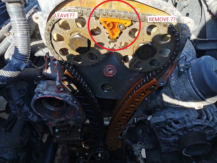

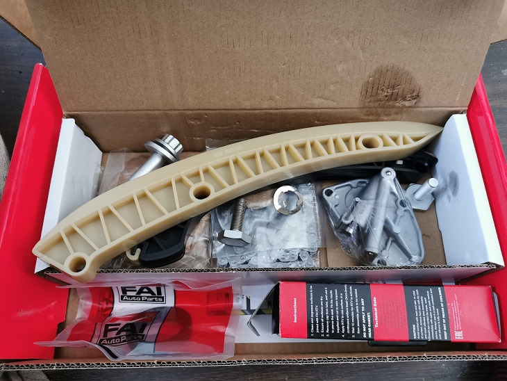

Location: United Kingdom
Re: 2003 modified timing chain
Post by simlock »
I agree with you on that, i think many people find themselves in certain scenarios with their cars, and all do what you have said, not everybody can afford to pay for this job to be, and for it to an economical repair, i think we are in that scenario, our car stands us in £!250, and have had not one minute of use out of it, so to us, we just want to reapir it, then flog it, we have just got the FAI kit through today, it looks cheap tat to be honest, and was £59 off ebay from JDmotorsport, we checked their feedback, and google reviews, people happy with their products, to plumbed for that, just wondering if when we fit this kit, dfo we need to leave the top chain guide in place???as we have saw many videos without this top guide, and only found one, with it, with a new modified kit... but one manufacture, say to remove this??? ahy ideas?? thanks
