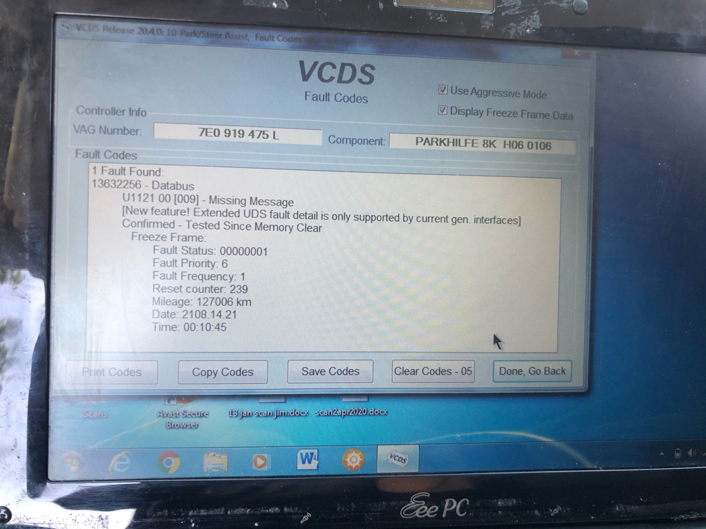

Front PDC
Post by Jim78 »
Saturday,30,May,2020,04:35:14:48826

Posts: 6693
Re: Front PDC
Your instrument cluster is not happy and I think that's what causing the pdc to be unhappy
Jim78
Posts: 20
Joined: Sun May 17, 2020 1:02 pm
Drives: Polo 6R
Location: Holland
Re: Front PDC
Post by Jim78 »
No because I already had pdc and rear ops and always worked perfect.
Could it be wrong pinned?
Because it works but not on the correct way.
Why it shows after i but it in neutral ?
And why does thin light of the button still stays on after closing the car?
Verzonden vanaf mijn iPhone met Tapatalk
Posts: 6089
Re: Front PDC
Maybe it is obvious, but it looks like by changing some modules, you have fitted modules from a VW Group car that is not covered by your current version of VCDS, so you would need to update to VCDS HEX-V2 to get back to full module coverage from VCDS - but that will not solve your present problem I suppose, I'm only pointing this out to you in case you do not understand it.
Jim78
Posts: 20
Drives: Polo 6R
Location: Holland
Re: Front PDC
Post by Jim78 »
Ok good news. Finally got everything working. Patience is a good lesson.
First off all connecting the park switch I used the esp button pin 3 for illumination and pin 6 for ground. And it work correct now
Then I checked coding again. I forgot to turnoff rear camera and trailer hitch, because I do not have these.
And finally everything is working.
