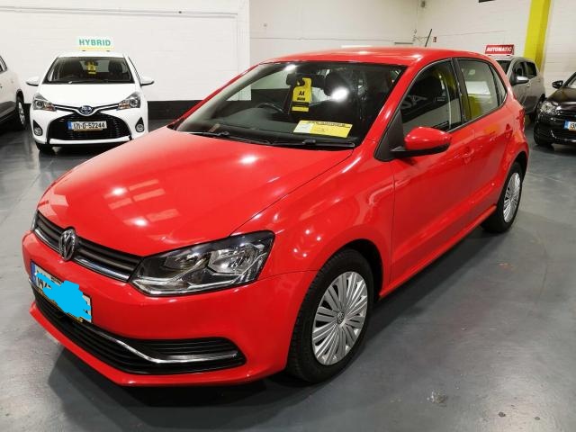

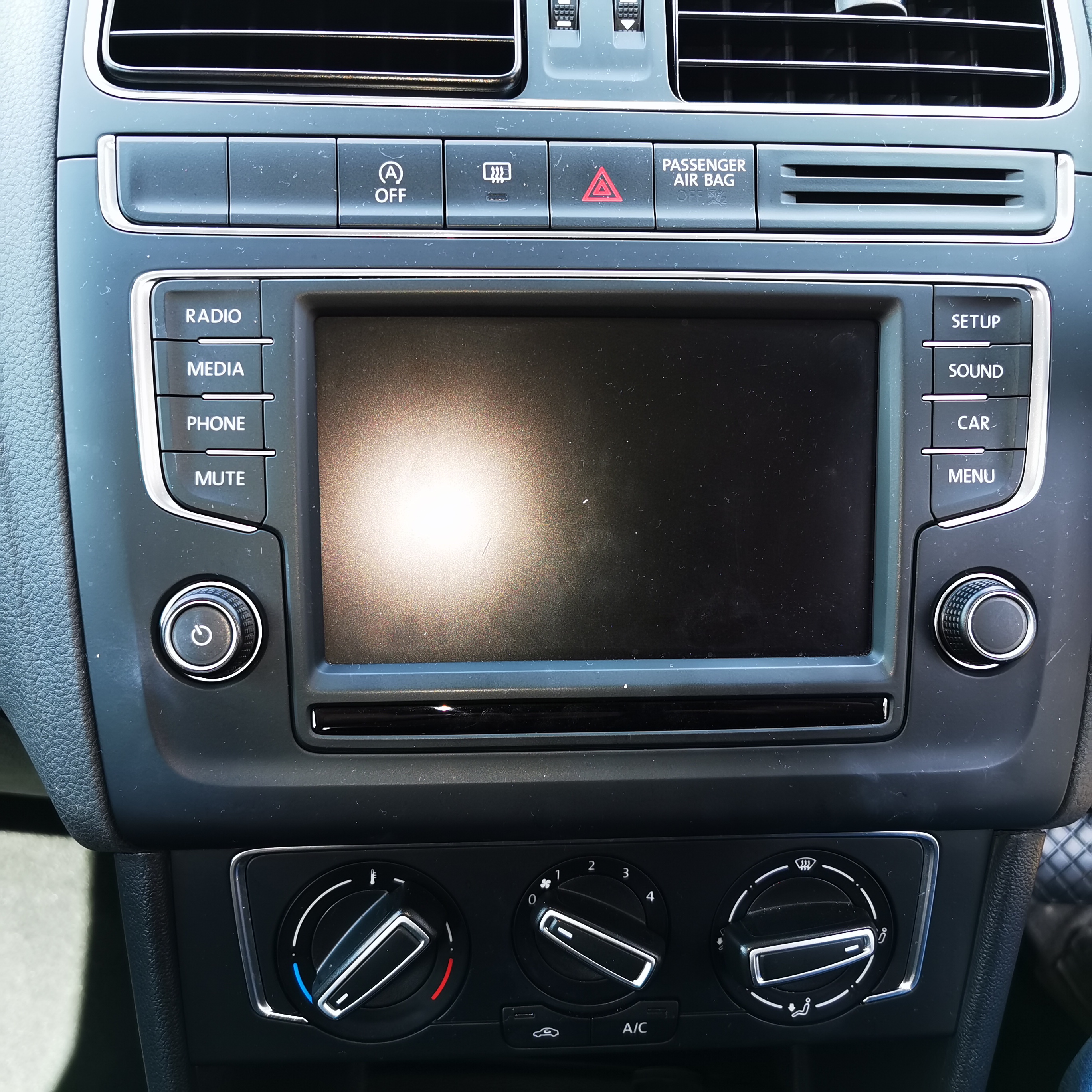

Hi folks..
Need to upgrade the head unit in my daughters 2014 vw polo TSI... I've sent pictures of my original head unit to a seller on aliexpress but the seller wrote back saying he thinks mine is a 6R and I need a different one China only does 6C polos, I'm not sure which variant I have, but I can provide part of my vin number which I think could indicate its a 6R but I need to be sure, can anybody help? I've posted on the ICE section with a similar question but so far I've not had any reply... Here is the body description/type.
TSI DBA 6RCJZ 5DR A... any help?
Cheers.
Jim

Could you please post some pictures of the car?

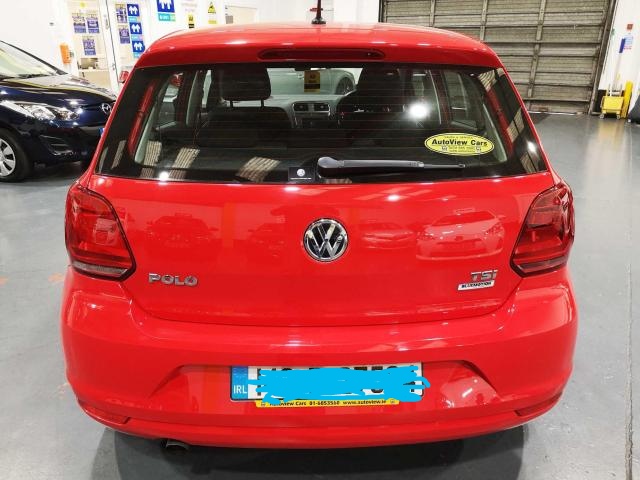

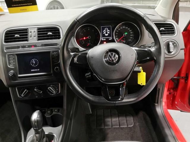

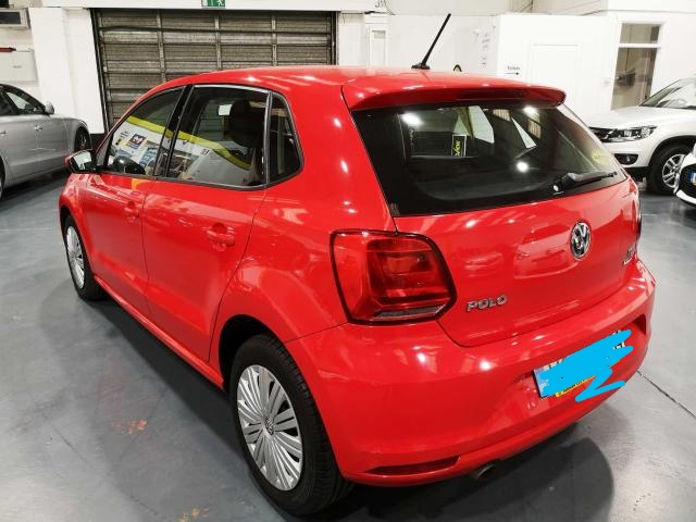

Just took these photos guys.. Is this any help in identifying which variant?
Posts: 6693
Re: 6C or 6R..I'm not sure
This is a polo 6c (the newer model)

Just one more question regarding picking the right head unit and installing it.. It seems the ones for the 6C are MQB rcd330 units which have an extra component (facia piece) if this is right do I have to use the fascia that comes with it or can I use the original current one?
Cheers again.

i'm pretty sure the rcd330 does not work with the 6c.
the 6c has two parts (the main unit in the glovebox and just the screen in the dash).
i've been wanting to change mine but so much is controlled through it you have to be 100% that it will all work after.
