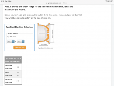

- Posts: 3544
Re: Decent alloys
Forum member 2226 has beaten me to it , but I’ll post anyway. They have the correct PCD (bolt pattern) of 5x100 for the Polo. If the seller hasn’t given details of the offset or centre bore size, I’d ask them for that information, along with confirmation of no cracks, buckles, repairs.
From a quick Google search, I think the spec of BBS RZ 409’s is as per below, but get the seller to confirm the spec.
Width; 6.5J
Diameter; 15”
PCD; 5x100
Offset; ET43
Centre Bore 57.1
If your existing wheels are 6Jx15” ET38, and the spec of the BBS wheels is as above, then they should fit. The difference between your existing set up and the set up with the BBS RZ alloys would be as per the screen shot below (assumes you’d be using your existing 185/60 R15 tyres). A 185 width tyre on a 6.5J wheel is probably the minimum width tyre for a wheel of that size - see second screen shot below;
