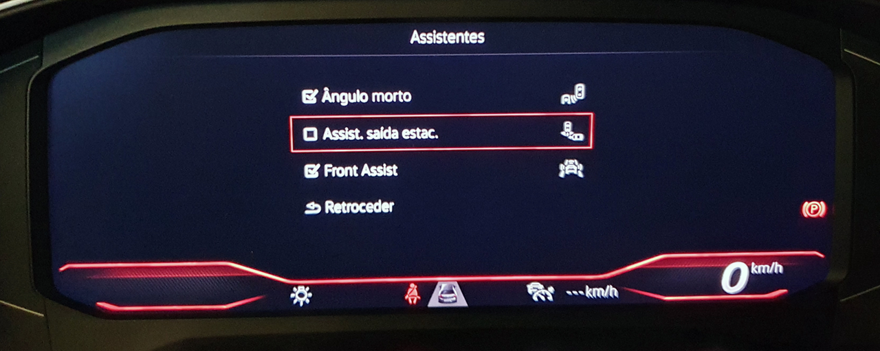

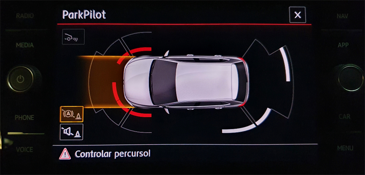

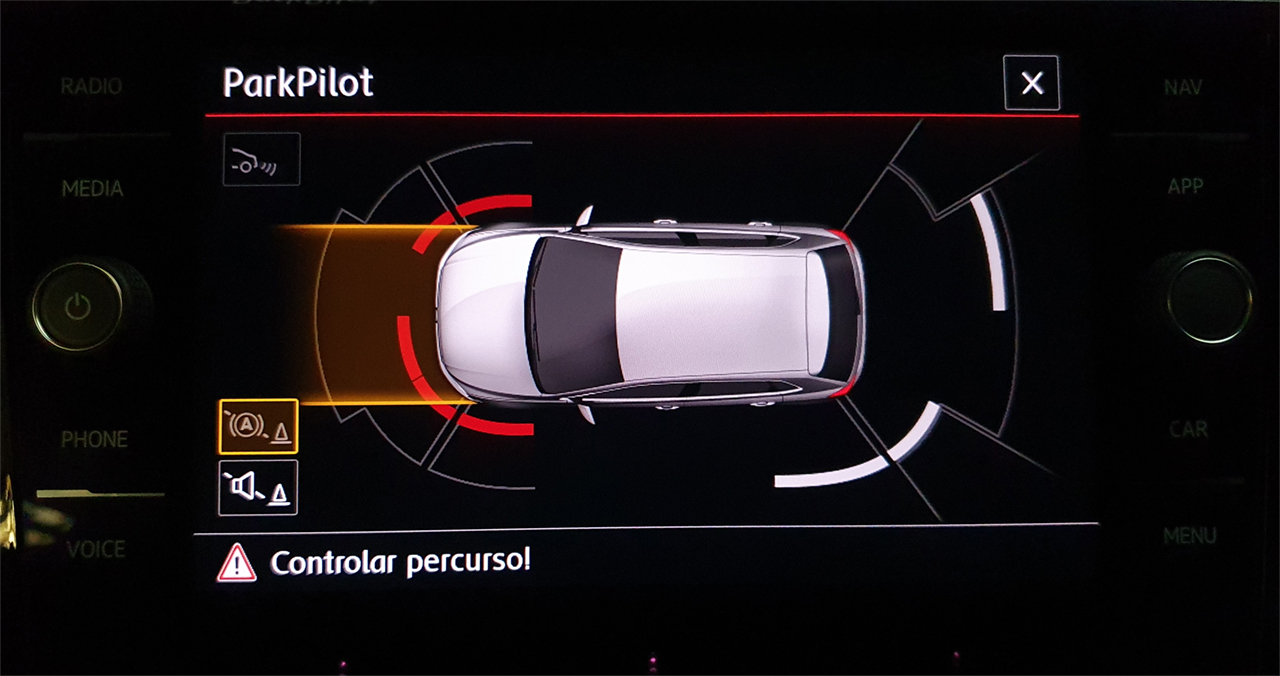

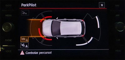

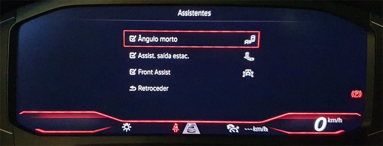

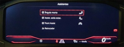

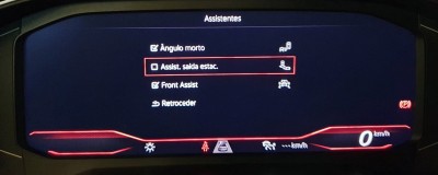

After finding out if there was a possibility to turn off this function while doing the maneuver I found this...
I don't know if anyone had noticed but in the assistance menu we can turn off some of the functions.
No more problems with reversing maneuvers, not the perfect solution but no more scares and sudden braking.:D

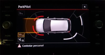

I noticed that your car have more sensors that mine... Mine don't have the sensors near the laterals, front and back.
Do you have park assist?
Dark_cze
Posts: 447
Drives: AW GTI with MT
Location: Czech republic
Re: Front Assist - 'Risk of Collision'
Post by Dark_cze »
Dazeredo wrote: Sun Jun 21, 2020 3:42 pm I noticed that your car have more sensors that mine... Mine don't have the sensors near the laterals, front and back.
Iam sure he does. PA comes with 4 extra sensors and Polo shows them while parking.
