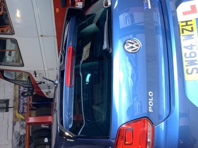

Got my rear spoiler on and didn’t affect my insurance, checked before fitting,
So it’s now got the rear wing on
