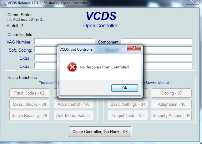

Today I retrofitted my new Composition Media MIB2 PQ.
Looks like my car doesn't like It.
It's not impossible to code Radio with 56-Radio, I think It's now in 5F-Information Electr.
My idea is now to untick Radio in Gateway list and tick 5F-Information Electr.
The major issue is volume which randomly works. I think it can be fixed with proper coding.
I'll try tomorrow. Hope no need to add a gateway.

After many troubles radio works fine.
Still got "open circuit error" for the Antenna, probably because I'm using an adaptor female twin -> male single (don't have diversity sound system).
I ordered a new adaptor so I can see If something change.
patil
- Posts: 576
Re: Franciswat's Polo 6R 1.6 Bifuel
Hello franciswat!
For correct operation of your composition media:
You should disable(deselect) address 56 in gateway installation list and enable (select) address 5F and address 77.
