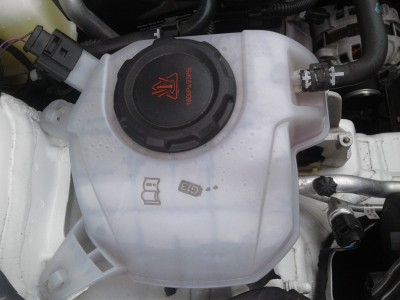

This thread promoted me to check the levels of the engine coolant in my car. I'm pretty sure it needs topping up (looks to be below the minimum from the picture).
If it does need topping up, can I buy this online anywhere or would I have to go into a VW dealership?

I've never ever had this sort of issue with any cars that I have bought new over my 40 years of buying mainly new cars, but, from being a member on the Skoda motoring forum, and SEAT motoring - this sort of thing is far from being unusual, and even with the 1.2TSI 16V petrol engines, which might seem a bit strange as few if any 6C Polo owners with that engine reported this issue - maybe it differs from factory to factory although Skoda factories built all the 1.2TSI 16V petrol engines.
Just "one of these things" - it looks like your coolant level is just down to the join in the reservoir so is mid way between Min and Max, so maybe okay, I've always aimed to have the "cold" coolant level on or just above that point.
Now, most car engine's cooling systems have maybe 3 zones to optimise heating up etc, so maybe the standard filling rigs are not able to ensure that no air is trapped.

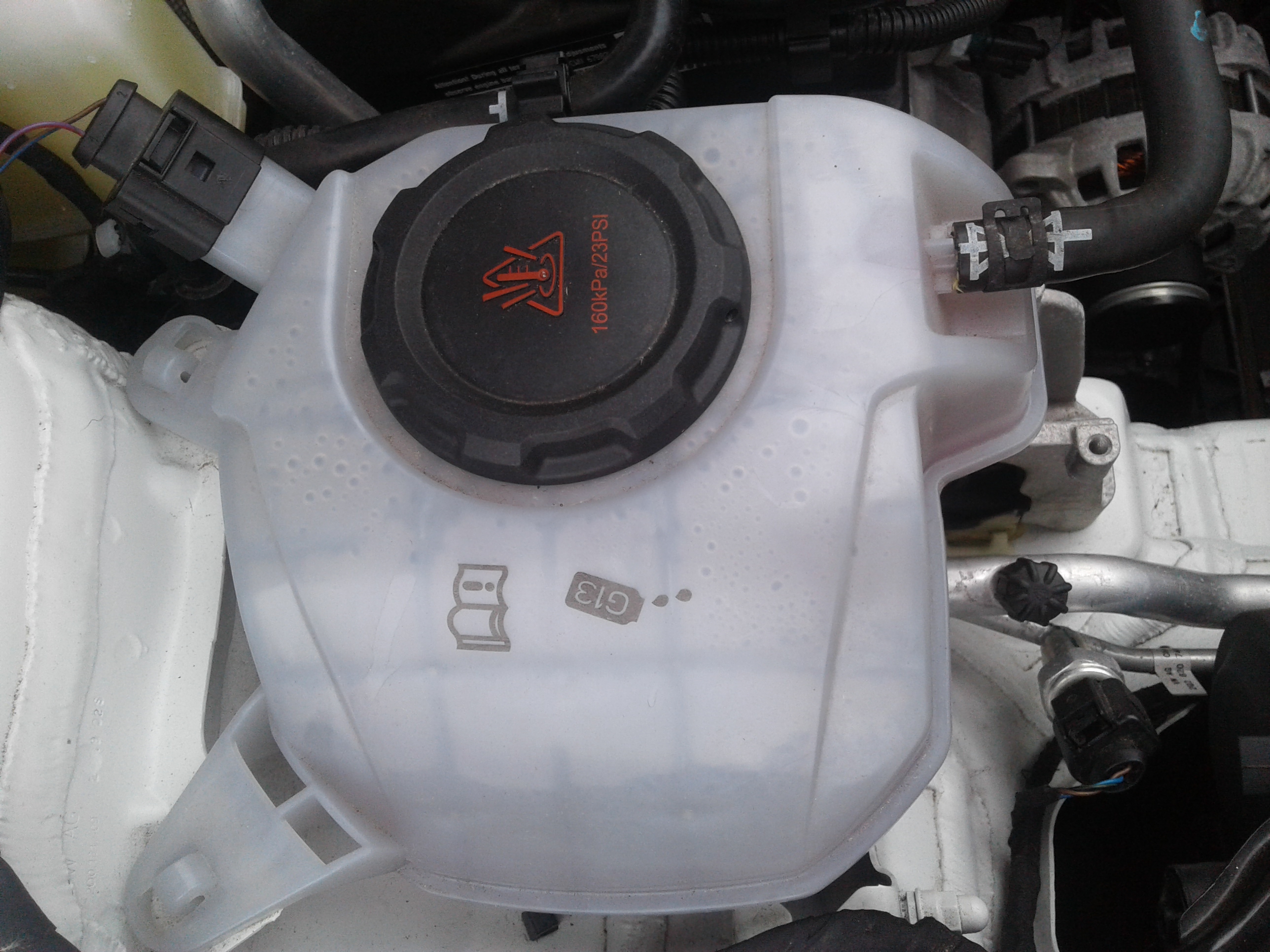

I read the owner's manual and it says my Polo should come with G12 evo coolant from the factory, as shown below:

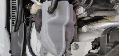

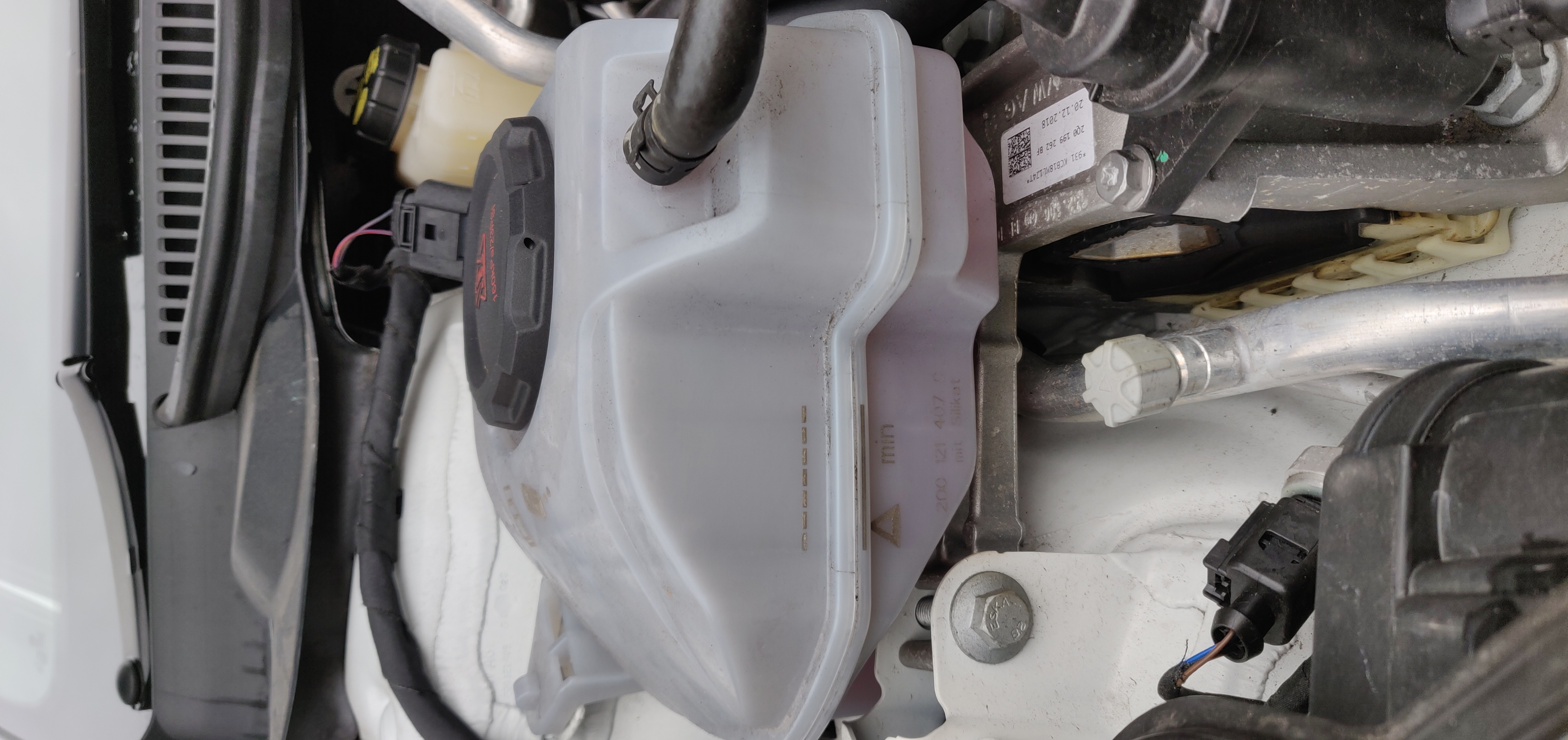

But on the expansion tank of my car, it says G13:
I am a bit confuse on which coolant is filled into my car.
Can someone also check their owner's manual and expansion tank label as well, and tell me if it says "G13" or "G12 evo"?

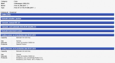

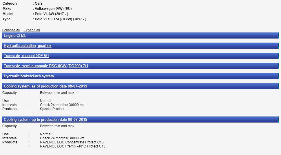

According to the Ravenol website VW Polo factory changed over from G13 to some other coolant on the 08-July-2019, as shown below:
(My Polo is assembled on the 24-AUG-2019 in South Africa.)

My tank says G13 as well. Took delivery of car in May 2019.
